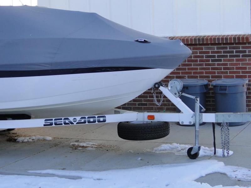

Curious.. Where does the information come from on the lower stop being not safe in a crash? I cant really see that myself and the attached picture is of a Seadoo inboard jet boat that is just slightly lighter than the 26S and it actually has a lower bumper than either stinkbug or what Ive got and the boat has a lot more angle on the bow. The boat must be flying over the tow truck every time they come to stop..
What I have is close to stinkbug, no more mac bump hassle.
Sumner, your pull strap angle looks a little extreme, any issue from that? Did you ever get to try out on the water that moving bumper mod?

Hi Walt, I think most of the members have straps for the winch, and they get UV damage. (I have an old t shirt covering mine, and slack when not towing.)
I think we all have a safety chain which doesn't have uv problems. (for the boat sliding back)
my suggestion was a 2nd safety chain down low to keep the boat on the V in a panic stop. -from going forward.
I'm sure there are youtube videos of panic stops and cars on trailers, or boats on trailers launching over the tow vehicle.
maybe the strap will hold... but I like a chain for that scenario.

Aha.. yes a safety chain would be a good idea.. I thought it has something to do with a lower stop:redface:
