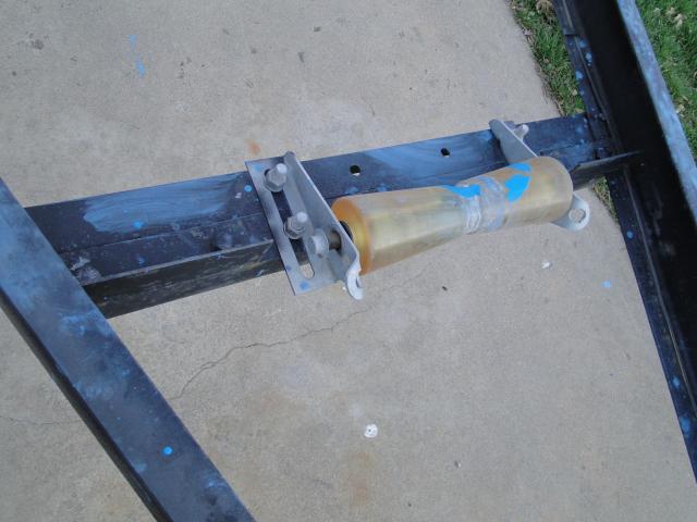

When we would retrieve our S it would pull right up to the "V" snubber block on the trailer in the water. Coming out of the water it would rotate on the bunks back away from the "V" a couple inches. The anti-lock brakes on the Suburban made it hard to execute the "Mac Bump" so we usually towed it with it sitting a couple inches back. In fact we towed it 2200 miles back from Florida that way without a problem, but still I didn't like it.
It finally dawned on me that if I couldn't get the boat to the "V" block maybe I could get the "V" block to the boat so I modified....
...the trailer to do just that...
with the piece above. At the same time I made a couple other...
...mods to the front of the trailer to handle a problem that surfaced when I added the double anchor roller to the bow of the boat.
The mods are here.....

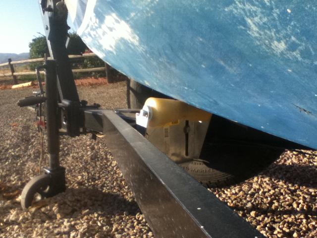

The bow roller helps to get the boat forward...
...when it is in the water and keeps the bow up out of potentially hitting the trailer. Above you can see that the boat is on the roller and up in the "V" while the stern is still in the water. Once I have the boat/trailer pulled up in the parking lot it is usually about 2-3 inches back. I think what happens is that as the trailer comes out of the water the boat settles onto the forward bunk. Then starts to rotate around it. Then as the trailer comes out further it rotates around further and down onto the back bunk or in the case of our trailer with 3 bunks now the back two bunks. The only way that I see how it does this is that it pulls the web strap tighter in the winch, letting the boat go back as it pulls slack out of the strap.
The bow roller does help, but in our case has never stopped the boat from settling back away from the "V" block. I'm always driving and have never actually watched what is going on as the trailer comes out of the water. Also I put the roller on before we ever launched for the first time. I have raised the roller just a little as was shown on that page hoping to help the whole situation with the rocking. I never wanted to really put a lot of the boats weight on the roller as the load is pretty much a point load and not spread out much. Still the hull should be quite strong there.
Without the boat in the "V" it does rock up and down when you hit bad sections of highway, like bridge approaches. It was really bad on the Interstate in Mississippi coming home. That finally did it and I decided to try this. I won't know how well it works probably for a year until we use the boat next. If I was towing a few miles I wouldn't worry about it, but when you hit a really bad section of road and see it go up and down it is unsettling,

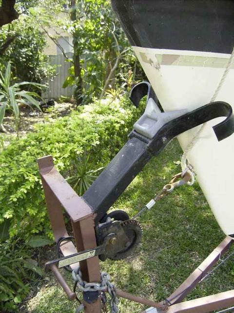

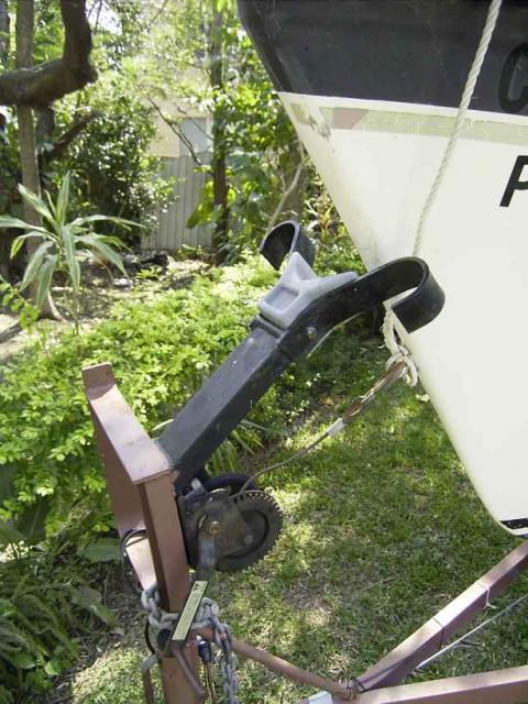

The rig at the front of my trailer really has never needed the "Mac Bump"
As the boat is in the water and the trailer is under it, the winch strap pulls the bow high onto the V-Stop...
https://picasaweb.google.com/lh/photo/LBxAd2zjWKPN0jJndXjOWQ?feat=directlink

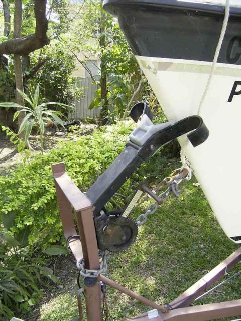

Then, once the boat is pulled out of the water…and the bow raises slightly…the winch strap is removed and run through the lower roller as well and winched tight to bring the bow back down…
https://picasaweb.google.com/lh/photo/amjlRya7lxUWkYdQXErWtw?feat=directlink
This brings the bow in contact with the V-Stop…thus eliminating the need for the bump.
I am always way over prepared so I cinch it down with a rachet strap over the pulpit and add a chain…that boat is goin’ nowhere.

I have just taken some photos of my winch/bow on the trailer. The first photo is with the bow pulled down hard (almost) agains the V-notch. The second is with the tension released off the winch cable and the bow sits back 75mm from the V-notch. The third photo shows the safety chain on and winch cable released of tension - then the bow is about 50mm off the V-notch ie. small amount of tension. I really don't like the way the tension builds up in the trailer arms when the bow is winched down tight against the V-notch - must place some bad shock loads on the trailer and the bow eye.

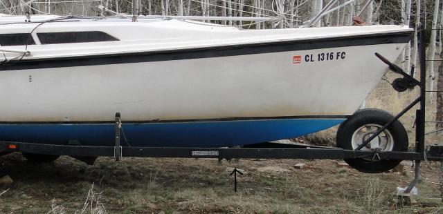

My boat is 100 miles away so dont have measurements but the picture might be useful (there is an arrow under where I think the roller is).
If I was going to do it over, Id probably try and get the roller "just a little" forward of where I have it although at this point, I dont have much issue with this - dont really have a problem that needs to be solved. I tried the bump one time but that was it.
