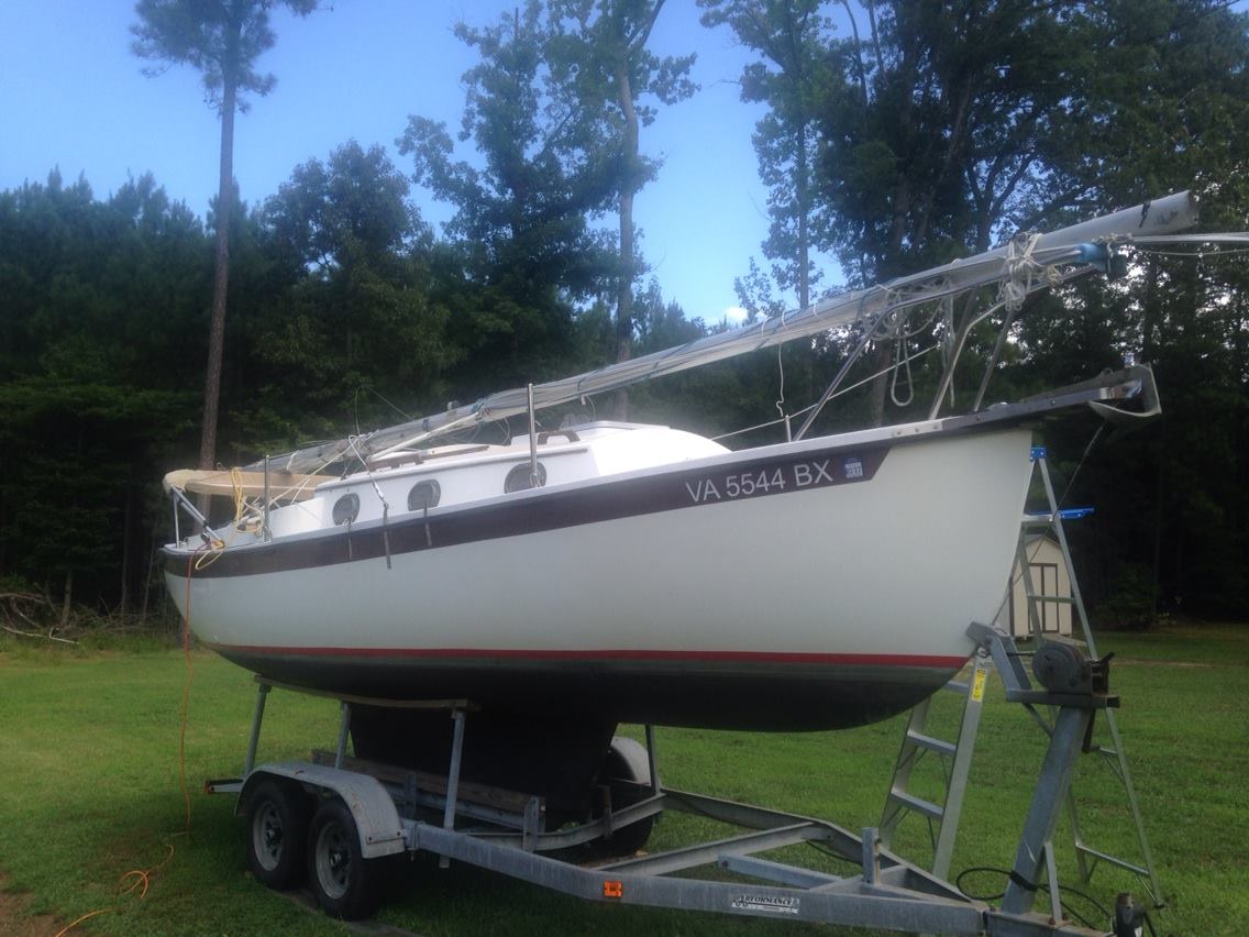

When you go up to a very large trailer sailor then you are at a thresh hold. Any bigger and you can't trailer at all but at the same time the larger ones are a pain to trailer, step the mast, etc. If you want to day sail stick to a smaller boat. If you don't mind putting it in the slip or you can find a place with mast up storage on the trailer then you can go to the Catalina 25 or so. I find that my Compac 23 is much better to slip for half of the year and put her on the trailer for the winter.
Swing keels, centerboards, etc. have extra maintenance that you have to think about. They have to be inspected well so you know what you are dealing with. Sailing along and having a cable break, or, much worse, having the centerboard pin break is very bad.
My current boat draws about 2.5. It is a shoal draft, no centerboard. I point okay for what it is but it is the compromise for a shallow draft boat that you can trailer but still not worry about dealing with a board.
Boats are all about compromise. You will end sacrificing on one thing to gain in another.
