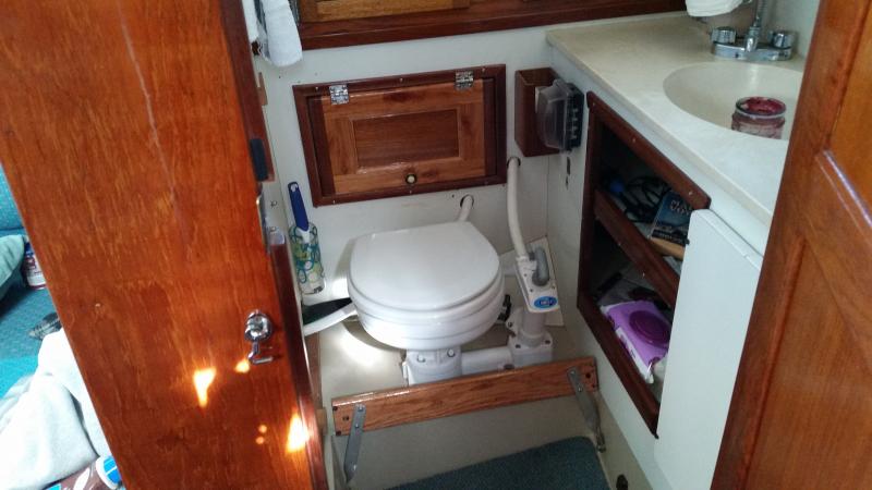

on our Cal 34-3, there was a panel screwed to the wall behind the head, covering a small hole for the access to the hose and clamps to the deck pumpout fitting and vent.
the usable space behind this panel is 30"Long, 20"High and 15"Deep....

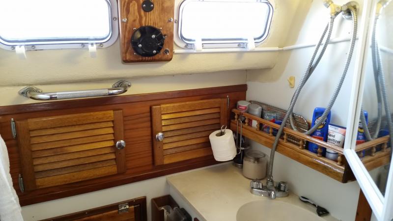

also there were swinging doors below the sink/vanity counter... this left 36-40 inches of room under the vanity counter towards the outside of the boat that could not be seen into or even easily reached in any way... the space had the shelves already installed, but just not accessable.....
as shown in the photos, you can see my remedy to the problems... I cut the access hole behind the head bigger built a door that would allow easy access and also installed a shelf.
under the sink/vanity counter I removed 1 door, and cut the opening larger, then framed it with mahogany... we now have a lot of storage in the head area....
and i also added a bathroom fan...

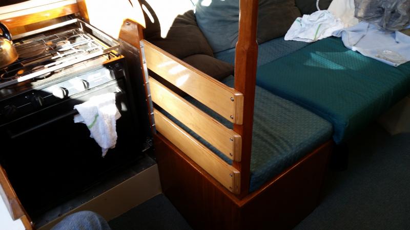

(also, I have never understood why there was no seat back between the galley and the dinette.... when setting there it becomes uncomfortable after awhile, and when the dinette is made down into a bed, the pillows keep sliding out, so i filled it in.
my plan is to install a swing up counter top for a bit more counter space when cooking and the dinette table is not available)...
