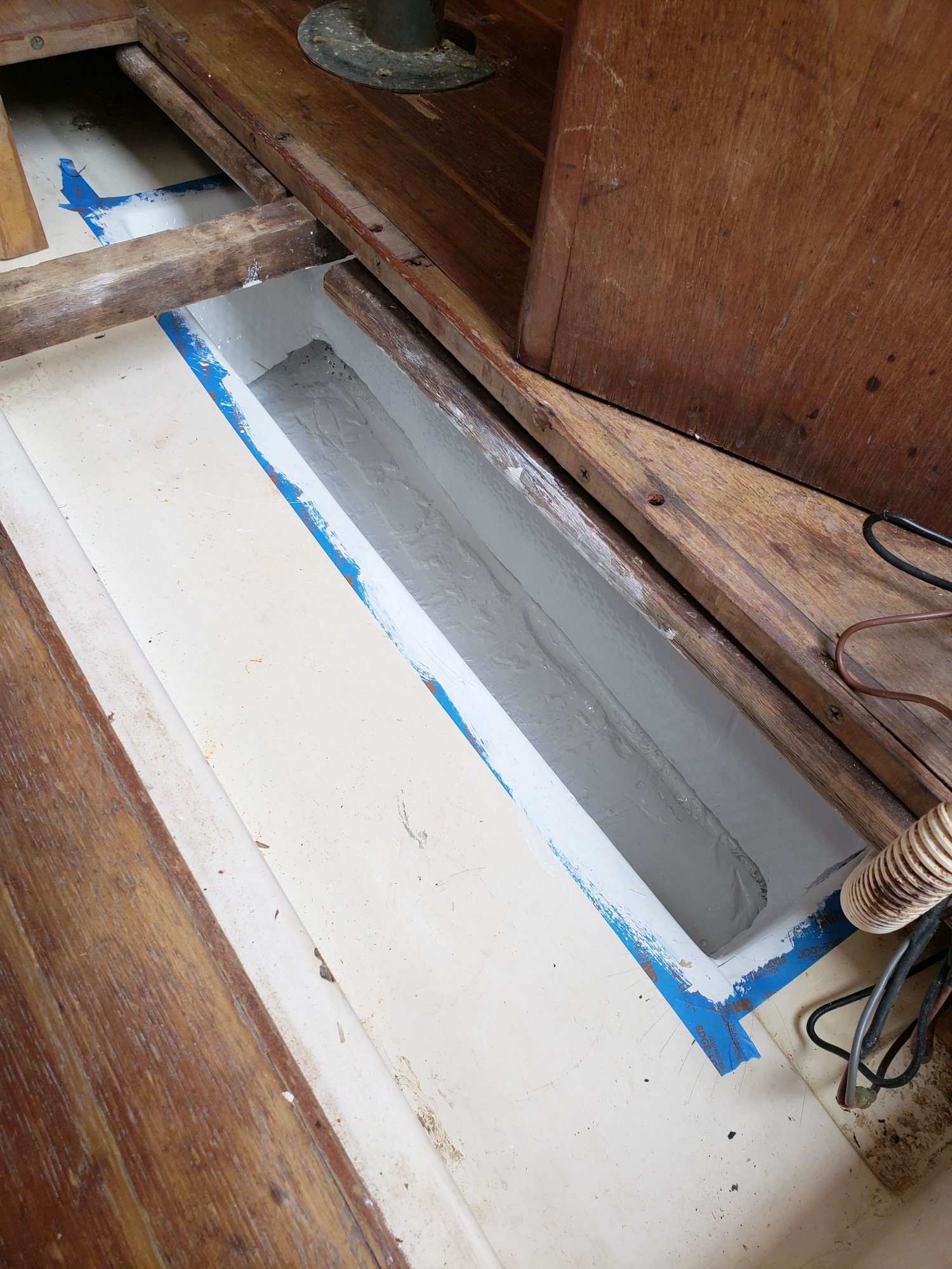

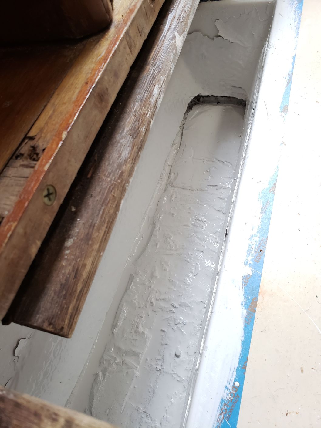

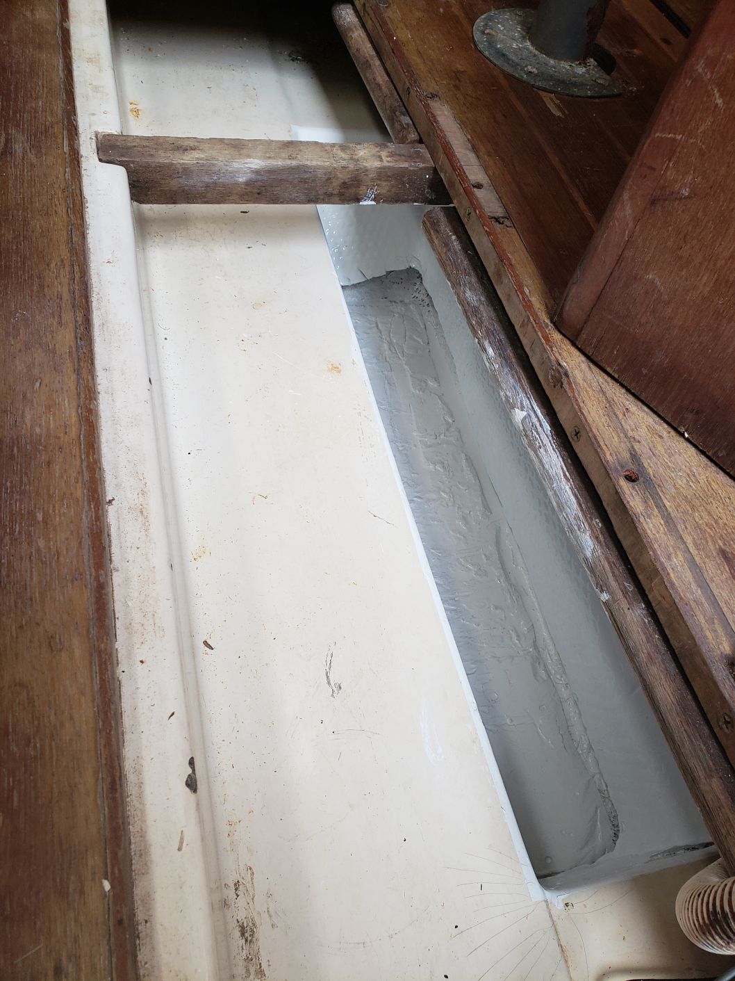

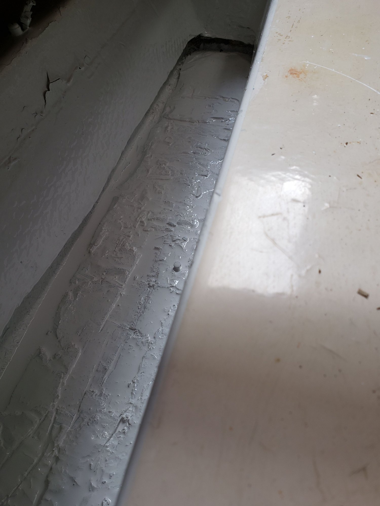

Mar 4, 2009
9
Hunter 31 Jacksonville
Guys... I realized I never posted my finished pics.... I saw others on Facebook looking to do the same thing and reminded me... here is the painted bottom from two years ago. And the smell has not returned. Thanks again for everyone's help! Rick
