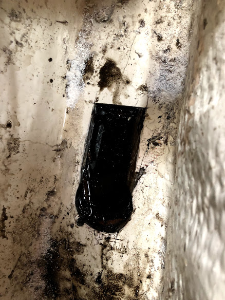

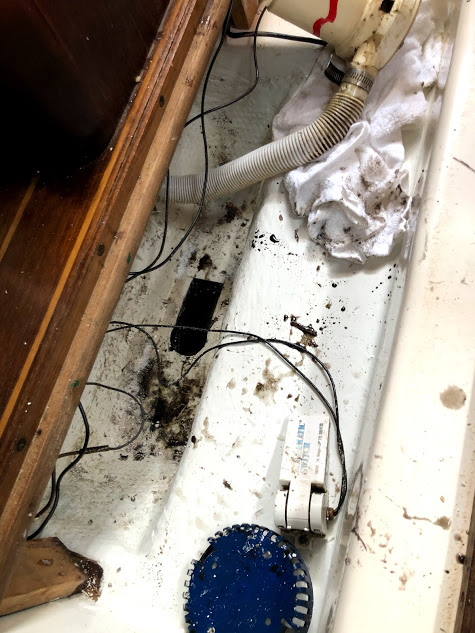

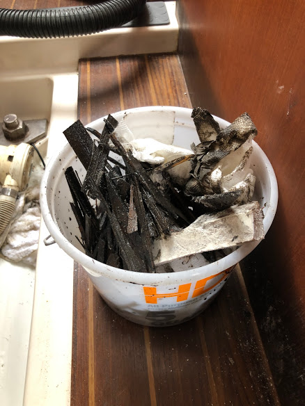

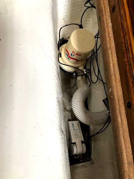

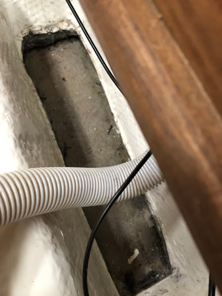

Today I tackled the false bilge issue on my 1983 Hunter 34. It went pretty much the way everyone else's has. I used a drill bit to open up a few holes to confirm that I was dealing with the same situation, and the black water that seeped up confirmed I was. I then used a Dremel side-cutting tool to slowly cut away the floor of the bilge area as detailed by others here. Same black sludge, same nasty smell, same rotting wood (although mine was only rotting on the very bottom - much of the thickness of the wood was still intact). I haven't painted the new bilge floor yet, nor have I flushed the area with clorox/water/Dawn/etc. yet - those will come another day. I'll append some photos here.
