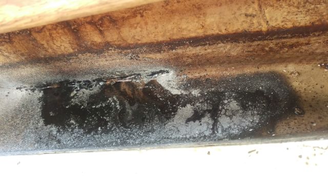

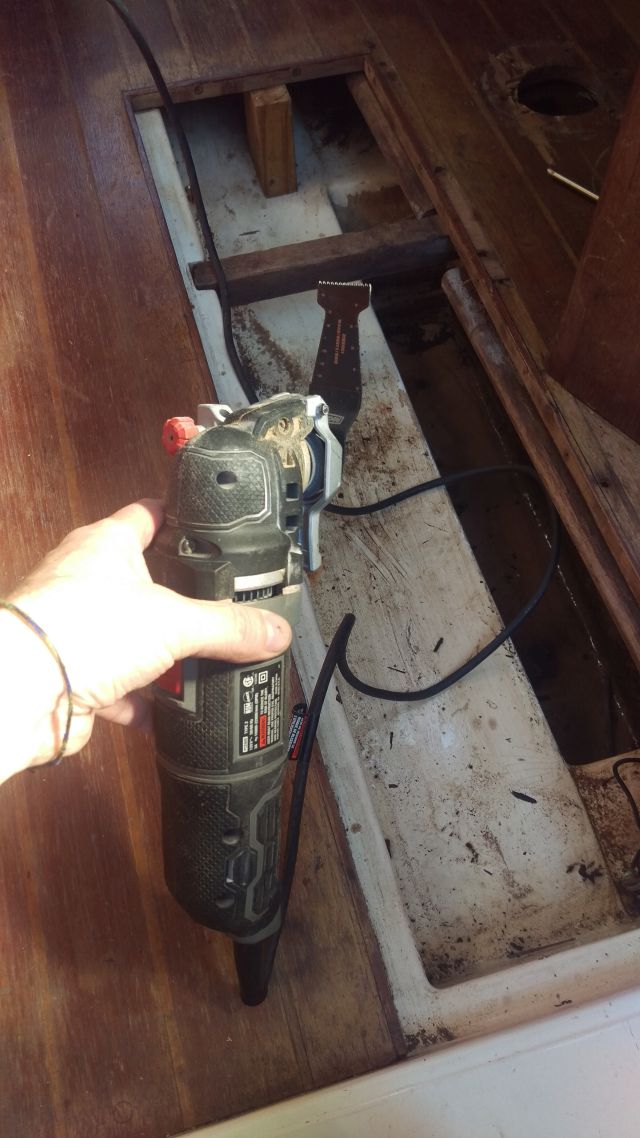

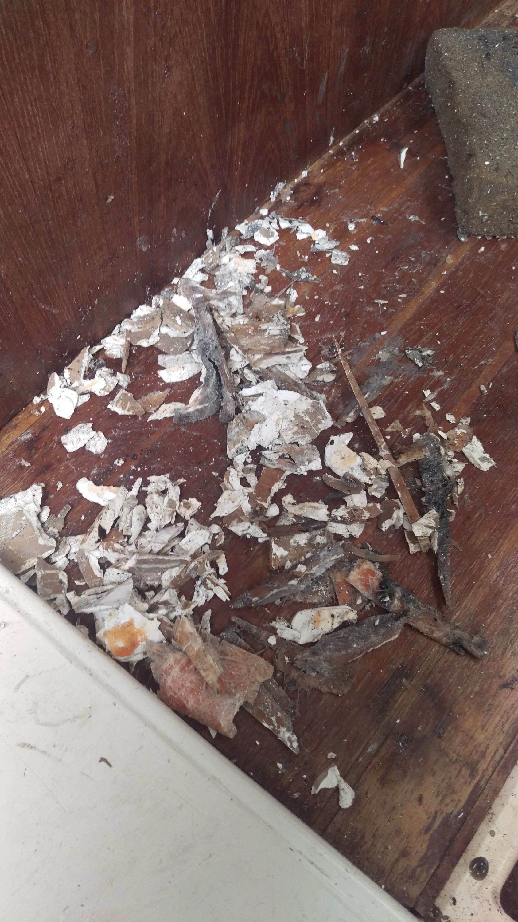

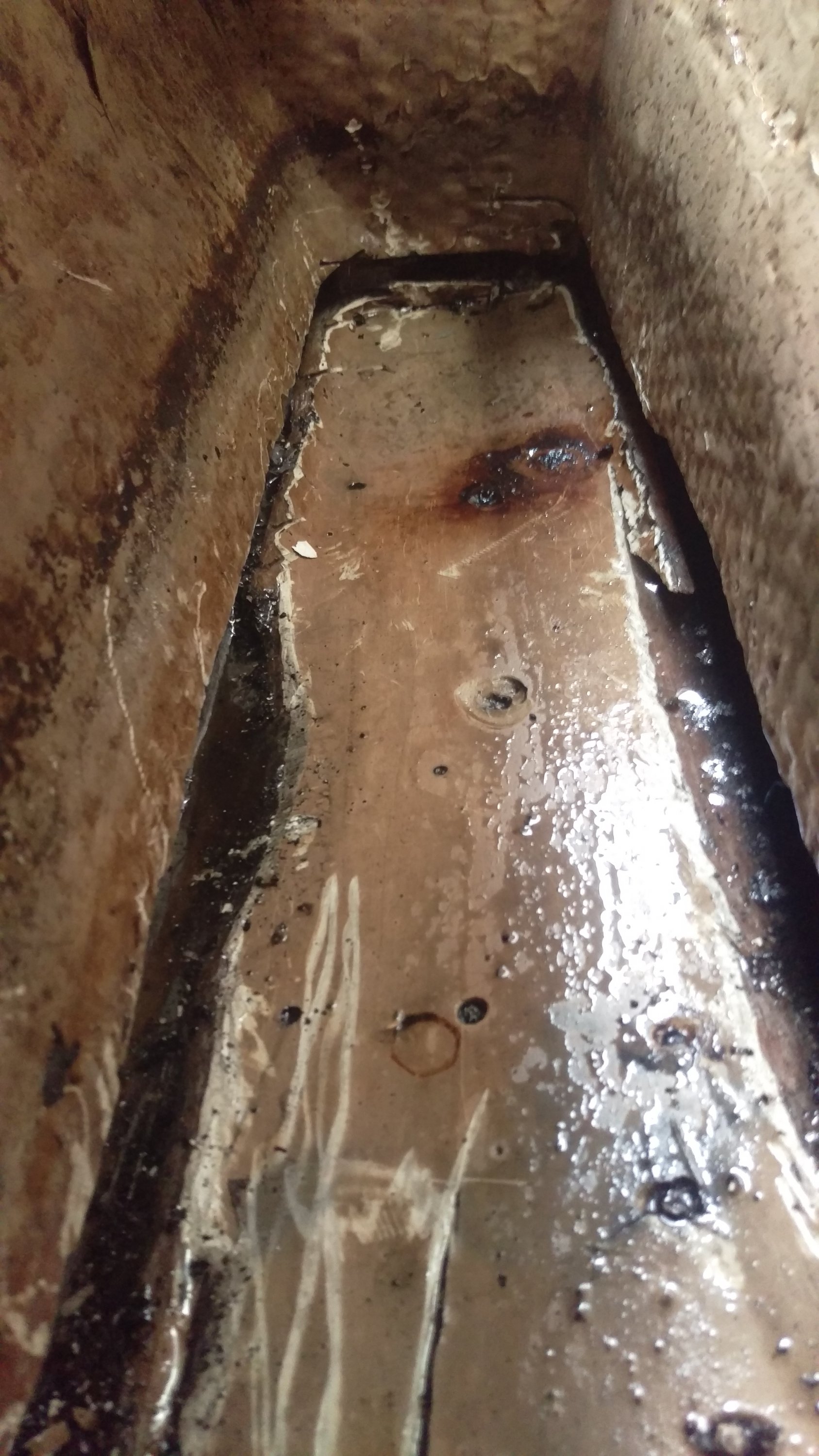

Ok.. I know it has been a while but today I cut the bilge out on my Hunter 31, 1984. I did not find any space below the bottom but I cut away the sides all the way around about an inch or less. And the stuff that came out smelled like a baby's diaper. It was gooey and what a mess it was in that bilge and all of my tools, screw drivers, etc. I'll have to finish the job soon. Today was the upper 60s here in Jax, FL so it was pretty nice. I did run the hose under the walls for a while and replaced the pump and float switch. Hoping it will dry out a little during the week. I will check back next weekend. Cleaning and painting will be next. I'll try to be better pics of the cut out sections, pretty ugly but it worked.
Later
rick

Great job!
You will notice a huge difference now that all that trapped garbage is now out. When I did mine on my h34 the smell was gone completely in about two weeks after I was done flushing it out with bleach and dish detergent. I then used some hydrogen peroxide with white vinegar 50/50 mix with a little bit of detergent poured it thru the engine compartment lining and allowed it to run under the liner. That really killed all the mold and garbage under the liner.
I used bilge Côte to paint the entire bilge area last season and so far no issues and no more Oder.

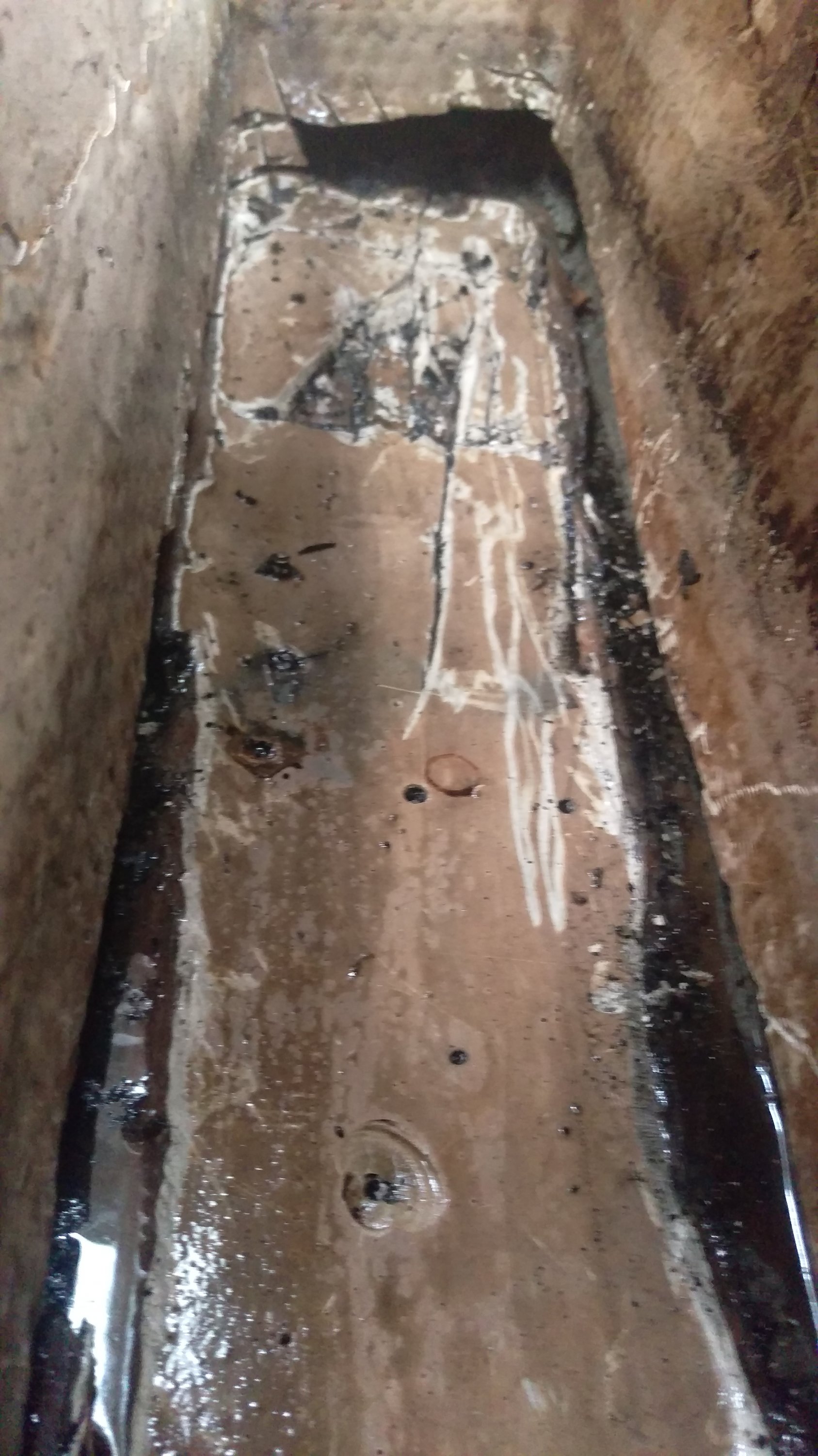

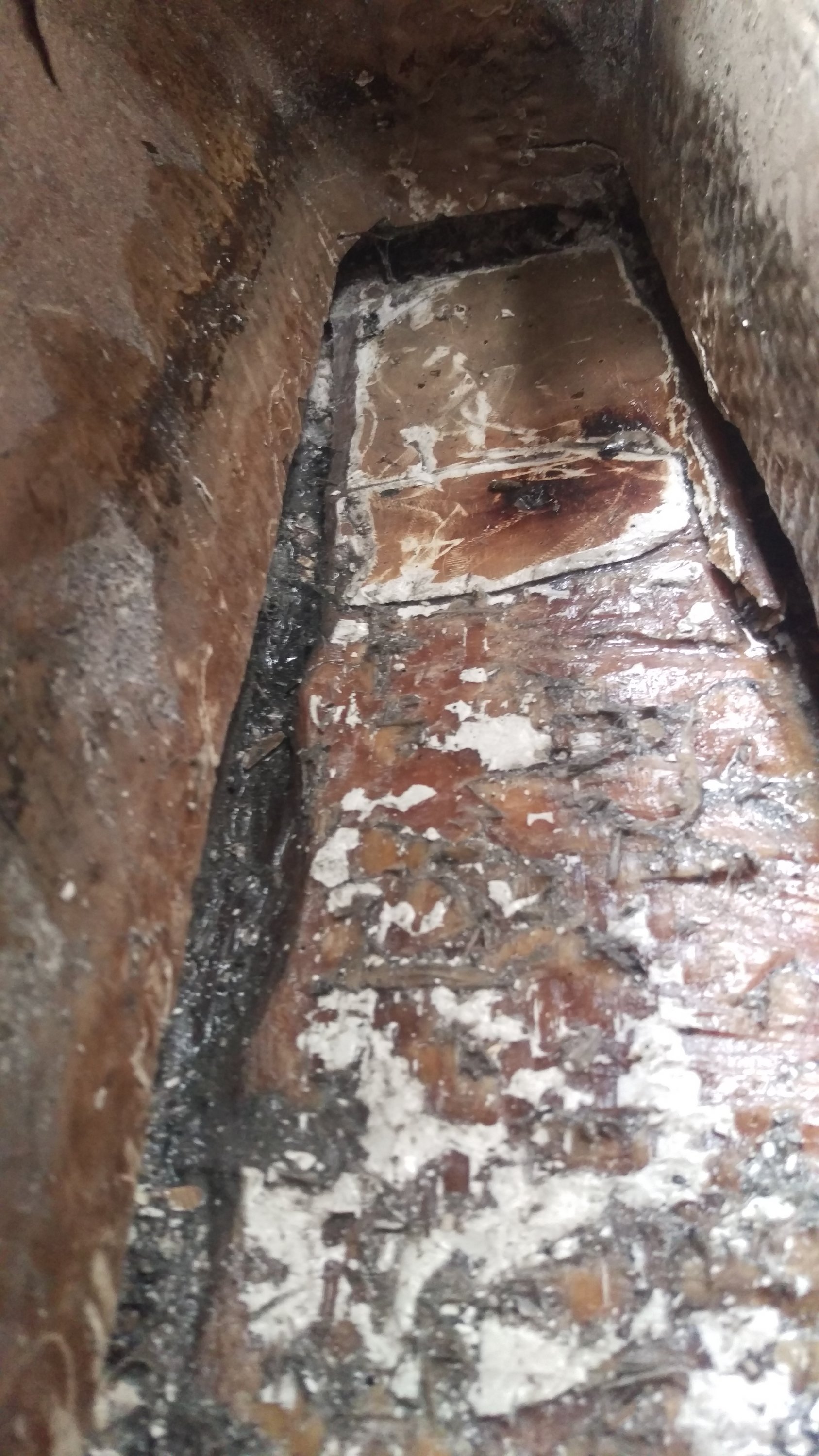

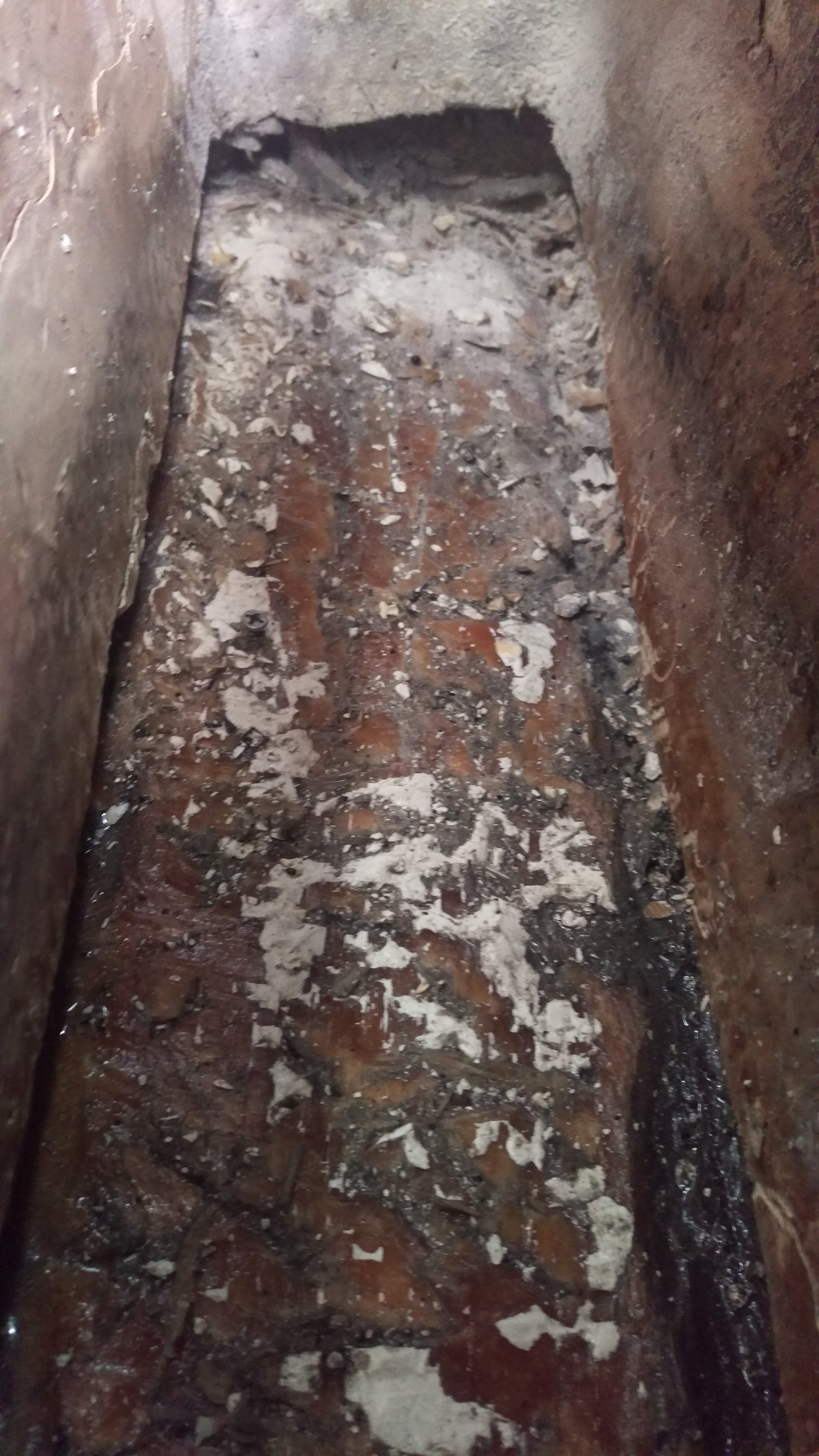

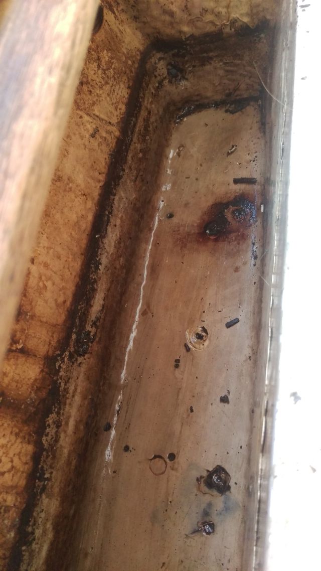

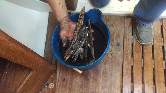

Ok... Day two of the bilge work.
I did find that there is a small piece of wood below the bottom fiberglass. It seems to be bonded into the fiberglass in most places. I did have to chisel the bottom. I worked on it for four plus hours this time. And the looks of things I need another day to really get the bottom where everything drains ok. There are still high points around the edges and that holds water (and other things) from entering the bilge. More pics below... Staring pics is where I left it last weekend and others are from day two.
I did spray a mixture of water, bio friendly boat wash, and bleach all around the boat drainage areas. Wiped down quite a bit too. I did find a little of the gook but not much. I'll keep this going for a little while and maybe add white vinegar to the list.
More later as I go along... Thanks @SFS and @Mike Culik for their input. And thanks for the kind words.

Wow, what a lot of effort. Way to go Rick. Did you use a sharp (wood) chisel and hammer, or something a little more blunt, like the end of a pry bar? Keep posting pics, it really helps.
Mar 4, 2009
9
Hunter 31 Jacksonville
@SFS - Sharp chisel and hammer. Came out ok but very small pieces so taking a while to do. I found the crow bar types were too curved. I did use them to pry a few times though but I did not find them good for chiseling the fiberglass.
Aug 23, 2011
94
Hunter 31 Georgetown, MD
Rah
Looks good cleanup takes a while.
Chisel and heavy duty putty knife is what I used followed by many wash downs with verious concoctions of soap/solvents for the sludge. Major improvement in the odor control which was the goal. I've had a totally dry bilge for the last two years.
