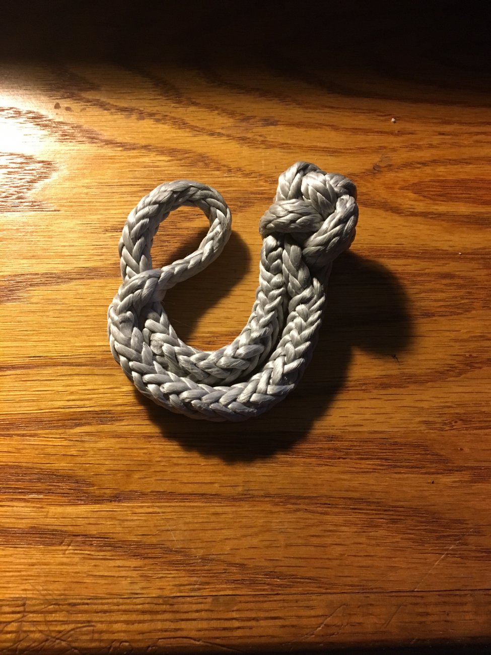

Dynema is a different animal. Just burying the line is not enough if this is a line you will need to trust. You need a locking knot and a bury. The brummel or the Macdonald brummel depending on the length of line involved.
For soft shackles I prefer to use the Brian Toss designed knot.
it is strong, neat with no frayed ends showing.

Rick, I did a zoom meeting with some Catalina sailboat owners about 6 months ago, showing them how I tied the Toss Soft shackle. Would that be of interest to you?
