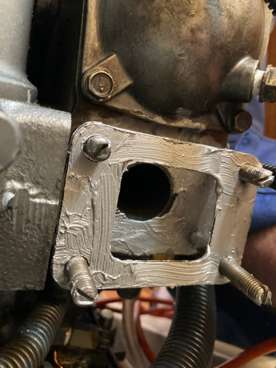

Try some temporary gasket material but be careful what you coat the gasket with. You don't want just "Permatex" on the flange faces. It must be Permatex Anti Seize. Permatex sealants are difficult to remove even if the flanges are sitting in your lap. Place the flange face attached to the engine in a difficult location and -you-will-lose-it- trying to get it clean. A sealant is not required on these flanges as the exhaust pressure is near zero.
My exhaust flange faces are nearly inaccessible and I refuse to remove the riser just to clean it. Once you are back there, you are working blind The stud guides shown are removed and replaced in order with the original grade 8 bolts. Both flange faces and the gasket are well coated and the gasket drops away when the flange faces are separated.

I'd spray anti-seize on everything that doesn't move, and if in doubt, spray a few of the things that do move as well. Small children are one example.
As shown in post #4, I put so much anti-seize on the gaskets and flanges that when the joint is opened up years later, it can drop down behind the engine if not caught first. Without the anti-seize, it is near impossible to see and clean the flange face on the engine exhaust outlet.
