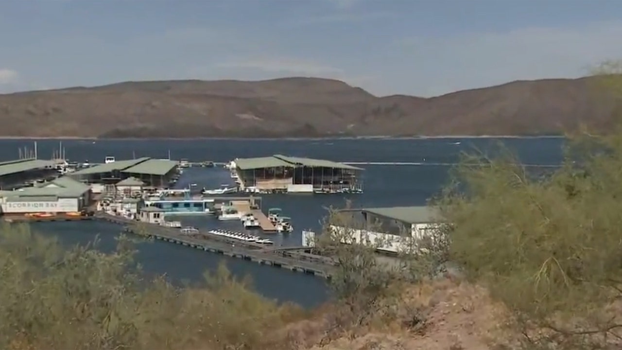

I’m guessing that a dock power cord fell in the water, but why wouldn’t the circuit breaker stop the current?
That’s my marina - Scorpion Bay.
