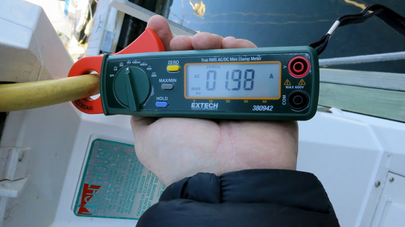

How about this guy, who was completely oblivious to his boats issues. He also did his own AC wiring. That 1.98A leakage is multiple times the lethal amount required to kill a human..
Wow, that's scary.
Regarding "every boat on the water should be wired to ABYC standards," well, that's not going to happen, as you know; and there are lots of boats out there built before the standards fully evolved, I think. But as far as the AC is concerned, even though I'm pretty much a libertarian, I would like to see enforcement at the interface point: if you are going to plug into the public infrastructure, your boat must comply! This would be AC only, of course. I wonder if a test could be devised, so that one could ascertain quickly whether a boat was safe or not?
