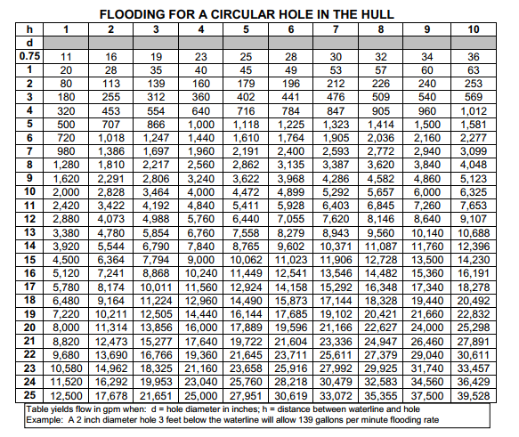

Do you think a better bilge pump would have helped with clearing the water from that foot-diameter hole?
This only goes to 10 inches, but at a certain point, none of us can carry enough pumping capacity.

Cool table, @capta , and I was being sarcastic about being able to pump out from such a huge hole. I think that you're reading your table backwards, though. The vertical numbers are hole diameter in inches, and the column headers are feet below the waterline. So my guess of a foot-across hole about 3 feet below the water (keel / hull joint) would produce a mind-blowing 5,000 gallons a minute, or about 20 tons of water. The only thing holding it back was the pressure from the sealed saloon. She probably was on the bottom within a couple minutes.

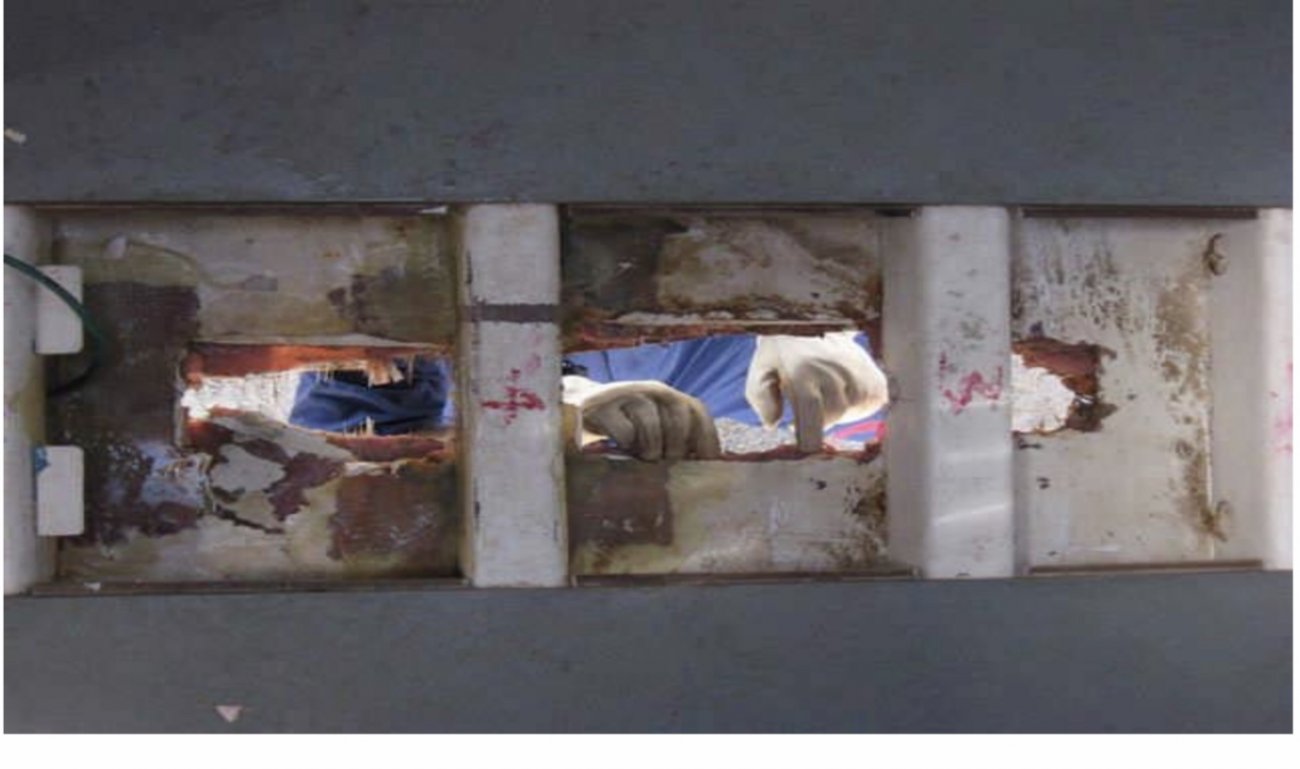

The Cynthia Woods.
Funny you say Keel Maintenance.. after the accident the USCG issued a report blaming the university for lack of said maintenance after a string of soft groundings with the boat. Stung, the U commissioned a fancy report that said the maintenance did not factor, but lack of buildup in the keel of the lightweight, one-off racer’s sump did. I read both reports at the time, and I have to say I agree more with the A&Ms report. In any case, it sure left a clean hole in the bottom.
EDIT NOTE - To be prefectly clear, this picture was of the race boat ‘Cynthia Wood’ which lost her keel and sank in the gulf with the loss of one life, and not the O’Day.

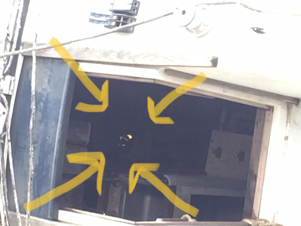

Why in the world did the keel bolts not extend through the frames? Is there a reason for this or is it just poor boat building?

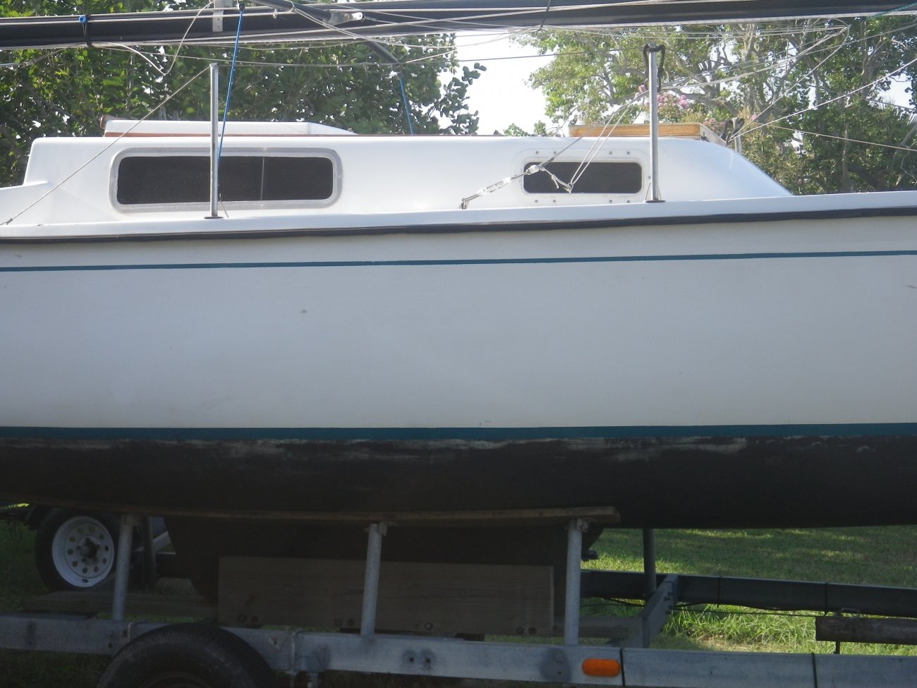

some years ago a Catalina 30 lost it's keel sailing offshore Matagorda Island. Apparently it just fell off !!! Boat washed ashore on the beach and had to be cut up, parts salvaged and hull burned- no way to get it off- no roads. I have the mast head, and the ports from that boat. I used two of them in rebuilding my Lindsey 21,
Sorry-wrong picture. This one instead
I would not have set foot on the f**ker if I had seen that detail. Let alone go offshore at night.
The commissioned report found at least 7 serious design and construction flaws, deviating from accepted practice and build minimums. If you wanna read the whole sorry story, here it is. It’s actually an informative read.
