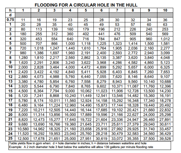

That is an interesting chart @capta
In what sort of text does one find such a chart?
I'm sorry, I've had it for years and don't remember where I got it. Most of my info like this comes from a book called Norie's Nautical Tables, which was a necessity when I was operating freighters and tugs. It's still useful now and then, but if you have internet and know what you are looking for, you probably don't need to spend the money. A couple of my favorites; Distance by vertical angle, Distance of the sea horizon and Ports of the world.

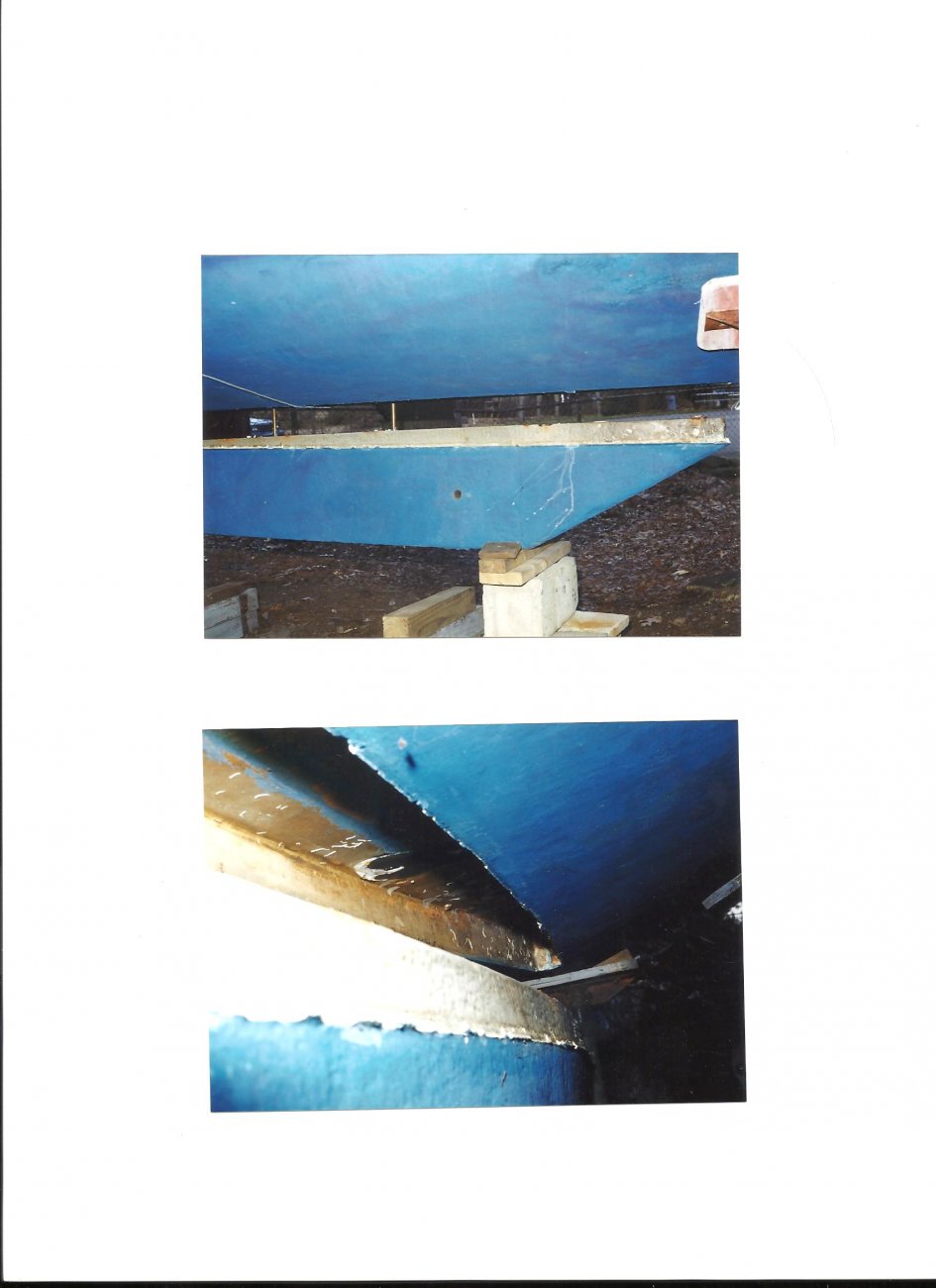

Why in the world did the keel bolts not extend through the frames? Is there a reason for this or is it just poor boat building?

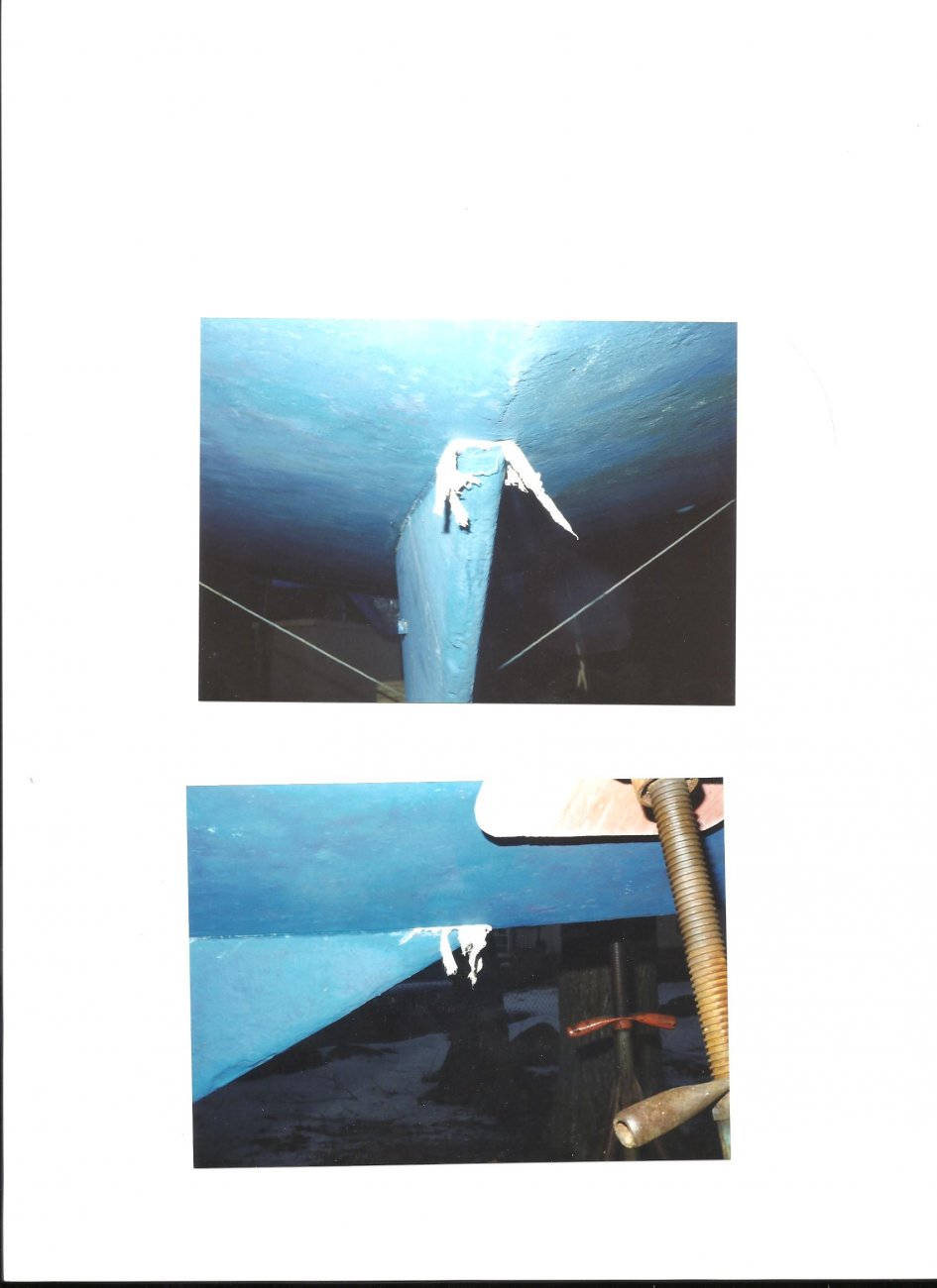

Years ago, the keel of my O'Day 23 almost separated from the hull. I had rowed out to the mooring, and found a foot of water above the cabin sole. After bailing the boat out, I dove on the keel and found a gap at the forward keel/hull joint. I ripped up one of my socks, dove again, and stuffed the cotton into the gap to temporarily seal the leak. After the boat was hauled, I found that the forward keel bolt was almost through the hull, with the next few almost as bad.
After pulling the keel bolts, I was amazed to find that only 1/8" of fiberglass held the keel bolts to the hull. The sump had one and a half inches of solid material, but the holes for the keel bolts had been counter bored for the bolts. My fix was to fill the counter bores with epoxy/filler mix, rebore the holes, and buy longer stainless steel bolts. I think the repair was better than new, by a factor of 100! To this day, I can't believe the boat was built this way. Maybe because the bolts on hand were too short?
BTW, The forward keel bolt was at the thickest part of the keel, and held a majority of the weight, but had the least amount of hull material supporting it!

These phots were scanned into my computer years ago. I'm not sure how they will look here, but two are of my temporary seal, and one of the other two shows how big the hole for the keel bolt was. The washer had almost pulled through.
Interesting. Were you the original owner, or could some PO have made some changes? Countersinking the bolt heads does seem like a very strange thing for the factory to do. The added labor of drilling the countersink holes would exceed any cost savings of a shorter bolt.
Likes: Tom J
Tom J
Sep 30, 2008
2,301
Catalina 310 Quincy, MA
The boat was over 20 years old when I got it. I guess we'll never know the whole story.
Thanks.... I know that angle chart will be useful. I'll look it up.
