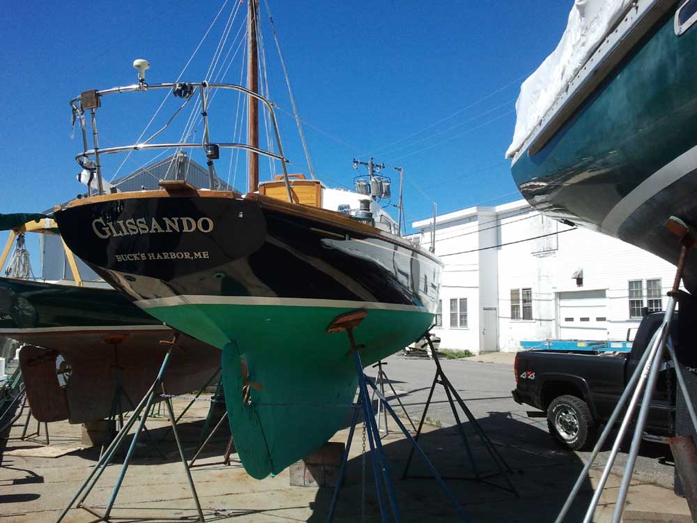

"Does it still make sense to restore old boats?"
Restore (re-store): To clean and repair something old and dirty or damage so that it looks the same as it did originally, to bring back to an original condition.
I think, with the exception of a few boats here, we have a divergence on what "restored" means.
Restored or Restoration :
*Complete re-finishing of exterior (top sides and deck) with Awl-Grip, gelcoat or another suitable marine finish (does not include a one part paint)
*Bottom stripped, faired, barrier coated and painted
*All deck hardware removed and re-bedded
*All ports and hatches removed & re-bedded
*Mast stripped and re-finished
*New standing and running rigging
*New mast wiring
*New sails
*New lifelines
*New Electronics
*All metals completely polished and any peeling chrome re-chromed
*Interior stripped and cleaned to bare gelcoat
*All exterior wood stripped and varnished or Cetol finished to new boat standards
*Any rotted wood completely replaced
*All seacocks removed inspected, cleaned and re-installed with new backers unless corrosion is present they they would get replaced.
*Interior fully re-finished
*New interior cushions
*Completely re-wired
*Keel dropped and re-set if any signs of "smiles" or weeping exists
*Replacement of keel bolts if rusted
*New sanitation and domestic plumbing
*Any deck core moisture cut into and repaired.
*Re-built or new engine
*Fuel tank cleaned
*All fuel hoses replaced
*New wet exhaust hose
*Steering pedestal reconditioned and brought up to new standards.
*Compass globe clear with no crazing and repaired if necessary
*Prop and shaft fully re-conditioned or new
*New stuffing box hose and stuffing box cleaned and or replaced if corrosion present
*Rudder dry and free of moisture and repaired or replaced if necessary
*Rudder gland cleaned and re-packed
Etc. etc.....
A RESTORATION is different from "I bought a used sail and a used motor, cleaned her and sold for a profit"..
In a real restoration it is very difficult if not impossible to turn any sort of profit on a "generic" boat.. The OP specifically asked if it made sense to "restore" an old "generic boat" not of you could buy one throw some used gear at it, clean it and turn a profit. I am taking the OP at the true definition of "restore" as I have seen many true "restorations". On a "generic boat" I don't think it makes much sense.
This is but one example a real RESTORATION: Glissando
