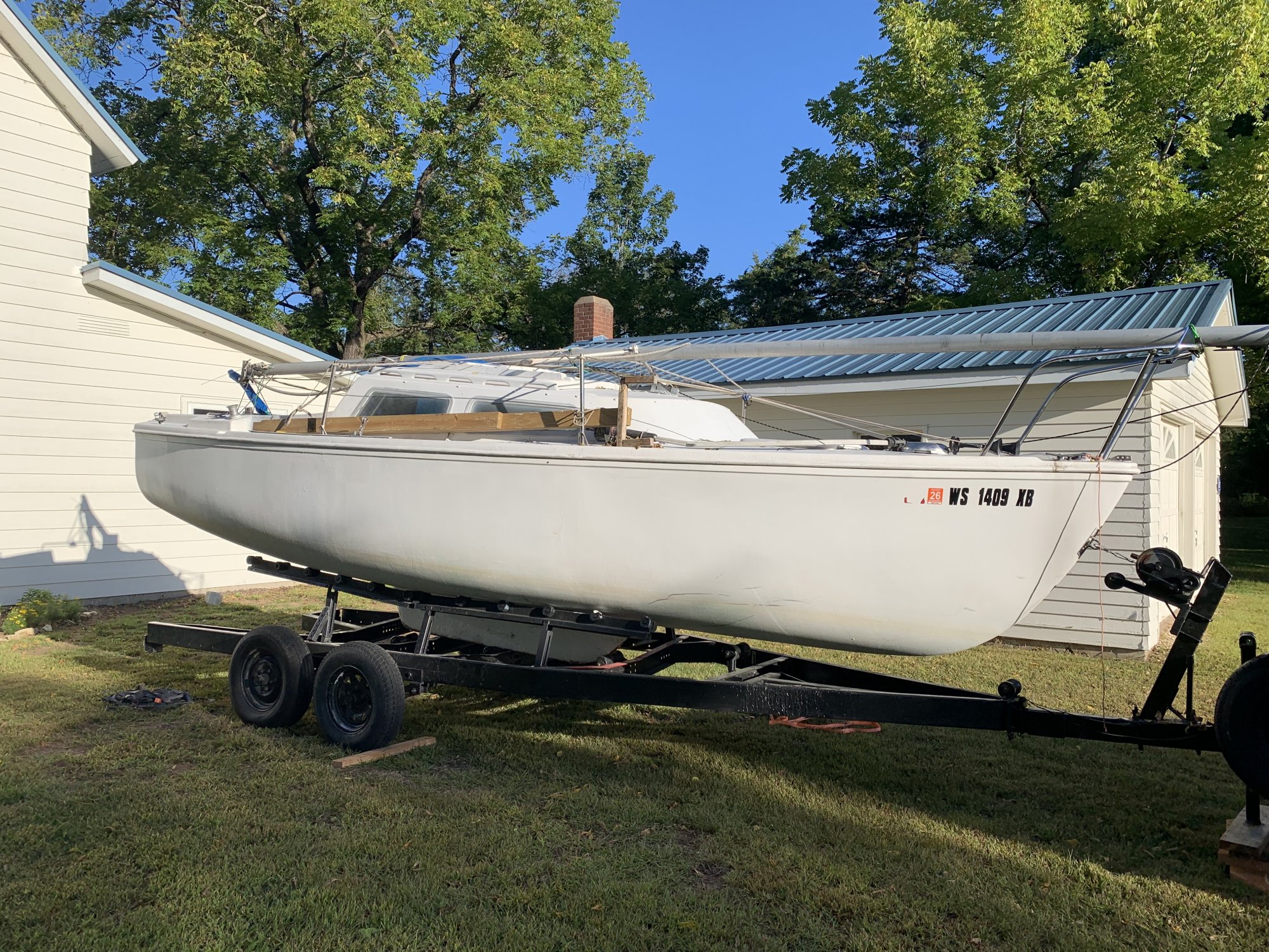

Don't under estimate the amount of time this can take if done properly. Paint only last so long before it starts peeling or deteriorating. Once you prep and paint, you can't go back so let's see what the deck looks like. Your hull looks decent.
There's an appliance spray paint that's a super close match to Catalina's white. I discovered someone had used spray paint on the back of my boat after I had it detailed. It can't be seen unless I point it out up close
I'd recommend sailing it as is for a season and then see what you're still interested in rehabbing.

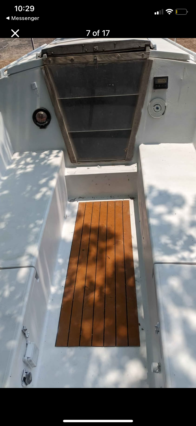

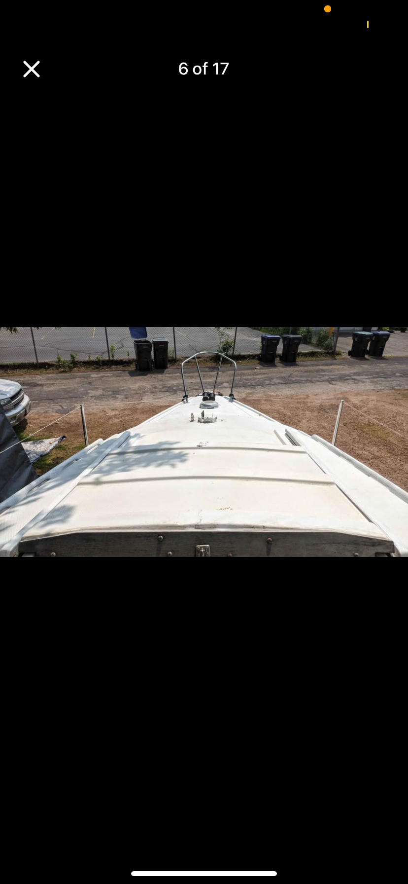

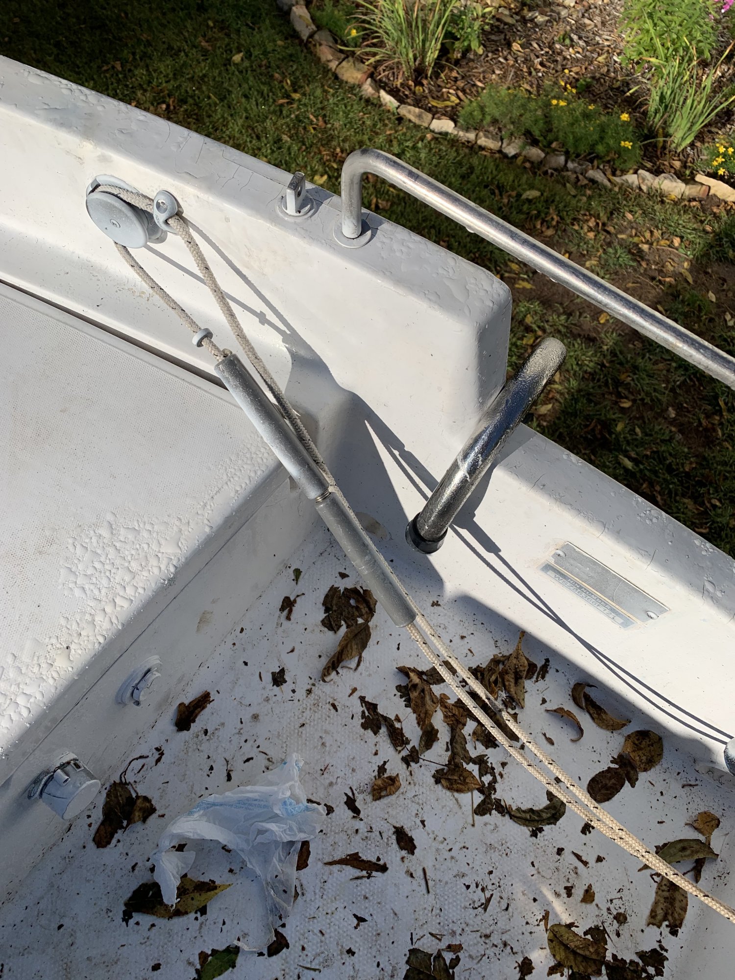

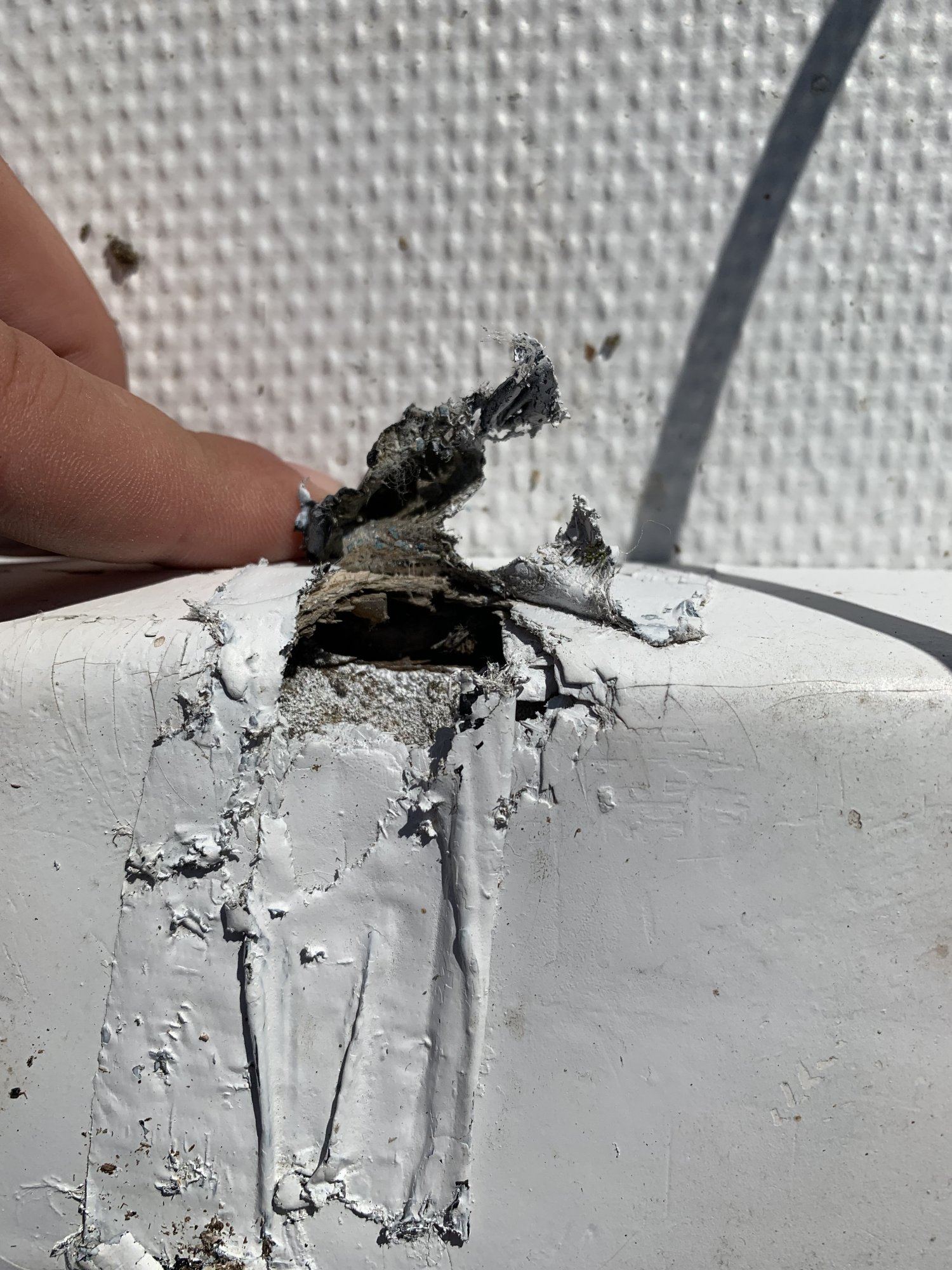

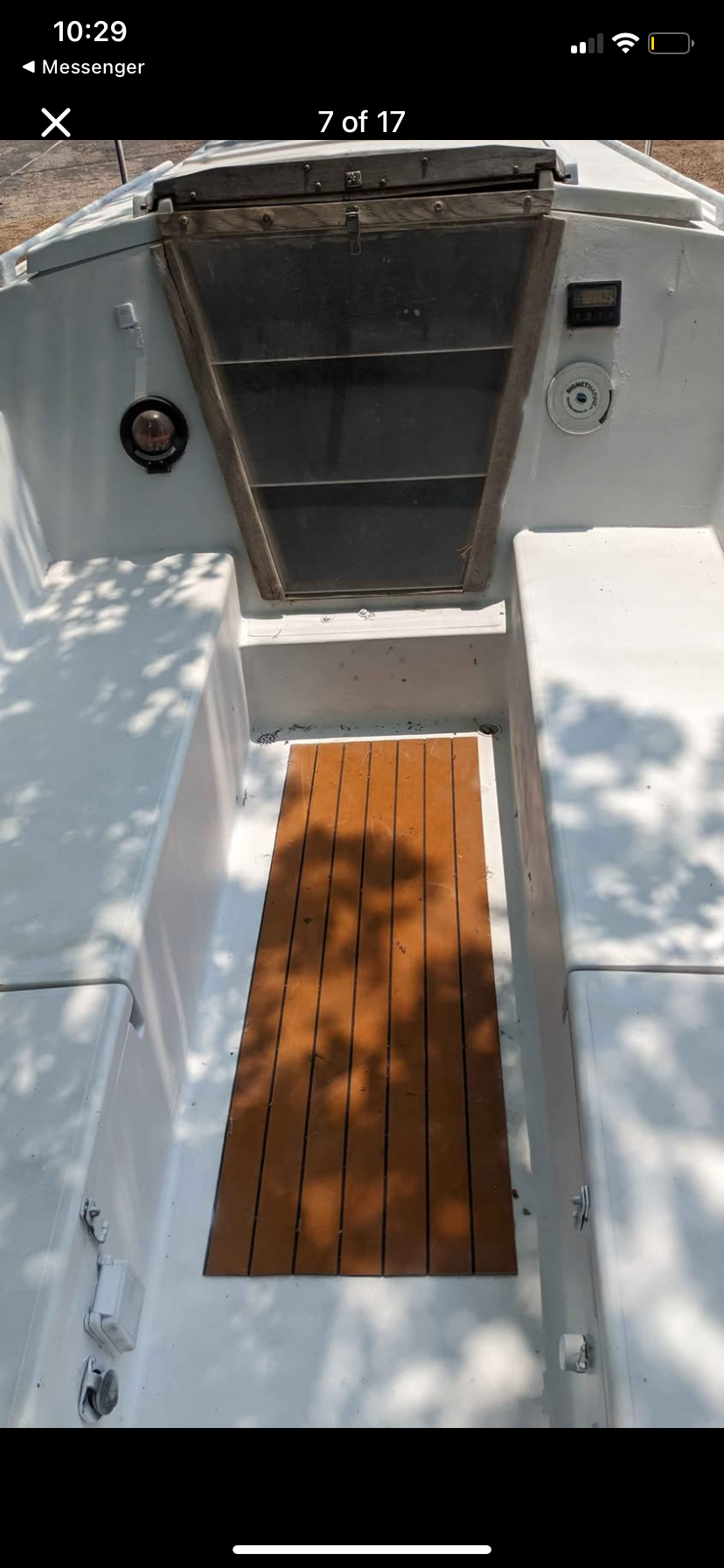

Appreciate the reply! Im not with the boat currently but here’s what I have of the deck. Structurally it’s in good shape. No soft spots that ive found. But the up close the paint has seen better days, and there’s damage to the sliding hatch.

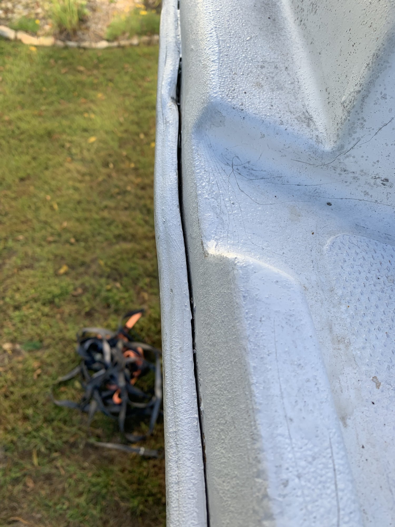

The spider cracks are gelcoat crazing, something quite common in older boats. It is cosmetic, not structural. They can be repaired but it is a time consuming tedious job.
The damage in image 0574, does need to be repaired. Where on the boat is that damage?

Whats all involved in repairing the gel coat cracks? And it I sand/prime/paint over it without full on grinding it out and epoxying it will it eventually come through the new paint?
The damage is to the sliding top hatch. I plan to remove that along with the teach rails and restore them this winter.
