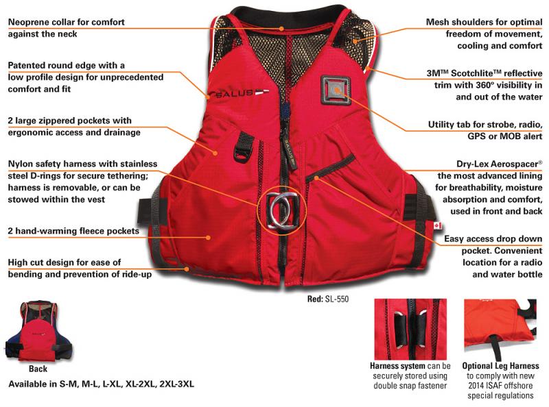

The above stories about inflatables were in the back of my mind when shopping for PFDs. Our boats already have sizable amount of preventative and unscheduled maintenance. For my requirements today, I was not interested in adding PFDs to that list and went with the Coastal by Salus with its built in D-ring harness.
http://www.salusmarine.com/?products=coastal

That's a decent looking dinghy vest. Even on our 36.7, several crew members wear their dinghy vests, mostly out of habit from their dinghy days. But they suffer greatly on long hot days. In general, most follow a simple rule. If its not uncommon you will end up in the water, wear a dinghy vest. If it IS uncommon (keelboat) inflatable might be better.
But the simple fact is there is no simple rule. Wear what makes the most sense for you.
But I have to say, when I went to that web site you linked, I saw this and threw up in my mouth.
