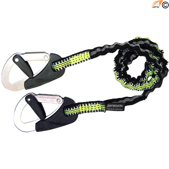

I just returned from doing the Ensenada race and had spent some time and a lot of money getting my safety equipment updated. I ended up getting the Spinlock Hammar PFD because of the crotch straps and the good fit for my body. I also decided, after doing some reading, that the Spinlock tether was my best choice. So, my first opportunity to use them was immediately, doing this race. I am pretty appalled by the difficulty I had in clipping in but particularly unclipping from our jackline. I could do neither very quickly and it was pretty apparent to me that if I were in a very serious situation, it would be even more serious BECAUSE of the clips. They work counterintuitive so it will take a lot of just practice practice practice, to get comfortable with the way they work. Also was not thrilled with the idea of the way most jacklines run along the sides of the boat. Bottom line is we/I needed to do a lot of practice using these new items if they are going to actually be an additional safety measure for me. Having crotch or thigh straps stuffed into my pockets because they catch the back of my leg, and drive me crazy is not helpful. On the brighter side, the Spinlock PFD comes with a very easy to reach awesome knife that might get me out of trouble.

On the subject of the spinlock tether, our racing guys don't like it, it is not ISAF compliant. The ISAF compliant testers have a quick release at the harness, so you can untether if you are being dragged. It does have that knife thingy, call me skeptical don't know if you would find that in an emergency
A few years ago (believe it was the double handed Farallones race) someone drowned being pulled by his tether.
If he could have released then he might have frozen to death, or somebody could maybe have rescued him.

Your should have your 'racer guys' read up. Spinlock tethers are most certainly ISAF compliant. And many test modern tests have shown that while dragging in the water, a person CANNOT open a snap shackle under that load. Best practice says your first (and probably only) move is for your knife. Its what all the VOR people do.
PS - The inability to open it under heavy load is why racers no longer use plunger-style snap shackles on spin sheets and guys.

Oh that's great new cause those are the ones I bought!
