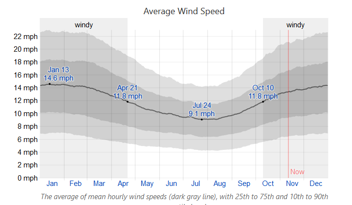

this past summer we saw consistent winds in the 15-25 knot range. Don't know if this is typical as this is our first year on the ocean/in this area.
15 to 25 kts wasn’t typical in the 1980s when I lived in That area. I windsurfed the area from Narragansett Bay, to Buzzards Bay to Cape Cod area for 10 years, in the 1980s. We were lucky to see 8-12 kts of wind during the summer in the afternoon when the thermally induced onshore breezed kicked in. Maybe 1 summer afternoon out of 10 was windy enough to produce whitecaps.
in sept or October, the winds got stronger and there were more storm fronts moving through.
The data on the following linkwebpage matches with my recollection pretty well:

My experience has been different - Naragansett Bay isn't that windy but Buzzards Bay, Vineyard Sound and Nantucket Sound have many days with 15-25 knots of wind in the afternoon. Been sailing there since the 70's. The following chart shows the average wind speed in Buzzards Bay - note this is just the average:
