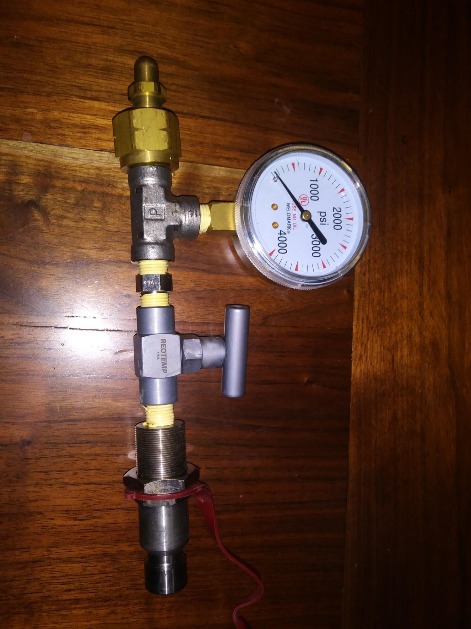

I made one that I am very comfortable using and somewhere I have the parts list and can take a picture. It is much like the one @Stu Jackson posted the link to but it has one additional component. Between the Sherex receptacle and the gauge I added a high pressure gas rated throttling valve. That way I can hook it up, open the valve at the tank and the fill valve from the pumping station. Then I can fill at a controlled slow rate that doesn't increase temperature much and I can control the pressure to shut it off at the fill pressure I want. That makes me feel way more comfortable than a "blast" of high pressure gas that heats the tank and could easily overpressurize it.
I filled mine for about a $1.46 total at a ENMARK station in Savannah. Look for a heavy industry or local warehouse place and see if there is a CNG filling location. It was put in at Savannah because some of the big and medium size local delivery trucks near the container shipping port. I'll post the parts list and the picture tonight.

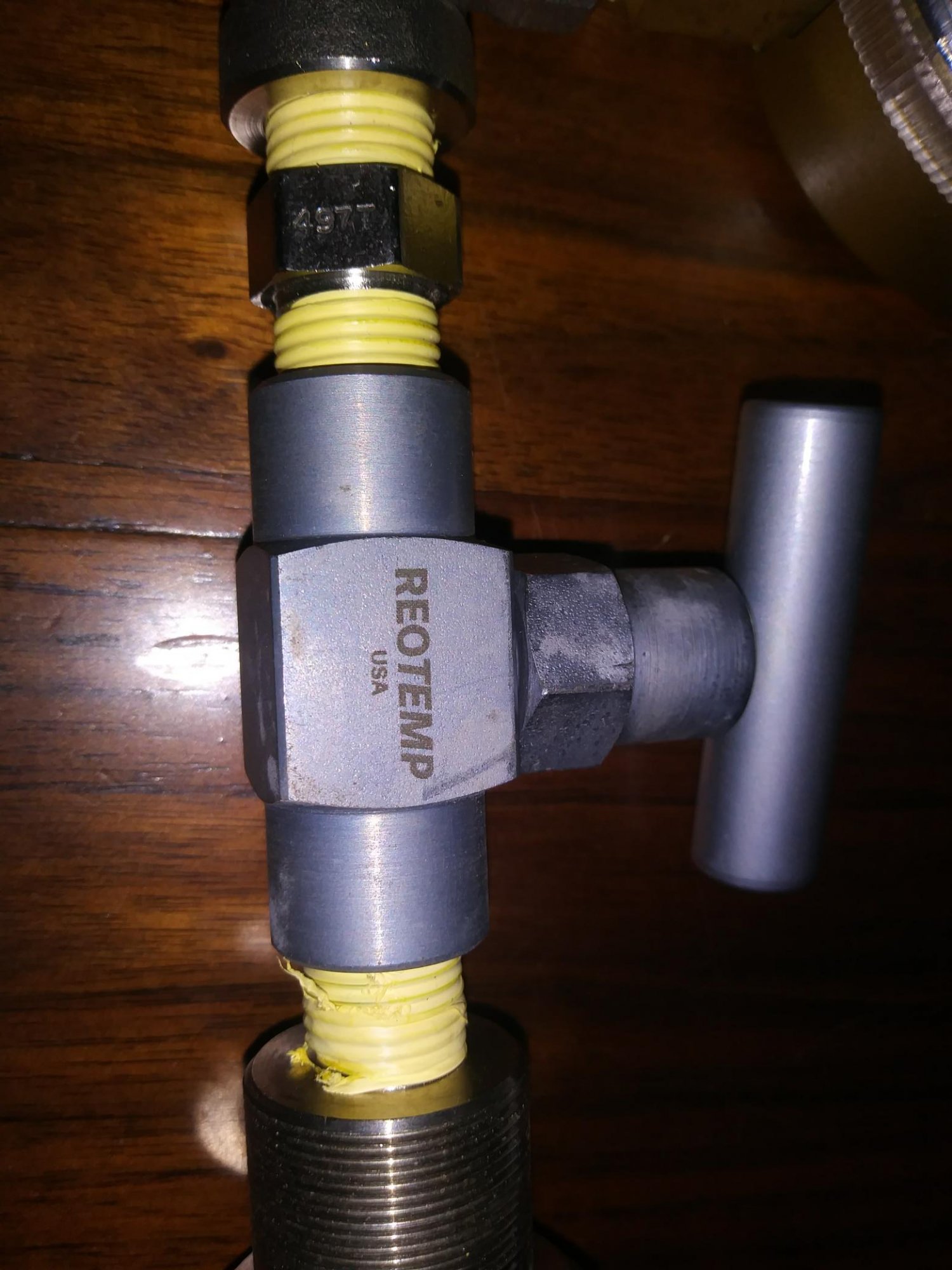

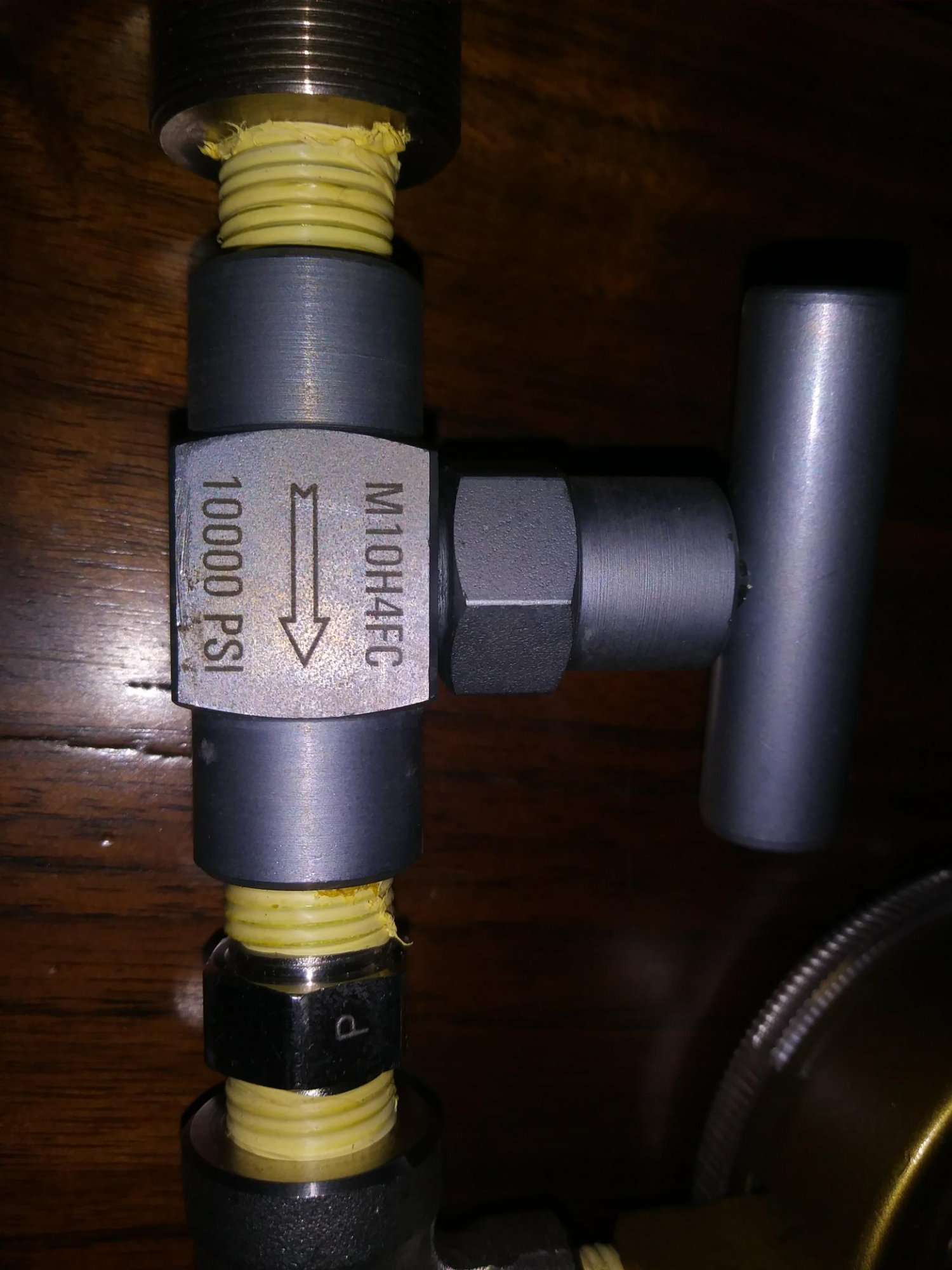

Here are some pictures that show the throttle valve that is an addition to the CNG adapter that @Stu Jackson posted.
I did not have to modify my T fitting as everything took 1/4 inch SS nipples. You can google Reotemp. I believe the part number is M10H4FC. The throttling to fill worked very well and let me control pressure increase in the tank. Other than the CNG Tank nipple and the Oil Free Pressure guage, everything is Stainless Steel rated for

Make sure your throttle valve is between the charge inlet that connects to the pump and the pressure gauge so the pressure gauge reads the pressure in the tank. Otherwise you'll only read the charge pressure which is either 3000 psi or 3600 psi ;)
