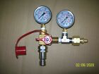

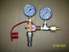

This may help you. I have the same issue here in Spokane Washington. For3 months have been pondering this issue because I was out of CNG. My stove is to old to convert to propane so I would have to buy a new stove and build a locker for the tank(s).
I finally built a CNG fill adapter and since I only had one tank I checked on tanks, new ones are super expensive. I did how ever find Sure Marine, Seattle, WA. (208-784-9903) who has stopped filling tanks. They have 3 pallets of used tanks that are out of certification. They sold me 2 for $20.00 each and I had them recertified for $19.60 each.
They also have their CNG fill station and they said they would pretty much give it away, I'm not sure how big it is but if I had Natural Gas at my house I would have grabbed it, but I don't.
So that being said, I drove from Spokane to the Clean N' Green filling station in Seattle (149 SW Kenyon St) and filled all 3 tanks for a total of $5.07. It's going to take a while to get the ROA back on the adapter but it beats buying the new stove by a lot.
My photo was to large but here is the parts list for the adapter, If I can help with anything more on this let me know.
