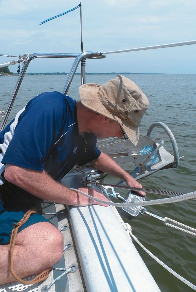

I spliced my own dyneema loops (sling) for this purpose, and use them to form a prussik knot on the anchor rode and attach the loops with a large stainless spring-gated hook on the bridle/snubber lines. (1/4" dyneema has a breaking strength >5,000 pounds)
The hooks I use are more reliable than the D-shackle @thinwater shows, and quick to use one-handed. I use the largest size Wichard snap hook (it has a 3168 pound WLL)
This works on chain or rope rode, I use more than one loop wrap on the prussik when using rope rode, to avoid slippage.
What's the elasticity of the Dyneema? With nylon running @ around 30% there's little to no shock as the boat comes up tight on the tackle. Strength is not what I'm looking for in a snub line, but rather elasticity so that strength becomes secondary.
In your post it seems you are adding a weak link in the whole setup, even with the largest size Wichard snap hook, that is still thousands of pounds inferior to the Dyneema.
You didn’t understand what I’m doing...
First, the dyneema loops are only about 12” long. They are used to form a prussic knot around the rode, and the snap hook is spliced to the (nylon) bridle permanently, to attach the dyneema loops - easy to snap on and off the loops. One loop for each side of the bridle, and one hook for each loop. (It could be done with a single hook spliced to both legs of the bridle, but that’s not the way I have used it).
Second, let’s discuss WLL. Grade 43 anchor chain in 3/8” has a WLL about 5400#. 5/16” Grade 43 high test chain is about 3900#. A pair of snap hooks such as I used is equal to the task, (either type of chain) at a WLL of 3100# each. x2=6400#
If my anchor is able to hold well enough to test those limits I’d be very thankful. At that point I’d be more concerned about my life (if aboard), and my insurance coverage than anything else.

The reason I cited WLLs for Grade 43 is because it's stronger than standard grades of steel chain, and you were questioning my choice of snap hook based on strength. I like them because they are quick to use one-handed, and they work. You can use whatever. There are so many variables to keeping one's boat in place in the real world that any discussion is academic.

  • Roller vs. chocks. This depends on the boat. However, if the roller is not strong enough to withstand anchoring loads (break-out is more than storm loads) then it is weak and you should route things through the chocks. But I think this is a boat-specific decision that depends on geometry and construction details. Alos, obviously, whether chocks or roller has no influence on unloading the windlass; the snubber is not secured to the windlass in either case. A misunderstanding, I think.
  • Dyneema attachments. I hope it is obvious that Dyneema bits used to grab the chain or fight chafe are only a tiny portions of the length and have little effect on shock absorption. They are only 1-2 feet long, so add 1-2 feet of snubber.
  • Snubber touching the bottom. First, if a multihull with a proper bridle (typically beam-long legs, so it hangs 10-20 feet below the boat) anchors in shallow water (often as little as 5-8 feet), the bridle will ALWAYS touch in slack winds. We use a locking attachment and it is not a problem. There is no chafe in no wind. It lifts the instant there is a 2-knot breeze. Remember, the snubber has no mass and it does not take much to lift 2 links of chain. Simply, this has proven not to be an issue. Second, no one said the 45 feet of snubber had to be secured to the bow chocks. Attach it to the mid-ships or stern cleats and add some chafe gear (the rope slides inside the gear) where it passes over the bow chocks. I did this on my PDQ cat for many years. Neeves turned me on to the idea. He actually uses pulleys.
  • Type of chain. High strength chains actually have considerably MORE ability to absorb impact than grade 30/BBB. This is why only high grade chains are permitted for transport and overhead lifting. Seem obvious. They are stronger steel, that can flex like a spring, before breaking. The notion that high grade chain is somehow brittle is incorrect and counter to industrial and regulatory history. BBB is traditionally anchor chain... but most likely that tradition is becoming obsolete as high grade chains become more available. There is a LOT more industrial experience, in extremely abusive fields like logging, than there is in sailing. If BBB held up better, you know they would use it. It does not.
