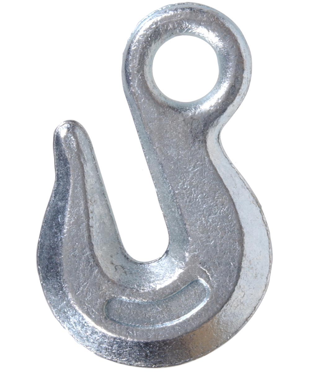

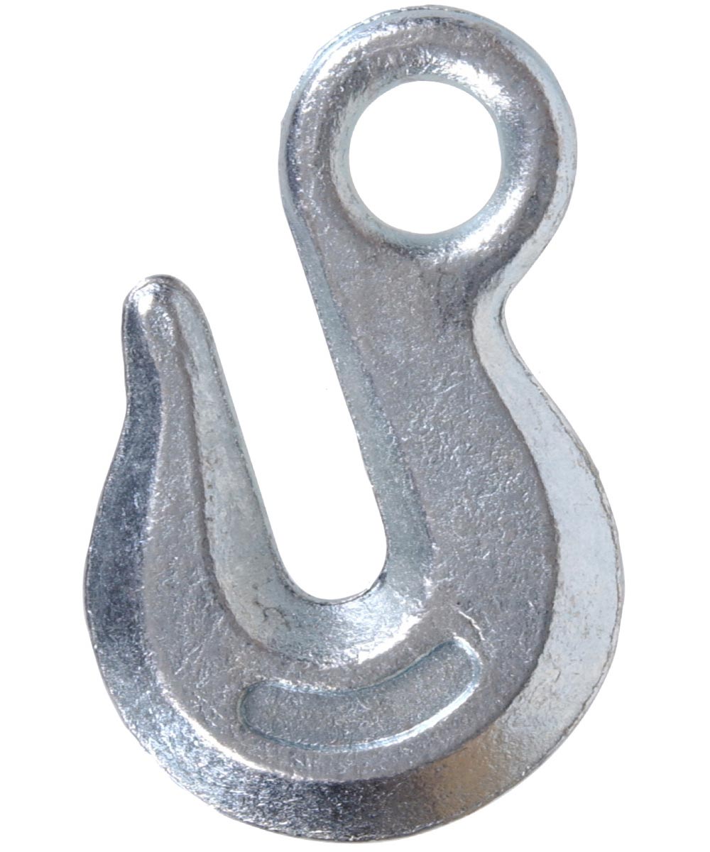

I use a simple chain hook and a single triple twist nylon line. One issue I have with the hook is that I sometimes have difficulty attaching it to the chain that has already passed through the bow roller- its a reaching/stretching issue over the bow seat and down to the chain. The other issue is that under light air, low current conditions, somehow the chain hook becomes unattached after anchoring. Since the chain hangs on the chain hook, I don't understand how this can happen, but it does.
I use one like pictured here with a shackle and a 15 foot 3/4" line with a stainless steel thimble.
Rich,
Thanks for the input. You are not the first person to tell me about the hooks - unhooking. I think safer to use an attachment that can't fall off. Have you ever tried tying a line to the chain?
dj

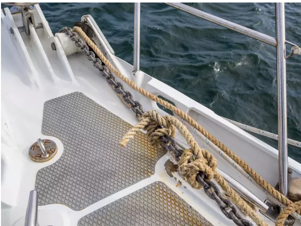

For those that use the Mantus pendant or other knot style arrangement, how easy is that to undo in a hurry? I like the idea to keep the anchor tension off the windlass, but taking it off to pull the rode through the gypsy looks challenging to me.
Excellent question.
Explain more about why you want to remove it in a hurry? What are the circumstances and what are you trying to accomplish?

No I haven't tried tying a line to the chain. But I don't think I ever would do that for two reasons-
First, it looks cumbersome and time consuming.
Second, The function of the snubber is to absorb shock, and in a blow, I would be concerned about the line slipping on the chain or somehow disconnecting. We all argue (or discuss) the merits of having 3900# chain with shackle strength to match, and a snubber of the appropriate size to match the other strengths, and now there is the suggestion to tie the snubber line to the chain. I'm trying to think of a knot that would be appropriate to keep the overall strength of the anchoring system......
As for my hook dropping off the chain, it only happens in calm conditions, so unless the weather changes dramatically, I think I am good.

Excellent question.
dj
Mostly I’d be worried about if the anchor were dragging at night in a passing storm. Trying to undo both the shackle to the snubber and the knot on the rode while the bow is bouncing in the dark doesn’t sound like my idea of fun. I could think of other times where a quick getaway might be good, like in a crowded anchorage if someone well upwind is dragging and starting a domino effect. Mantus certainly charges plenty for that pendant and at least some people seem to like the idea, so I’m just wondering if I’m missing something.
So if you are dragging at night, are you raising the anchor or setting out more scope to stop the dragging? I can certainly see if you are pulling the anchor how you'd not be happy, but wouldn't you rather be adding more scope?
I'm not sure in the crowded anchorage, if time's of the essence, I might put a float on the end of the anchor line and drop everything in the water to come back for it later. If I have the time, I certainly want to pull the anchor in and for sure, I'd want to be able to stow everything in a hurry. In that case, with a tied snubber, I'd want to know ahead of time if it just passed tied right into my locker. So that means the knot needs to be such that it enters the chain hawser into the locker. I think that might be a problem, but for sure with hardware even less likely. That certainly speaks for the hook, darned easy to pull off and keep bringing the whole thing in...
By the way, there is no shackle on a tied snubber. Unless you are using the system that dlochner is talking about....
No matter, your scenarios must be thought of ahead of time and practiced to see how best to handle them.
The double rolling hitch.
