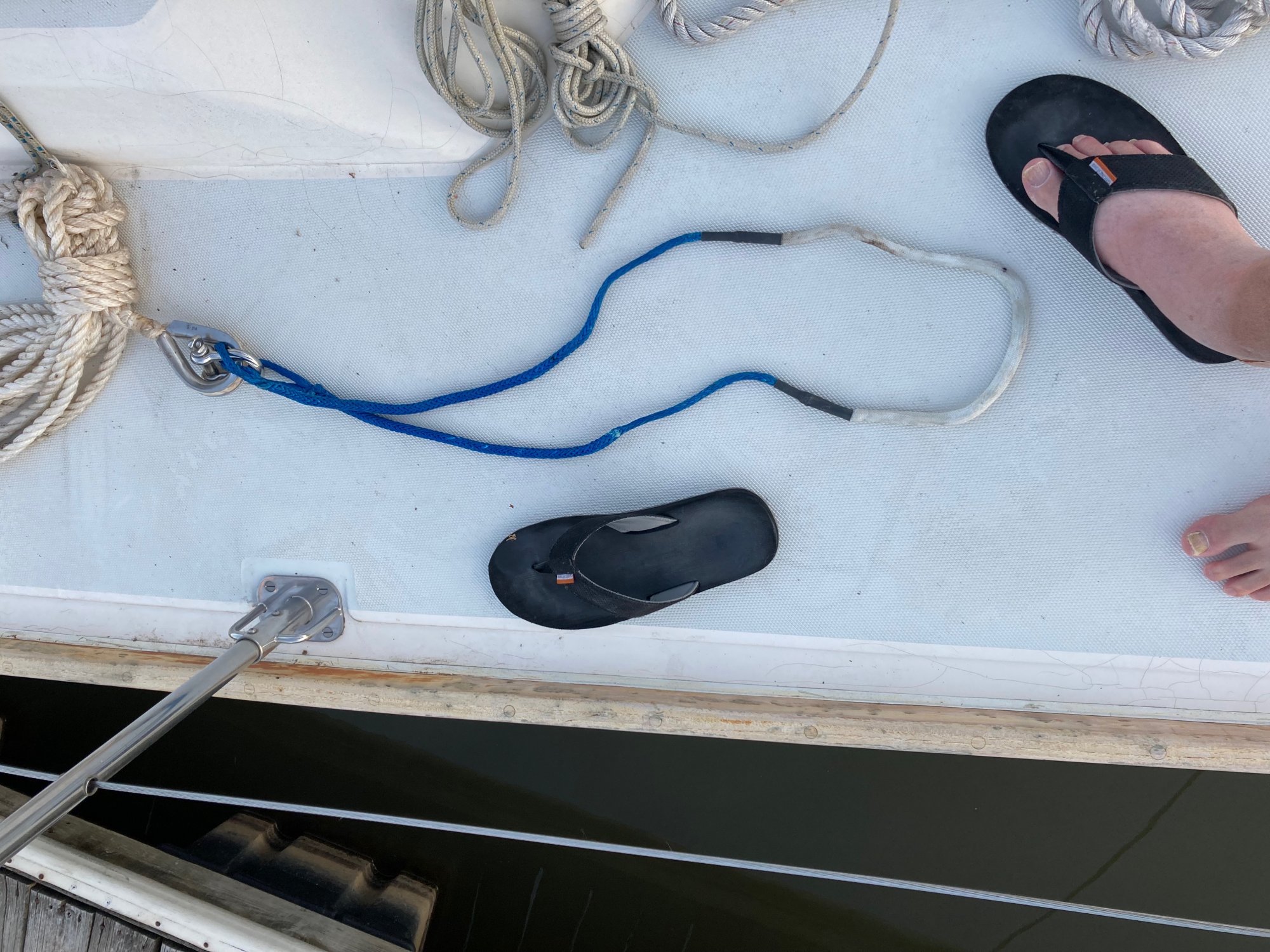

@dLj Here's the photo. For size reference the flip-flop is a size 11.
This will go through a gypsy easily and depending on where the chain goes, in to a hawse pipe or just in to a locker there is no need to remove it if time is an issue.
@dlochner Are you fastening this to the chain almost like the prusik hitch that @thinwater posted above?
dj
14,252
dj
Yes. A Prussik knot is sort of like a cow hitch with more wraps. On rope the extra wraps are necessary to develop enough friction. On chain the shape of the chain and the links hold with only one wrap. If you check the Mantus site their instructions for using the pendant on rope is to add wraps, in the same manner as a Prussik knot.
The Prussik knot is handy on a boat. For example, it can be used to take a load off a sheet to free a foul wrap. @thinwater is considerably more knowledgeable about knots like the Prussik.

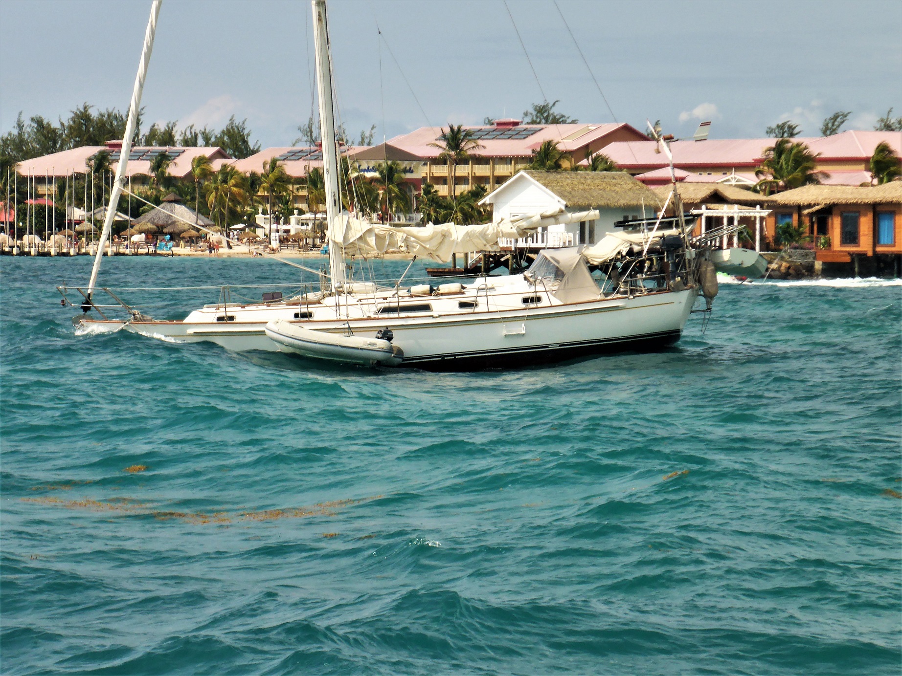

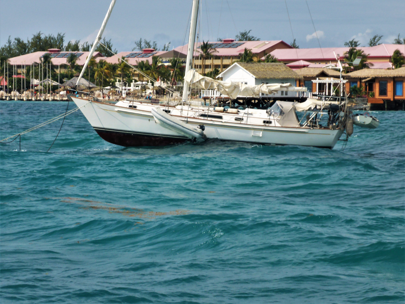

Most of my experiences have been in the dark and the wind shifts to blow into the anchorage. The seas get up pretty quickly, and one must be on the foredeck while it might be dipping under each wave. Staying aboard is of some concern, but trying to untie a knot that has really tightened on the chain seems dangerous and unnecessary.

Agreed. The question is, are you pulling in the anchor and resetting, or, it seems to me, you are more likely putting out more scope. Now some say, you put out a second anchor, but honestly, at this point I think you're too late... I've been in some mighty tough blows and I've no idea how I would have been able to set a second anchor. I guess with enough room, I could drop a second one while the first one is dragging and at some point I'd have enough scope on both, I guess. But that just doesn't seem like that's going to be a realistic solution.
Personally, I'm much more worried about that up wind boat dragging down on me. If necessary, I can drop all my chain and buoy the end with a fender and be gone in a minute or two.
Again also in agreement. Here is where I think the secured snubber is better. You can simply drop both and go, and you won't loose your snubber. With a hook, you'd have to pull in the anchor line, unhook, then drop the system. Heck at that point just pull in the system. But there's the problem, we're talking you don't have the time...
But if you were to decide to let out more scope in a messy situation, you would have to lay on your chain alone while you untie the snub. With a hook it comes right up over the roller and can literally be disconnected from the chain in an instant and you are able to let out that scope immediately.
Now we disagree. Here's the advantage of the tied on snubber - you simply let out more scope. You don't have to bring in anything, no unhooking hooks, just let out more scope. Now, if your snubber is not long enough, you can simply tie more line onto the end and let it out.
