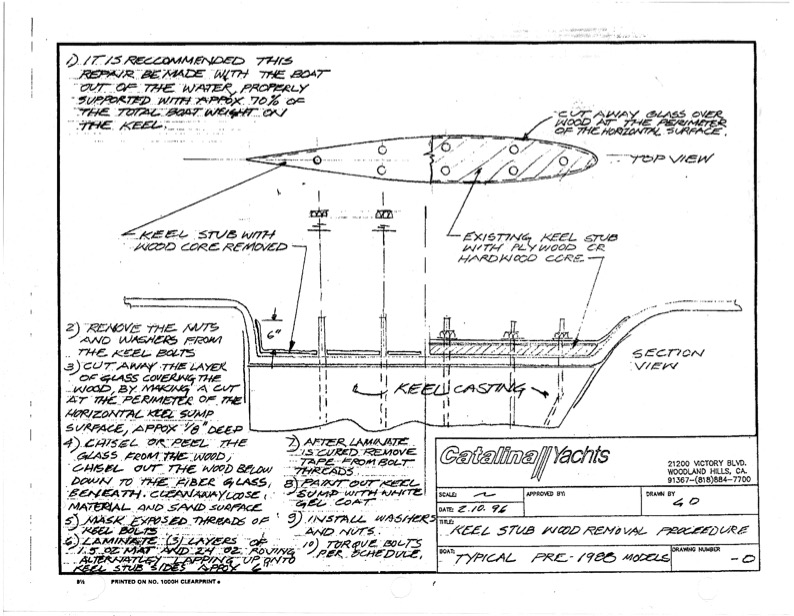

The diver who cleans my boat said he could see a Cat Smile in the front of the keel. Does not wrap around. He says he can see the lead. The boat leaks in excess of 5 gallons per 24 hours. I don't know how much because I check it and use a shop vac in the morning before work, and in the evening after work. I have no idea if, or how many times, the bilge pumps out water. The diver does not see any damage to the boat. I am just guessing that it is leaking through the keel bolts. I will vaccum it completely, dry it with towels, and put paper towels on each of the bolts to see if I have a winner. Don't really know what else to do. Wish I could hoist it up sooner than March 1.
I certainly would like to try Pirate Dave's idea of hoisting it up. loosening the bolts, digging out the wood, tightening the bolts and patching the outside.

Don't go in through the bilge if the boat is on the hard. The fix isn't really bad on the hard. Get the boat up in the travel lift for a few hours and drop the keel a little bit by loosening the keel bolts. Dig out the we wood , replace and torque the bolts back down once they re block the keel. I have done a few of these and helped with others

When you confirm that water is entering the bilge from around 1 or more keel bolts. I would dry the bilge, then build a small dam of plumbers putty around the keel bolts to see if water builds up inside the dams or outside. With the amount of water you're finding in the bilge, it shouldn't take long to confirm it is or isn't coming from up around the keel bolts. If it is, then you probably need to do the repair IF YOUR BOAT IS PRE 1988 MODEL YEAR. Starting in 88 and newer boats, they stopped using plywood.
Also if you notice sagging of the bilge floor due to the wood becoming rotted and no longer supporting the bilge floor.
Another sign may be if you fix the smile by grinding out the crack, filling and fairing properly and the smile returns.
