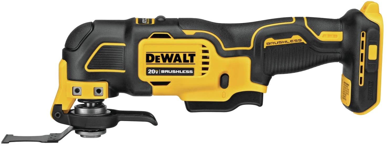

Maybe an oscillating multi tool to clean out the old material? Probably safer and more controllable than a chain saw.
That is what I was going to say. I love mine. Got it for X-mas two years ago and find myself using ALL the time.
Something along this line of thinking... GO CHORDLESS
