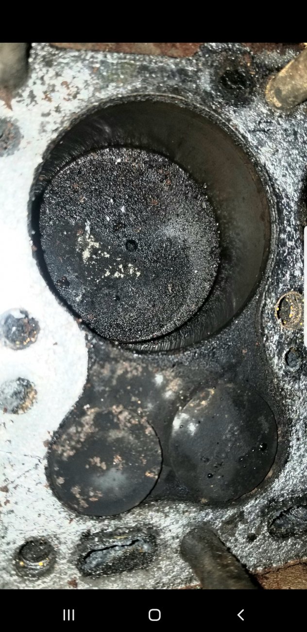

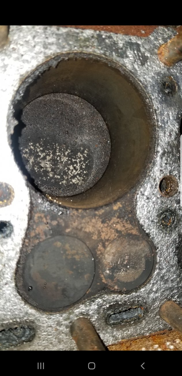

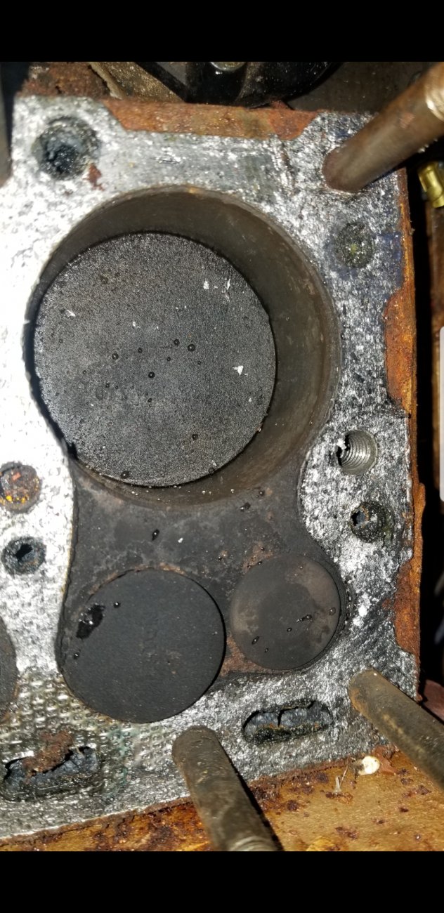

Hey everyone, looking for a little insight here again. I've removed the head on the A4 and inspected the cylinder walls and valves. Lots of carbon build up and it looks like oil may have been burning?
My specific concern is... I talked to a mechanic who may be helping me out with moving and dealing with a 300lb engine... and I sent him photos and a video of the cylinders in my current A4... and his opinion is that the cylinder walls are scored and in bad shape
I couldn't feel much when I ran my fingers around. I thought this looked a bit ugly but certainly didn't look "destroyed". Note, I didn't clean the cylinder walls before recording the video or taking photos. You're seeing some water droplets and debris too.
Any thoughts here? Are the cylinder walls clearly showing signs that the rings and condition is bad? And not worth using unless it's machined?

I can't tell from the pic's but I don't think the cylinder walls look scored. I think that mess is due to a head gasket leak. Just my opinion.
No way to tell unless you take the pistons out. If it were mine I would take it to a mom and pop machine shop (one that works on gas motors) they would know just by looking at it. Have them clean it up, also the crank, pistons, etc. It still will be cheaper then doing a complete motor swap unless you have a rebuilt A4 that you got cheap, and I mean real cheap.

If your going to do valves I would also recommend rings and bearings. You don’t know if low compression is valves or rings. Some of those look oily so I would suspect rings.
Cylinders didn’t look bad - a bit of glaze which removes easy.

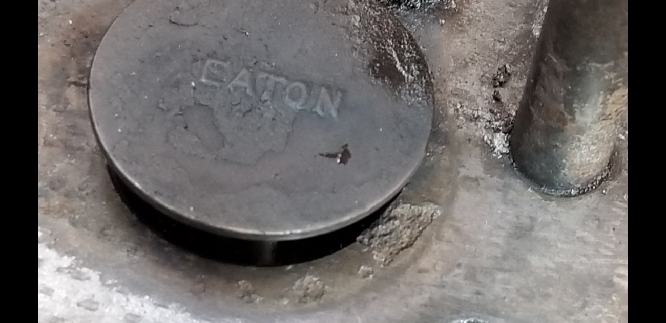

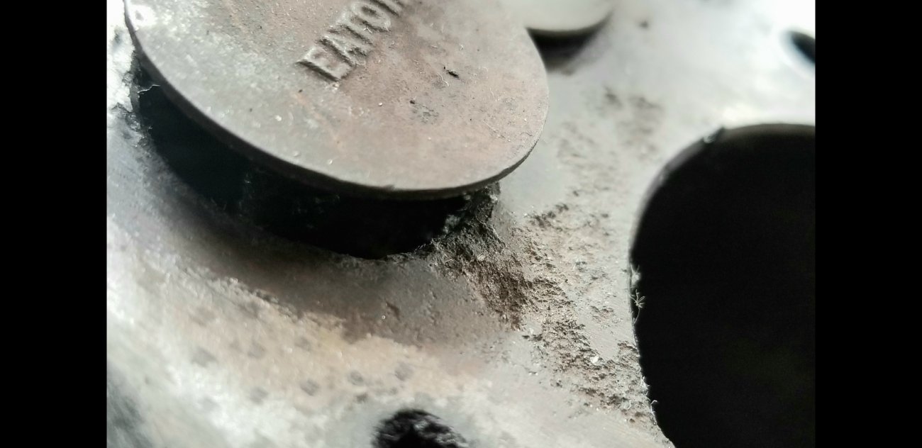

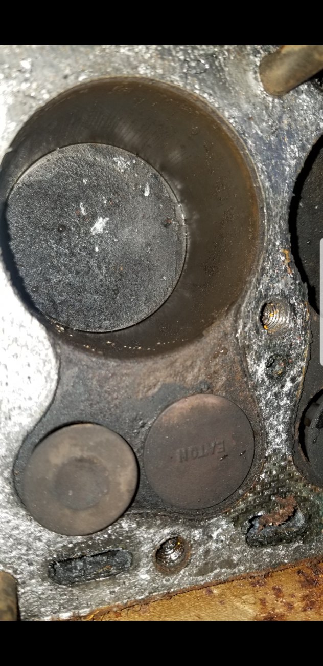

I think I've found why I've got no compression. I finally got around to cleaning up the deck... should of got to this much earlier.. but it's clear the valve seats are burnt and pitted severely. If the valves don't seal, there's no compression. Guessing they ran the engine too hot and the carbon build up gradually cooked it.
The block needs to be machined. That's likely to be cost prohibitive. May be the end of the chapter on this engine.
Anyone ever seen it this bad?

Well Newbie I think you are right. Those valve seats look bad, I'm not sure but they look beyond machineing.

If the engine is out of the boat, you might want to run it down to your local machine shop. They can re-seat the engine to repair that. It is worth a look-see by a professional who can tell you what it would actually cost.
Ah yes- to follow up on this...
I called around to 5 or 6 machine shops this morning. Almost nobody has the equipment to machine valve seats on a flat head engine anymore. Everyone has moved on to machining valves on heads which I'm told is done on different equipment. I did get referrals to shops who could potentially do it, but they all refused the work.
They said that from their past experiences, they are highly likely to strike water due to water jacket and other corrosion.
But yes, they confirmed that this block can in theory be machined by drilling out and installing new valve seats.
I'm going to pivot to cracking the engine mounts loose today. Looks like it's coming out no matter what.
