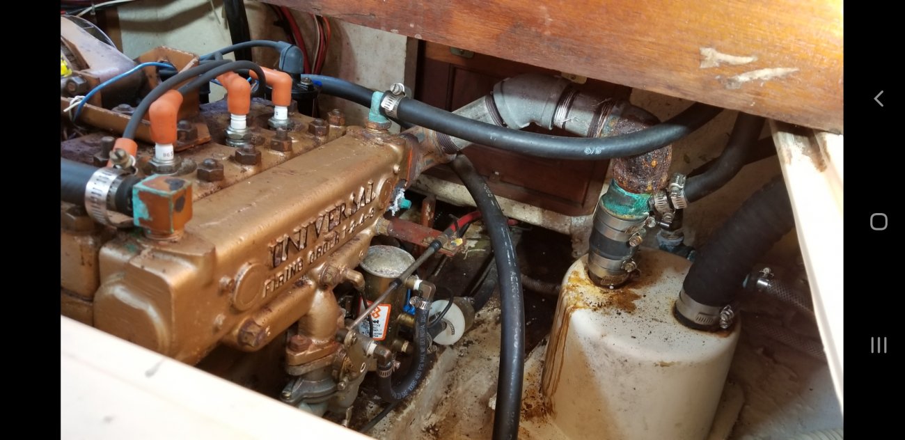

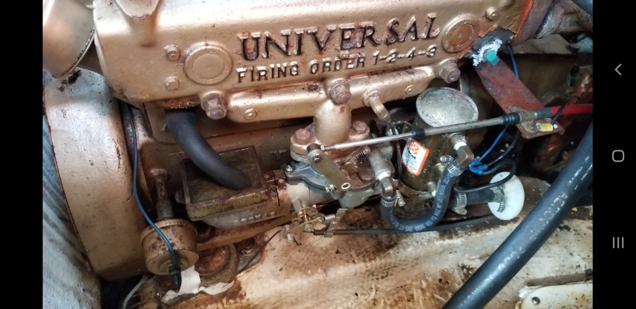

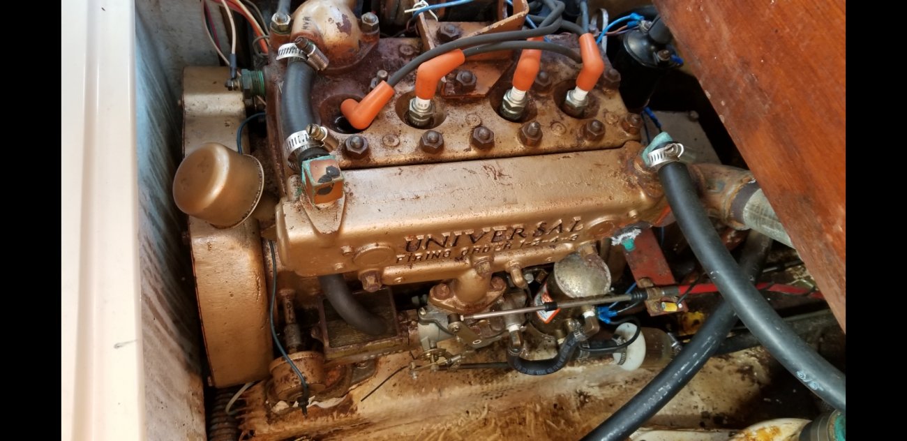

In one of the photos just posted, there is a clear picture of the exhaust pipe from the exhaust manifold. There are a couple of issues I see there. First the the parts look to be off the shelf galvanized pipe connected to a black iron elbow with teflon tape used in the joints.
I'm not sure that galvanized pipe if the correct material. When I replaced a similar part on a diesel, it was made of black iron. Someone with a better understanding of the virtues of black iron and galvanized pipe might be able to weigh in with a more reasoned explanation about using galvanized or black iron. My inclination is to replace it all with black iron. The problem is the hot exhaust gasses what effect those gases might have on the pipe.
What I am sure of is the use of teflon tape and the lack of pipe insulation. The pipe threads should be coated with a high temperature pipe dope as the pipe will get very hot from the exhaust gas. Something like Bostik's Marine Never-Seez will work. (The link is to a large can, shop around it comes in smaller containers).
Next, the pipe will get exceptionally hot. It should be wrapped in a fiberglass insulation tape. Something like this tape: https://amzn.to/3034w4V It can also be found in local auto parts stores. In the old days, this part was wrapped in asbestos tape.
If you buy this boat, these should be corrected. The fix is pretty straightforward and not all that expensive.

Based on the fuzz around the drain plug at the back of the manifold, it looks like there may be some corrosion going on. IF you have trouble with overheating or restricted water flow, check the pump first but if that looks ok then it is likely restrictions in the manifold due to corrosion. I was having overheating problems on mine and then one day found water in the carburetor. The water jacket in the manifold rotted through and it was leaking into the intake. The manifold is all in one, intake and exhaust plus it is water cooled. It is a really easy replacement if all the nuts and bolts aren't frozen. I got lucky, everything came out with generous application of liquid wrench. I rebuilt the carb while it was off.
I actually kind of like working on that engine. Don't judge me, I know it's a problem.

Yeah that elbow caught my eye for sure. If I can get compression back I'll certainly clean the rest up too.

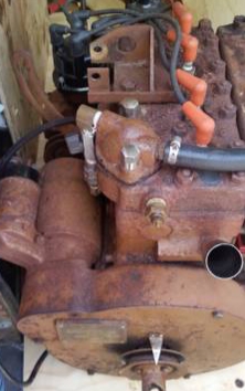

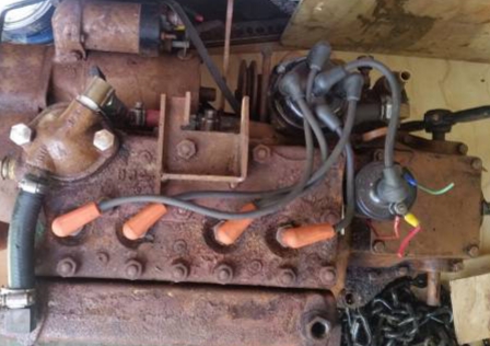

I've been looking for A4 engines in case I need parts. Found one which the current owner says ran a month ago. I'm told it only has a bit over 500 hrs on it. It looks like it has been sitting on the bottom of the ocean... lots of corrosion.
I'll pick it up in case it turns out to be the better candidate for a rebuild.
