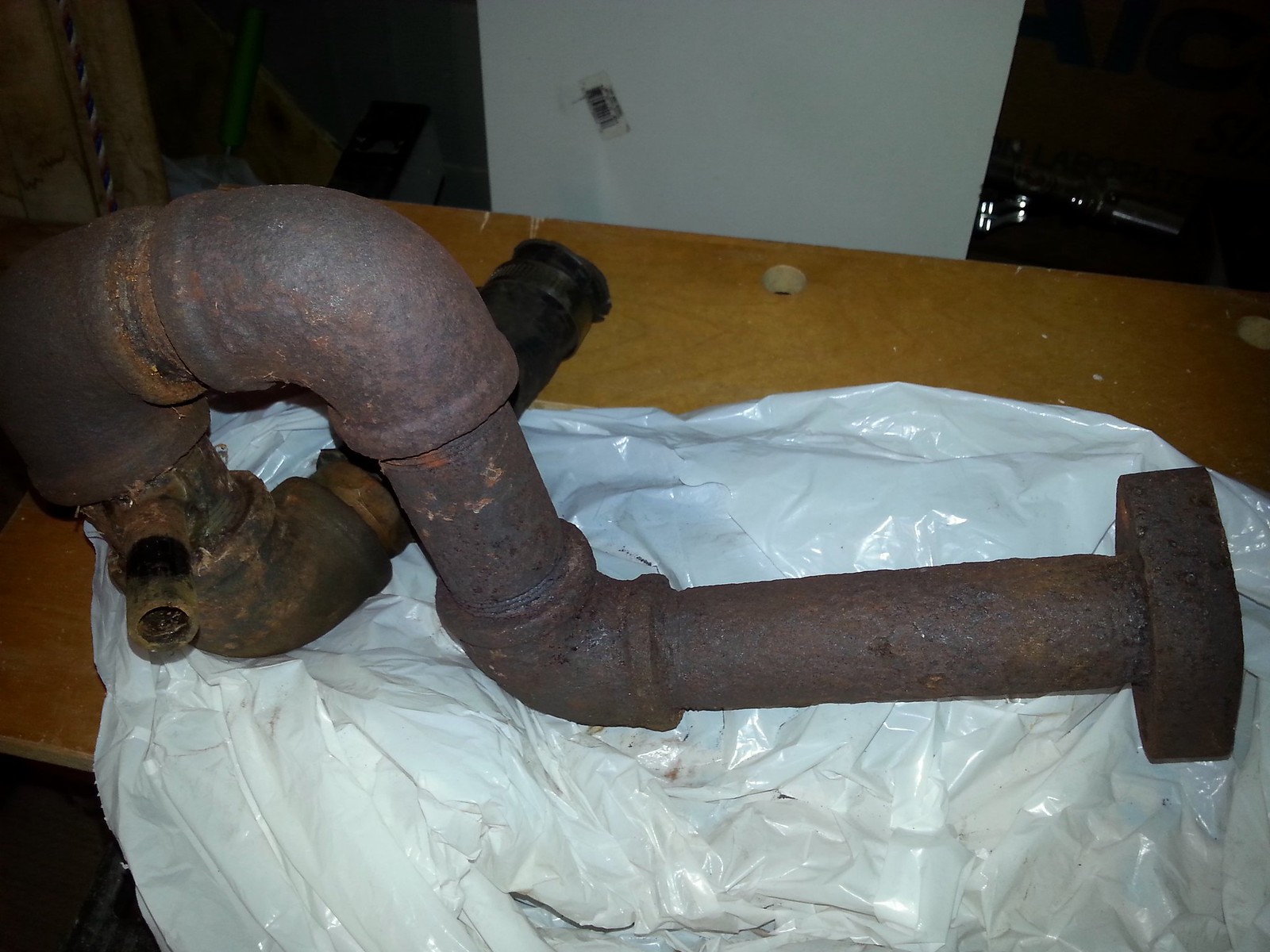

That exhaust pipe is galvanized and needs to be replaced. Catalina did that in the 70's. My 27 had the same thing. The pipe eventually was backing up the exhaust killing the engine every five minutes. Shut down the engine for a minute and it was fine. Also check your through hulls. Catalina put in gated valves in that era as well. The other thing you may want to do is replace the plate on the engine on the starter side. That plate sometimes lets go and leaks like swiss cheese, spraying water on the starter and altenator.
4,152
Sabre also built their own exhaust pipes out of standard 1 ¼" black iron pipe back in those days. Eventually they fail either by clogging or rusting out. The big box hardware stores have the pipe and fittings.

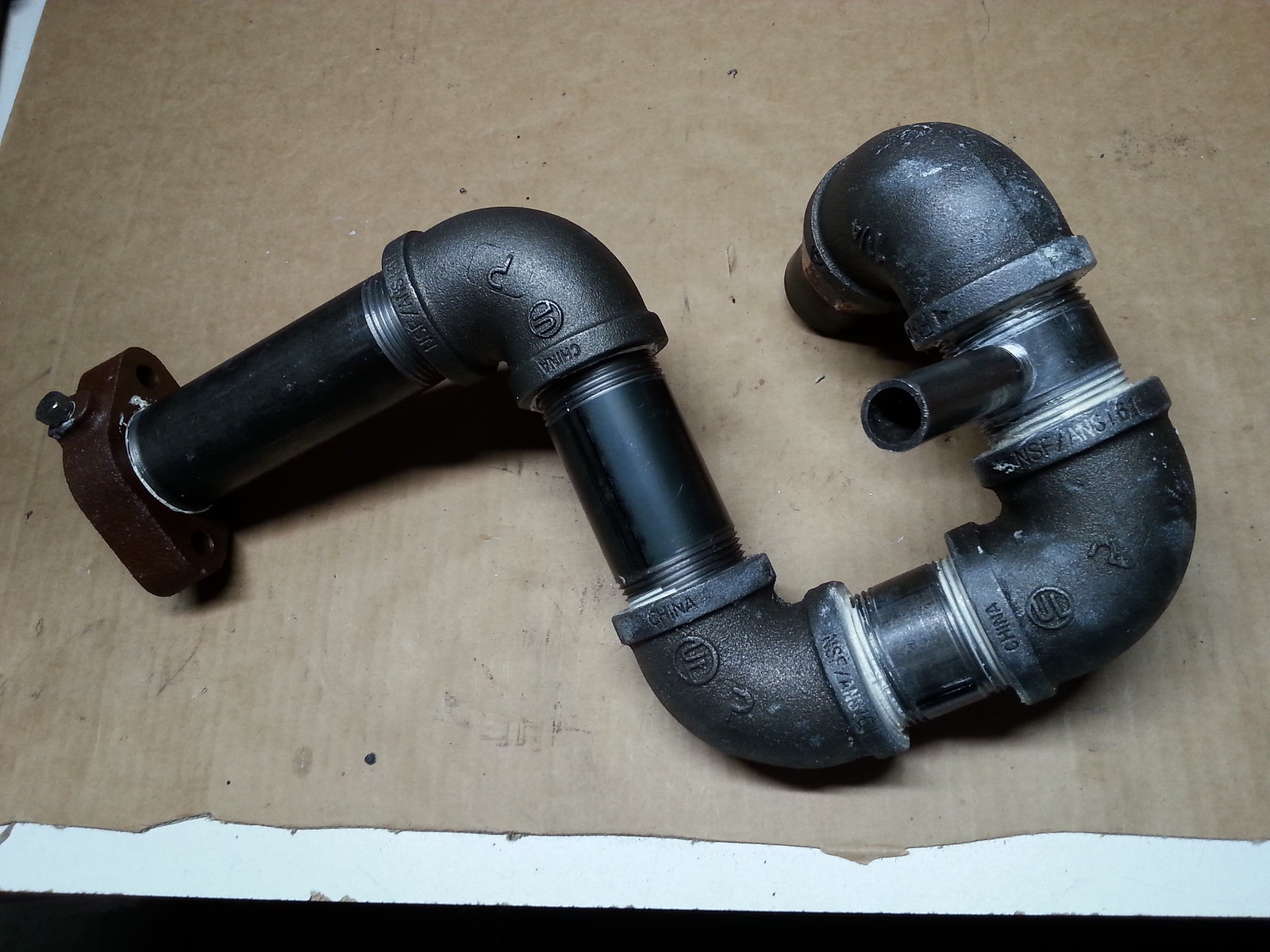

That galvanized exhaust looks better than mine did (after 43 years)
The exhaust flange came from Moyer Marine and the local plumbing supply store had the rest of parts I needed to put it back together. I did add fiberglass wrap after installing, which came from Amazon.

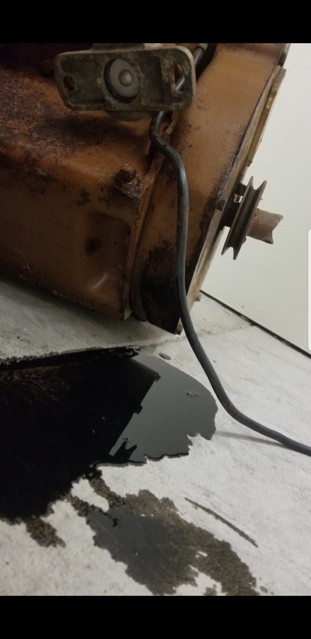

Did a compression test on the replacement A4... came to be about 120 in all cylinders! I decided to buy it.
There's an oil drain plug in the front of the engine, right? It leaked oil there as soon as I put it down.
