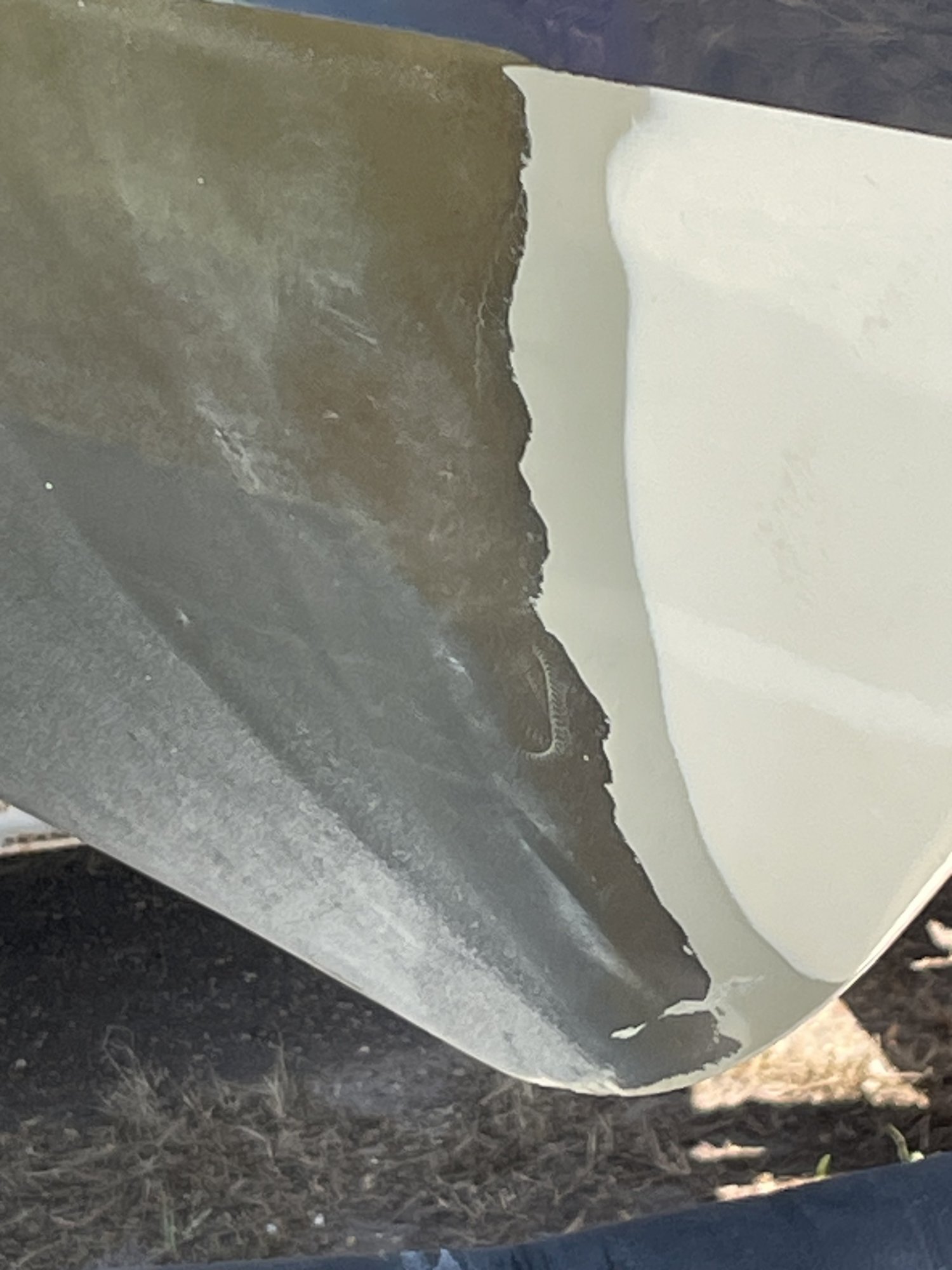

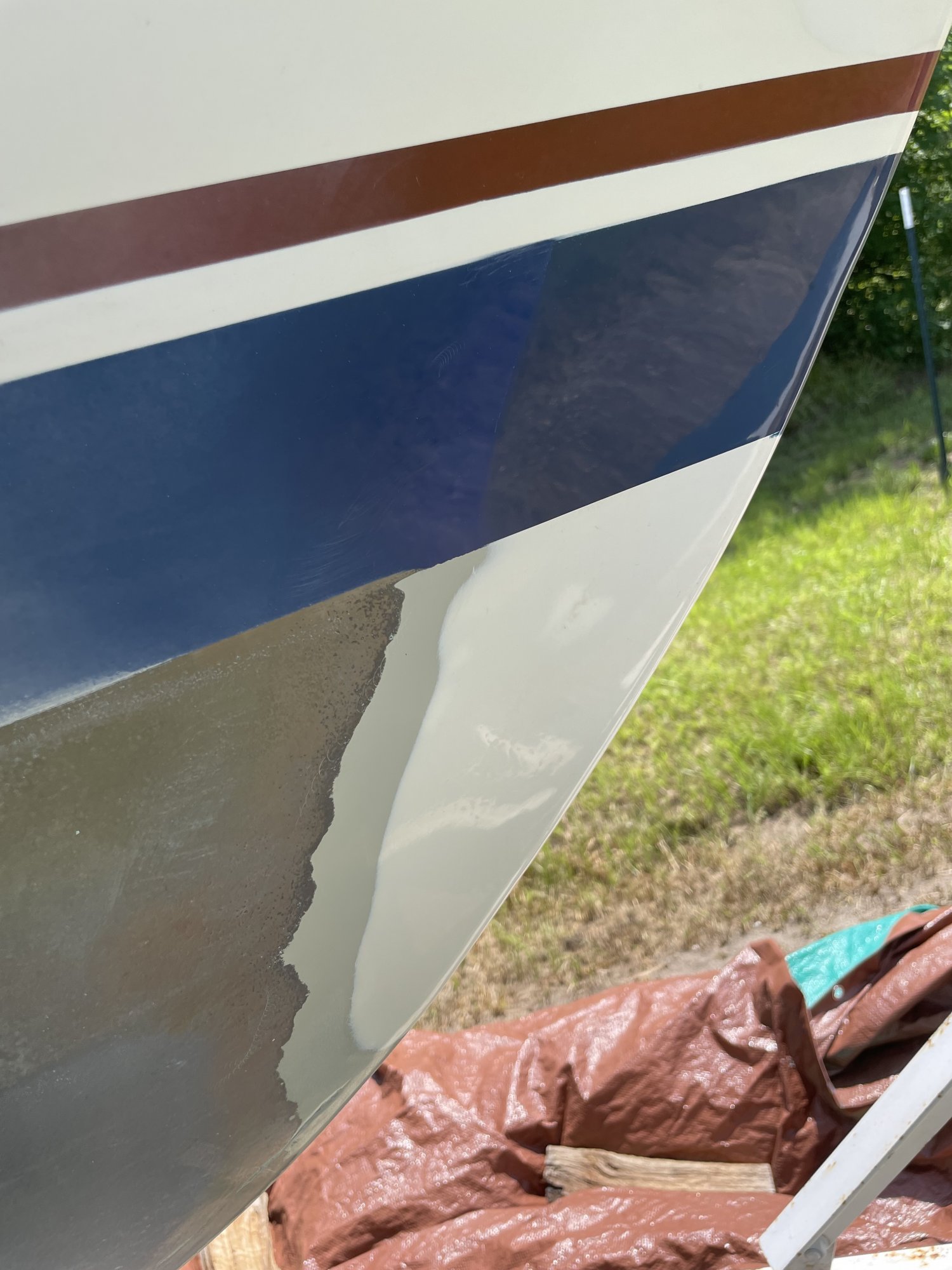

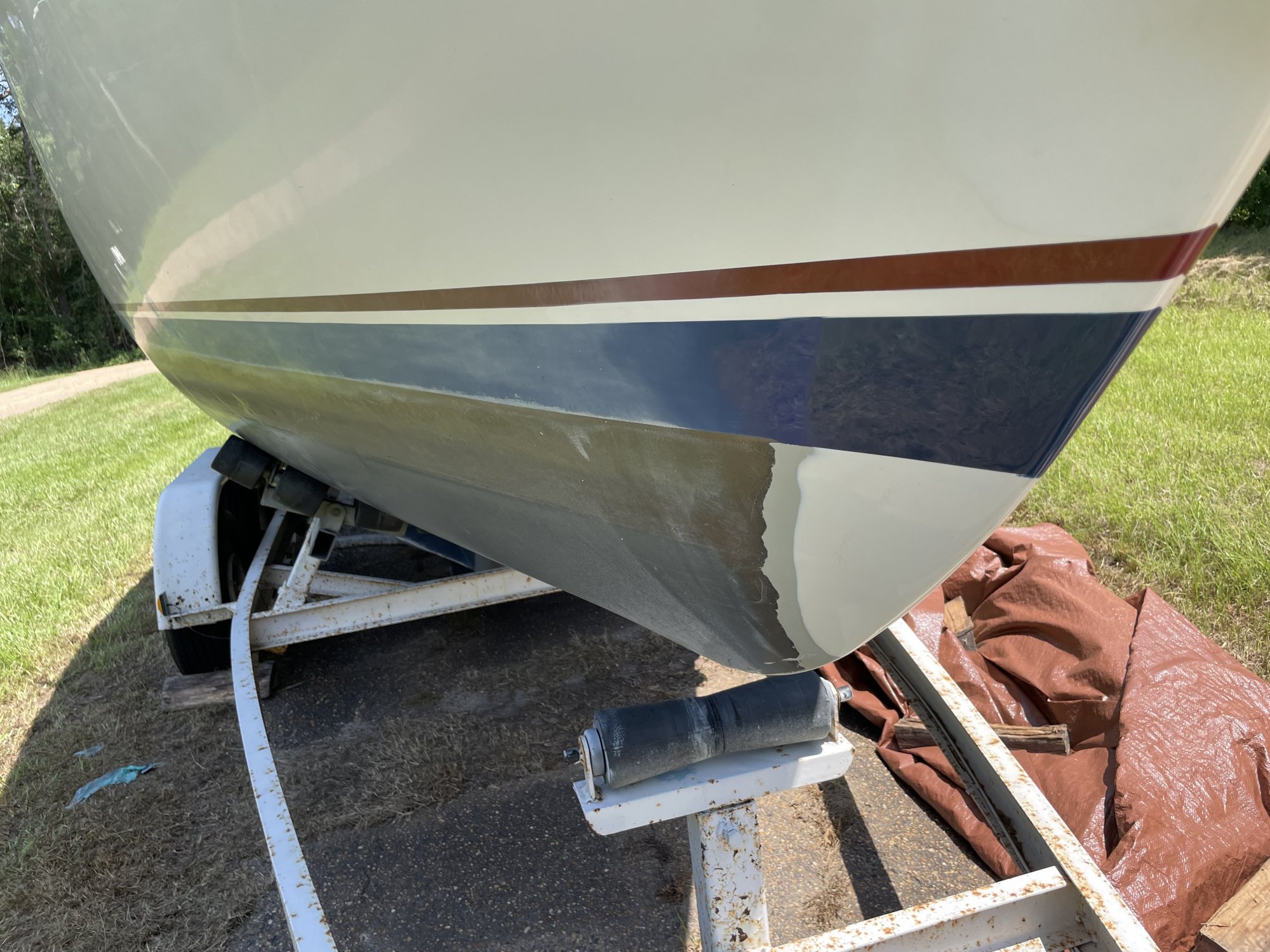

Just picked up new to me 1988 Catalina 25 on a trailer. I'm believe I'm the 4th owner. The PO didn't really understand sailing or boat maintenance and the owner before him was an older lady that either didn't share or he didn't know the questions to ask. We believe the boat has been in freshwater all her life. We don't know the last time the bottom was painted or the type (if any) barrier coat that was applied. There was apparently some work done on the lower bow, I waS told dock rash. Hopefully, the pictures will help us understand what has been done and the next appropriate steps.
I believe I need to do the following. Please provide recommendations/guidance as appropriate. I plan on doing the work myself.
1) Apply barrier coat
- not sure if there was a barrier coat but from the pictures of the point of the bow I'm assuming the white gelcoat is covered/painted by a light grey coat (barrier ???) and then a darker gray layer (bottom paint ???) . The darker gray layer actually looks like the blue bottom hull color further along the boat. The exterior of the boat (above the waterline and below the waterline look excellent and smooth; obviously above the waterline is smooth like glass but below the waterline it's still smooth).
- do I need to sand down to the white gelcoat looking layer (I would prefer not to damage or harm the existing layers as they look really good but on the other hand I believe I need a barrier coat since the boat is a 1988 and it appears as if nothing has been done since)
- I'm assuming I would sand up to the bottom on the blue stripe below the red boot stripe?
- use a quality epoxy barrier coat and following vendors instructions
2) Apply bottom paint
- use a quality bottom coat and follow vendors instructions
3) Polish the gelcoat above the red boot stripe to the cove stripe below the rub rail.
Sure appreciate any advice/guidance ya'll have. I'm operating in the dark here and appreciate ya'lls knowledge and experience. Thanks in advance.

Why would you want to remove a perfectly good barrier coat ? ? ? ?
They don't have a limited life expectancy and you'll have one hell of a time trying to "maintain it" whatever that may mean or consist of ? ? ? ? ?
The boat has been on a trailer. What you've got now is a heavy duty bottom for permanent moorage in salt water.
If the barrier coat is in good shape and yours looks to be good , it's there for life. Any blisters ? No ? Then it's done a good job over the years and will continue to do the same job.
Determine what the existing bottom coat is. If it's hard, it will take any bottom paint. If it's soft, time for some research as to whether you want to go hard or soft.
Before you do anything, may I suggest you do some research on boat bottoms. There's a lot to be learned, the work is ass busting, filthy, and expensive. Check this site all the way to West Marine for articles on bottom paints. It would break my heart to hear that you've dug into what looks like a perfectly good barrier coat with the intention of replacing it.

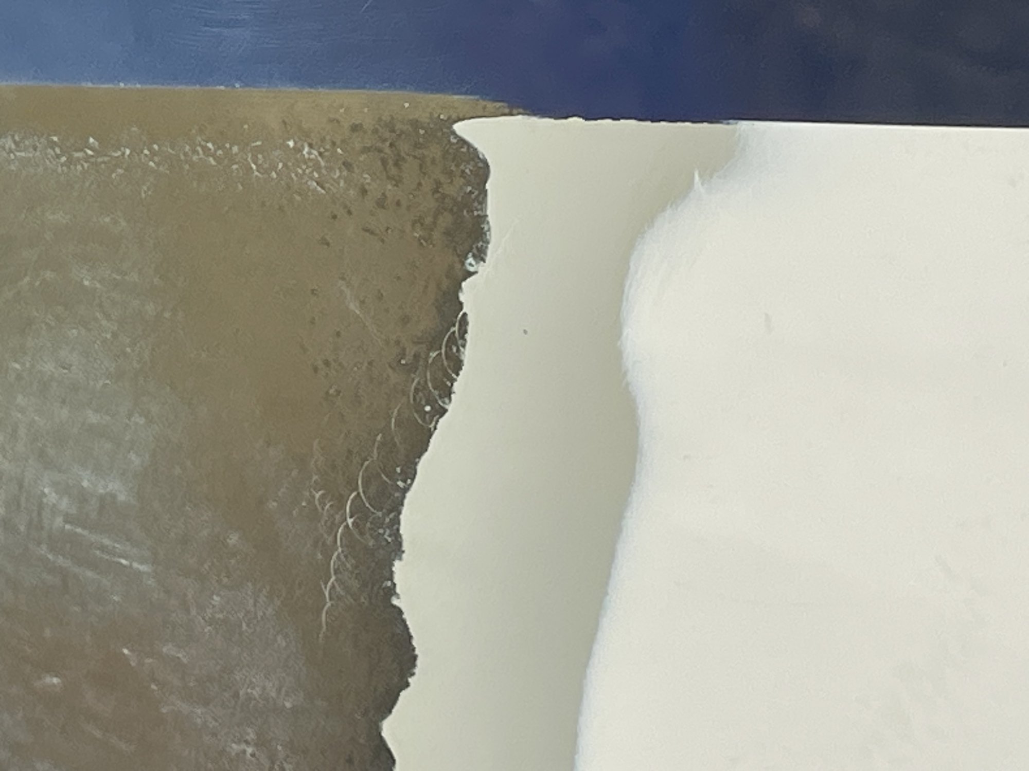

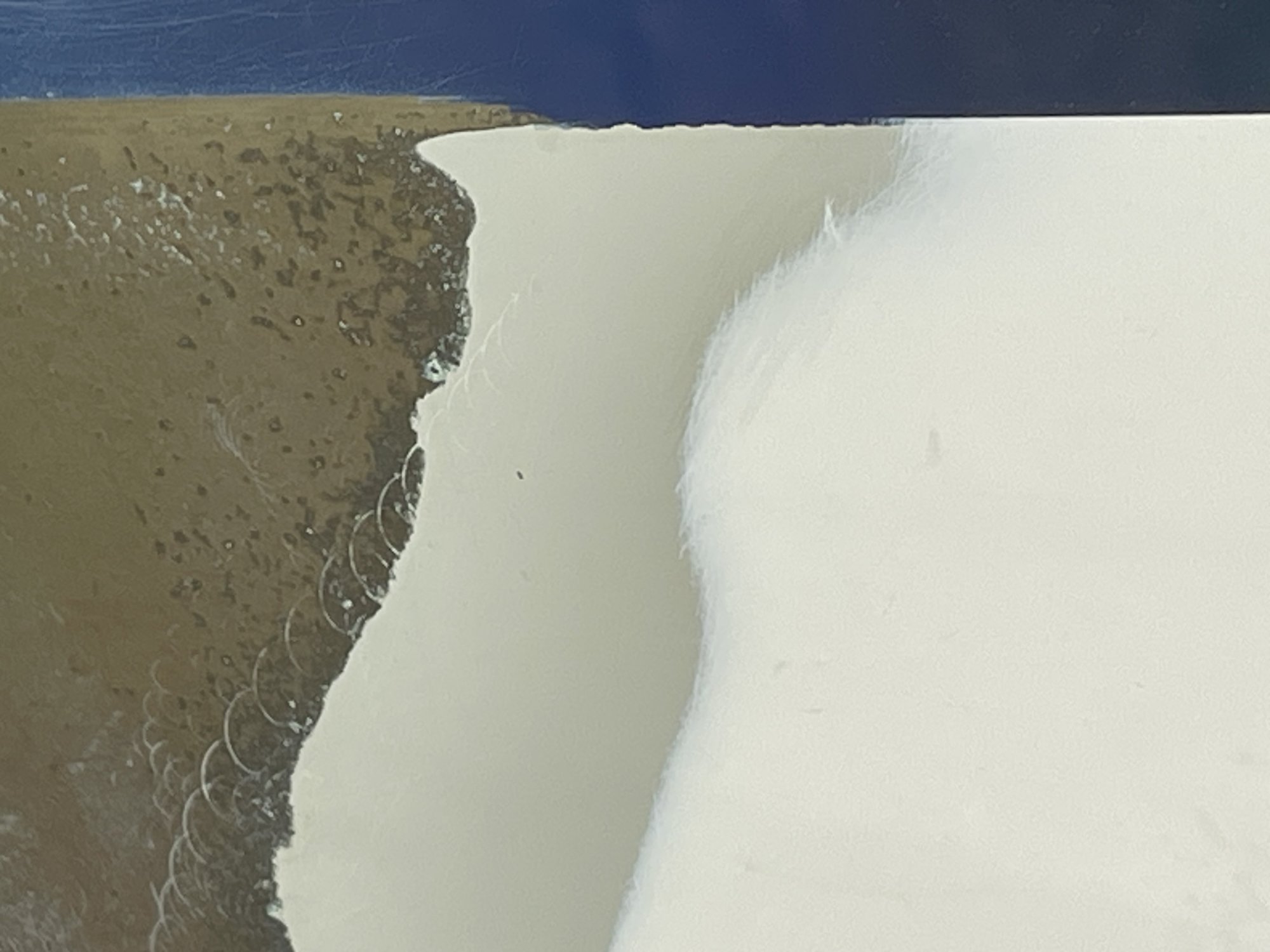

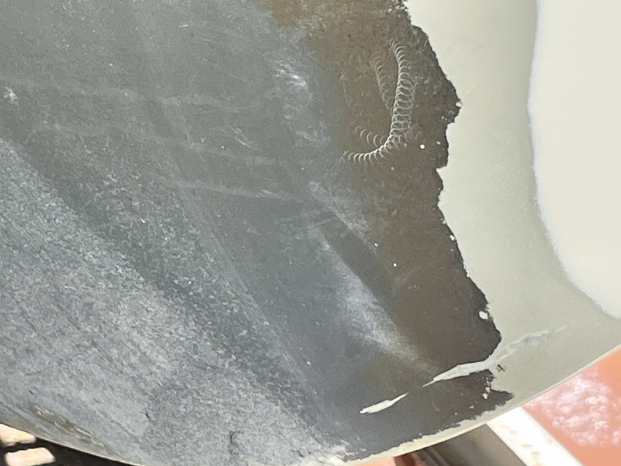

Ok. In my opinion.
The blue stripe looks like original blue gelcoat.
The white area above the blue strip looks like the original white gelcoat.
Beneath the blue strip is the hull the dark grey is the outside fiberglass hull. The gelcoat for this area appears to have been stripped. You would need to paint this dark grey with at least 2 to 3 layers of epoxy barrier coat.
At the bow you can see how the hull was laid up. After spraying the mold with a release agent they applied a thick gelcoat white layer. It is evident on the bow.
Next they sprayed a light grey gelcoat, or a vinyl-ester resin coat. Next they sprayed chopped mat dark grey fiberglas and resin. This formed the base of the hull.
You need to replace these two outer layers. You do that with 2-3 coats of barrier epoxy paint. This barrier coat provides a smooth water proof layer. Then you apply your ablative bottom paint on top of the barrier paint..

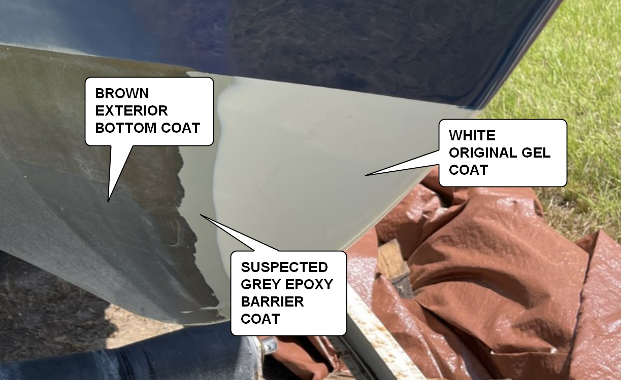

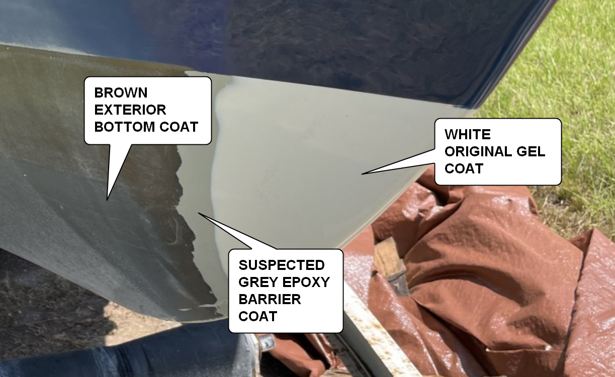

@rcoleman67 , do I have this labelled correctly ?
If the boat is to be trailered, I would ignore the small section of bare FG which you have exposed and just bottom paint it. If you're a perfectionist, epoxy it.
If the boat was in freshwater the brown bottom paint is probably VC17. To test, take some solvent, acetone or denatured alcohol and wipe it on the paint, VC 17 will become copper colored, because is it powdered copper suspended in a teflon like film. The good news it is a very low maintenance paint and I wouldn't worry about it. The bad news if the boat is moored in saltwater VC17 is useless, it is a freshwater only paint.
The gray area is likely barrier coat. No need to remove it unless there are lots of blisters on the hull.
The white area is probably gelcoat. You mentioned there was some fiberglass or gelcoat work done on the bow, that would explain the different colors. The white is the new gelcoat. There is no need to put barrier coat on it, but I probably would put a couple of coats because the epoxy barrier coat is tougher and harder than gel coat. The bow will come in contact with all sorts of floating debris and the tougher barrier coat will resist scratches better.
Whatever you decide to do with the white area, bottom paint or barrier coat, it needs to be cleaned with a dewaxer. In order to get gelcoat to cure it must be cut off from any oxygen. Wax is added to the gelcoat to accomplish this. The was floats to the top of the gelcoat and seals it. Once the gelcoat is fully cured the wax only serves the purpose of preventing paint from sticking.

As a former Catalina dealer, I recall grey gelcoat was the norm on the Catalina 25 and 22 hulls about that time. Run your hand, over the grey. Is it smooth or bumpy? If bumpy, then it is probably barrier coat. However,, there were some of those boats that developed pit blisters due to defective grey gelcoat. Frank Butler was surprised about defective gel coat when I told him.
pictures can tell you a lot but I suggest a local yard look if you are not sure. When you respond back, please get my attention.
Be careful unloading and loading onto the trailer. I have seen the bow being damaged by the support trailer bow roller Aloso make sure the swing keel
Is winched up loadin/unloading fro trailer. When on the trailer make sure the swing keel is down on the keel tray
