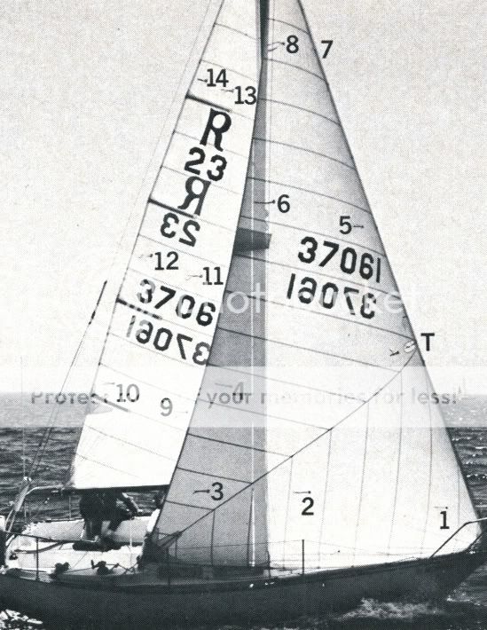

So while we are on the subject, I do have lower telltails on the jib. There is only one set on the luff in the lower third. Often I find the lower windward tell tail flying nearly straight up. (this is without any significant heal) Not sure what that means other than I have wind shooting up the sail instead of flowing aft.
With the sail attached onto a furling foil, the foil having thickness and apparent 'roundness', the tell tale very close to the leading edge of the sail, what you are probably seeing is the action of the foil disturbing the flow of air and creating a small wind turbulance 'rotor' directly downstream (normal air flow) of the foil ... plus a slight heel to the boat which tends to distort the normal air flow to go 'up' along the sail as well as aft.
The normal aerodynamic 'circulation flow' around a sail also contributes to this leading edge turbulence effect - especially seen just behind 'thick furler foils' and sails that are partly rolled up on the foil .... and sails that have a 'roundness' to their luff shape.
With a hanked on sail or a sail held in a well aerodynamically shaped foil (tuff luff, etc.) and with a racing cut (non-rounded luff shape) this anomaly will be greatly lessened. In your case, the round or thick foil itself is probably acting as a totally independent lifting surface.
Rx: move your tell tales slightly back and away from leading edge by several inches.
For a more 'precise' way to set up tell tales, especially look at where tales 9, 11, 13 are set-up (on the mainsail, and in proximity to the leech of the jib !!!) ... and approximately how far the tales are from the leading edge of the jib
