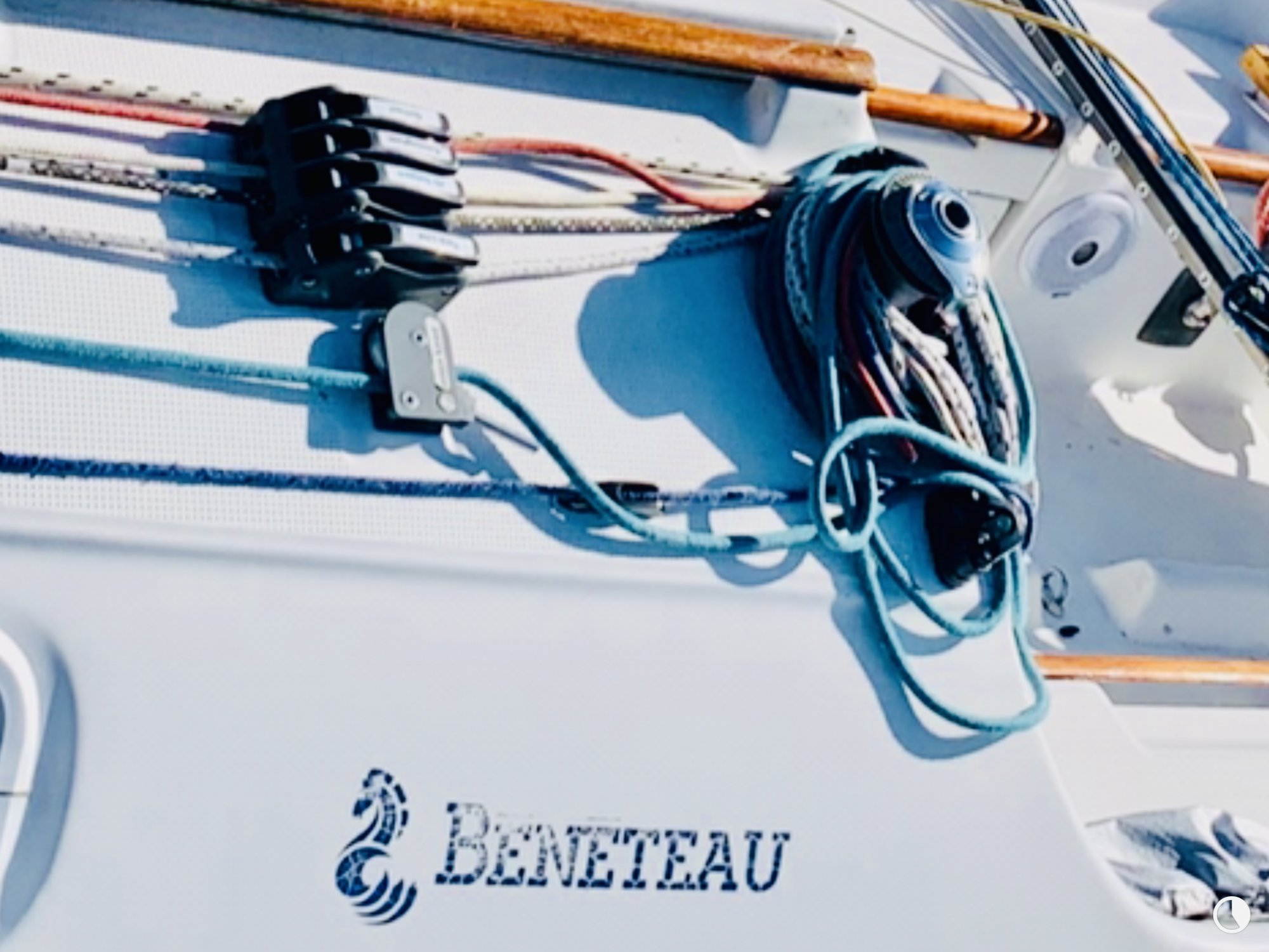

Hmmm thats the wrong application for a cleat. If you need a device to hold a sheet so a winch can be used for another line, you should use a footblock with a jammer.
You CAN you a clutch, but you end up leaving the handle open 99% of the time, a no-no on a boat.
Footblocks lay flat, are designed to be left open, and can be opened under load.
Here's a jammer on the jib sheet on BlueJ. But three of the lines in the clutches often need adjustment while sailing upwind (jib halyard, tack line and outhaul)
