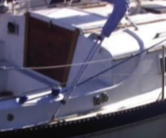

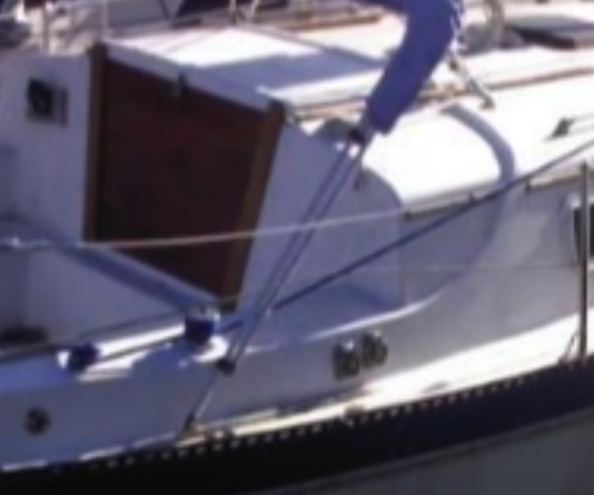

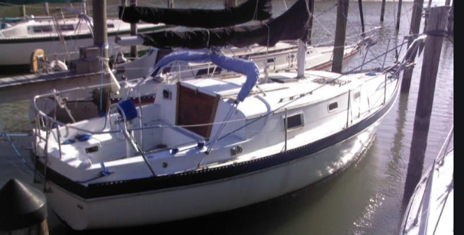

Below is a Watkins 27 with the jib sheet to a winch then to a jam or cam cleat.
24,719
Sail SFbay, It looks like the winch is wound top down rather than bottom up. Suspect it would work. Just need to assure you have a fair lead so the line does not back wrap on the winch drum.

11,386
HUH? You never ever do that.

24,719
Look at the leads closely in the image. Granted it is fuzzy.
The sheet appears to come from the sail clew on the furler to the winch then to the cleat located not he cockpit deck stern of the winch. Since there is no deck mounted jib block the lead would come to the winch high and click into the cam cleat on the cockpit deck - low. How do you wind the winch without trapping a line or it pulling out of the cam cleat.
Not how I would rig my boat. This is not my boat.
Nov 8, 2010
11,386
Its tied up at the dock.
