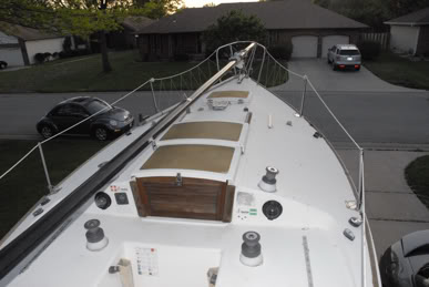

We mounted ours on the vertical wall of the cockpit. Line came off the genoa block, around the winch then over the edge to the cleat. That kept them off the deck and out of your A...! See the pic. The cleats are mounted just behind the winch handle pockets at an appropriate angle for good line entry off the winch. If we needed to cross-sheet, we would come off the genoa block and go to the opposite side cabintop winch, no cleating there.
I used to crew on a Soverel 27 that had cam cleats mounted like that. No problems whatsoever when racing. Definitely faster than horn cleats.

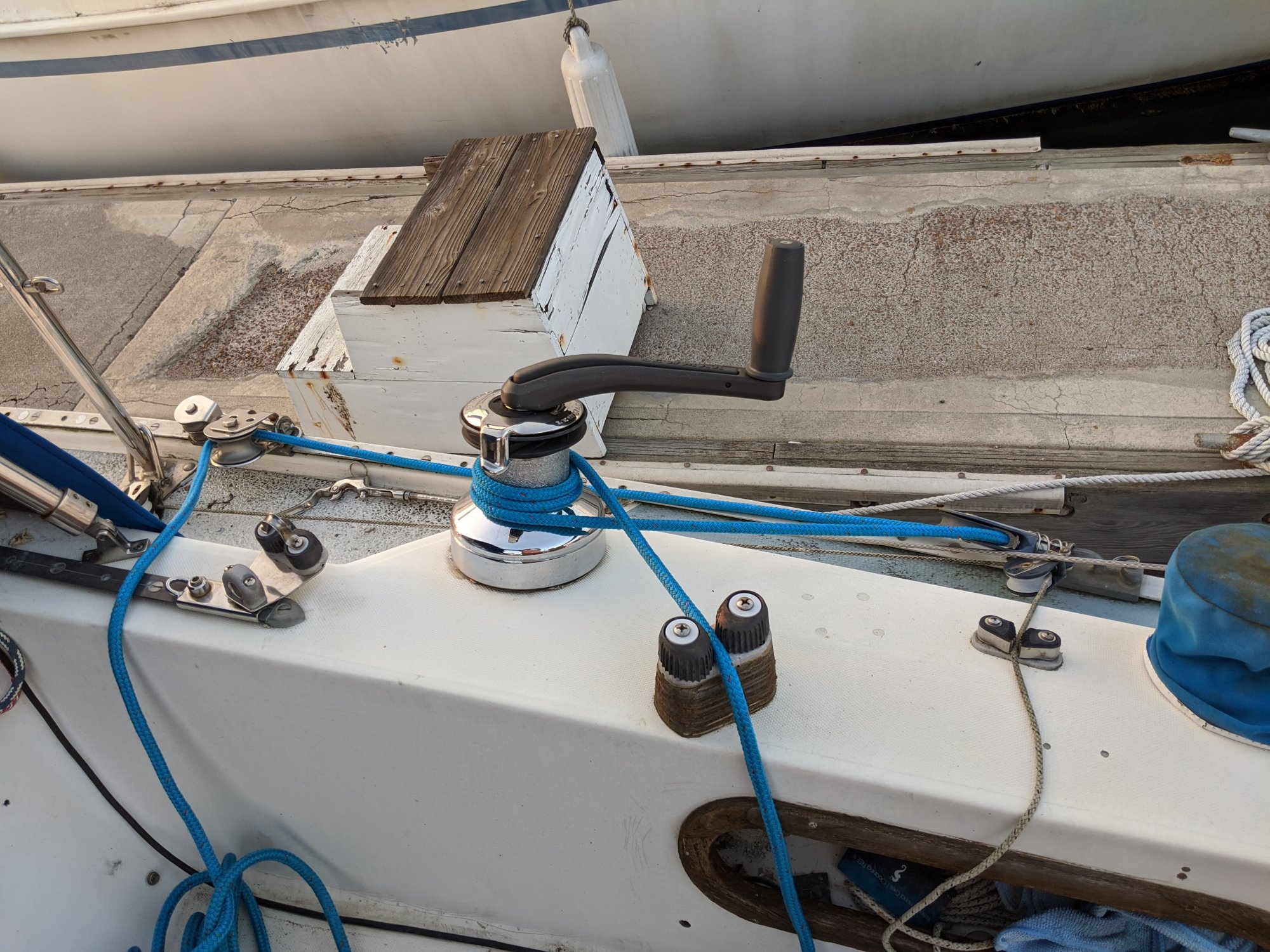

I solo a majority of the time on my W27 in the far N.Chesapeake. Rapid changes in wind direction is the norm as well as a lot of short run tracks. While I can cleat/uncleat the sheets pretty rapidly, sometimes it gets a bit fiddly and difficult to do in a timely fashion.
I'm seeking input on pros/cons of using cam cleats vs existing horn cleats. Yor input either way would be appreciated. TIA, Paul
I expect they’ll work, but I can’t predict that you will be happy with them. I’ve some experience using cam cleats. On some Cal 20s a cam cleat on a metal mount fixed under the winch base is used to stop-off the jib sheet. There are also some Cal20s rigged with no winch: just the cam cleat. Of course, you routinely find them on mainsheet travelers. Sometimes find them controlling the furling line of the headsail, etc. They are difficult to use under much load. It sometimes takes a mighty heave upward, while pulling back, to release one under much load. Then, of course, your hand is holding the load after the sheet is popped out. Also, you might have to either stand at the correct height/angle, or somehow muster the upward thrust with your one arm if sitting, to free the sheet. Conversely, the fancier ones (if still around) have a release that engages to release (open the jaws) when you pull downward. On small boats with small loads, releasing is not a problem. Larger boats, 20 ft & above, in strong to moderate wind, you’lll be fighting them to release and to not reset before you are ready in some of my experience.
13,951
Not all cam cleats are created alike. There are some that are hard to engage and others easier. The Harken cam cleats seem to hit a sweet spot, easy to engage and release. Where the cleats are mounted also play a role. It helps to have the cleats in a location that facilitates a downward pull to engage the line in the cleat.
As with most things on a boat, nothing is perfect. A cam cleat provides a quicker and easier release than a sheet on a ST winch or on a horn cleat.

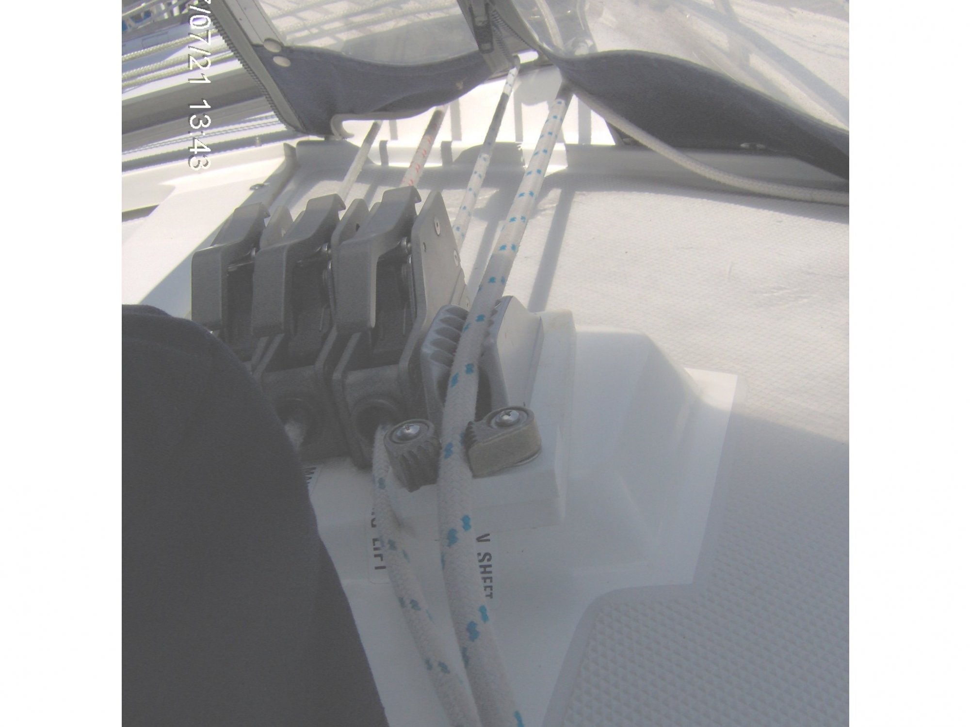

This is what I meant by an open cam cleat on a riser. If the line is low to the deck when you release it, the top wrap can drift down over the stack... may or may not be an issue to some folks, just sayin'... but the big advantage of the riser is the ease in up/down line motion to engage and disengage the cleat. When easing trim under heavy load the cleat sometimes has difficulty releasing. In this case, ease the load with the winch handle just enough to get the line out of the cleat.... When tacking, you can snap the line free. When cruising or day sailing, I'll load up the ST jaws as soon as I'm on course to take advantage of it's convenience. When working the boat up wind, such as you might in racing scenario, I rarely mess with the ST function.... opting to go standard winch style with the cam cleat. Just my preference... but it's way, way faster and requires less moving around the cockpit when single handing

Good points. By the same token, a riser can get in the way, particularly on boats were crew may sit on the combing. They can also make it difficult or impossible to release a sheet if the crew is sitting far away and cannot pull upwards. The best answer is certainly boat specific.

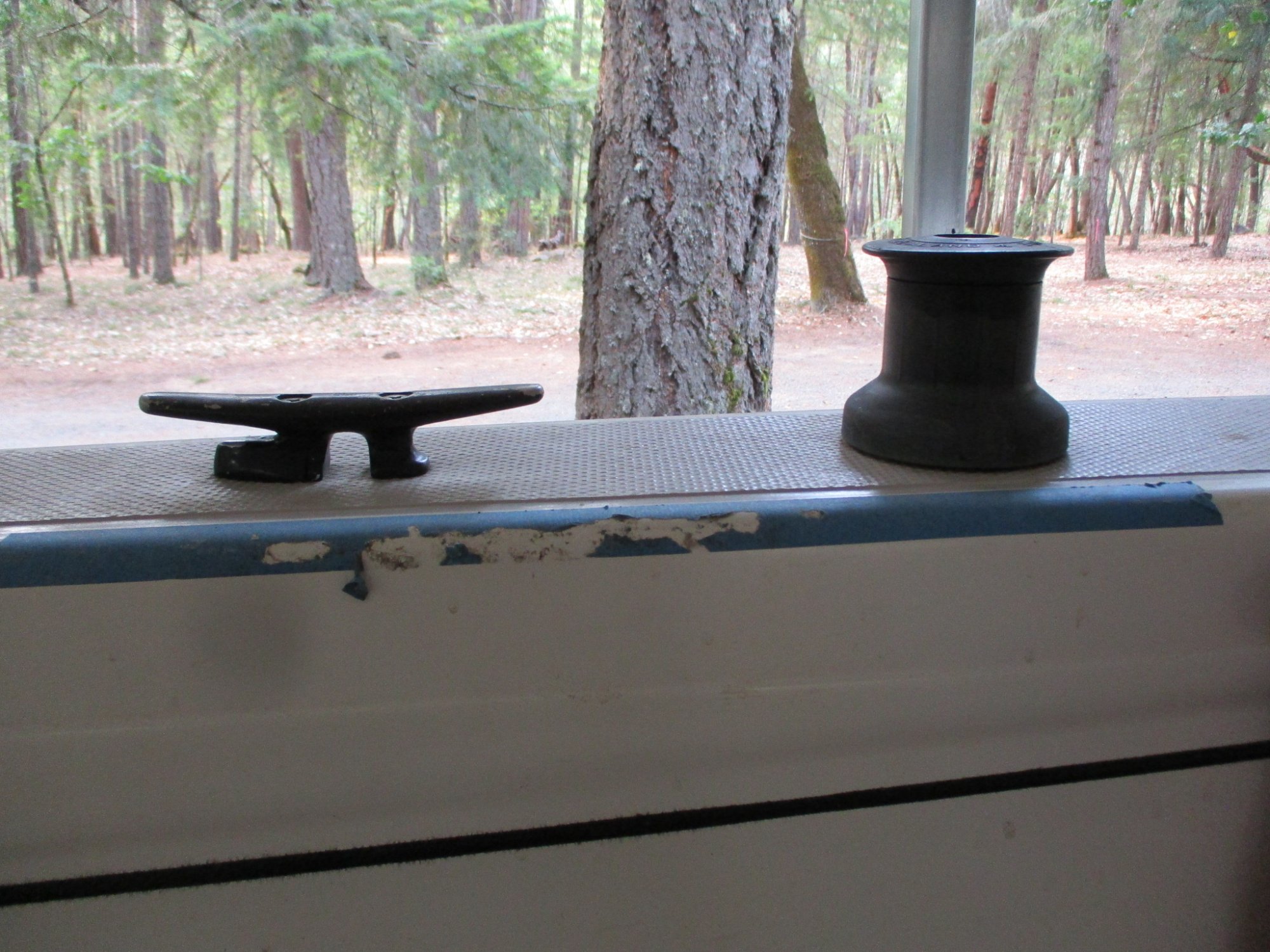

Self jamming horn cleats work quiet effectively on my Mac 25 also. kind of a best of both worlds IMHO.
