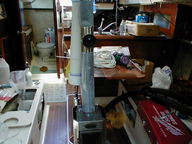

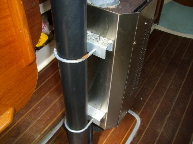

A diesel Heater just makes plain sense to me for a diesel auxiliary sailboat. The fuel storage system is already there, and probably very safe. Once lighted it will run forever without need of any outside power.
My Hunter 33 has a compression post as it appears your boat has. I mounted a Dickinson bulkhead mount heater on the post using home cobbled brackets. It is centrally mounted and allows exactly the length of flue pipe Dickinson recommends. No chopping up of woodwork. The heater drops right on to my mounts.A couple of wing nuts keep it from falling up. Fuel feeds from a separate 3 gallon "day tank" which is higher than the heater's metering system. Feed is thus gravity with no "tick-tock. I fill from the main tank through the Racor using the electric pump. I can have it out of the boat for cleaning or maintenance in less than 10 minutes. It is close the the floor for best heat distribution. Reasonably miserly with fuel.
A few seasons ago five of us were sailing on the bay in a cold, heavy rain fo no reason better than the fun of it. We anchored, fired up the Dickinson and were toasty warm in less that 10 minutes. It works for me. Pictures below taken during an interior fiberglassing project.

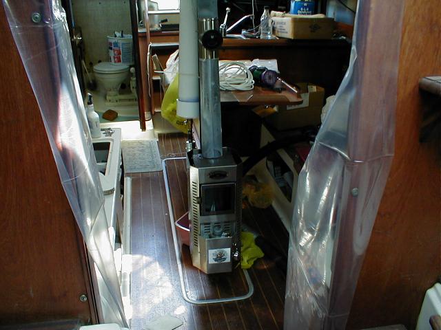

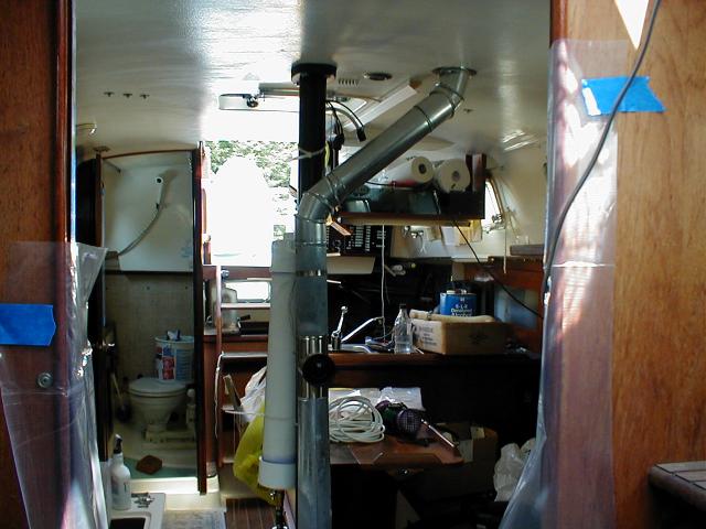

Sam, I was pondering a similar installation myself, and wondered why I had never seen one. Cool.
Is the white pvc your day tank? If so, I don't see where the fuel tops up or vents. Not necessarily the most elegant looking solution as is, but a very clever one that could quite easily be "cosmeticised".
