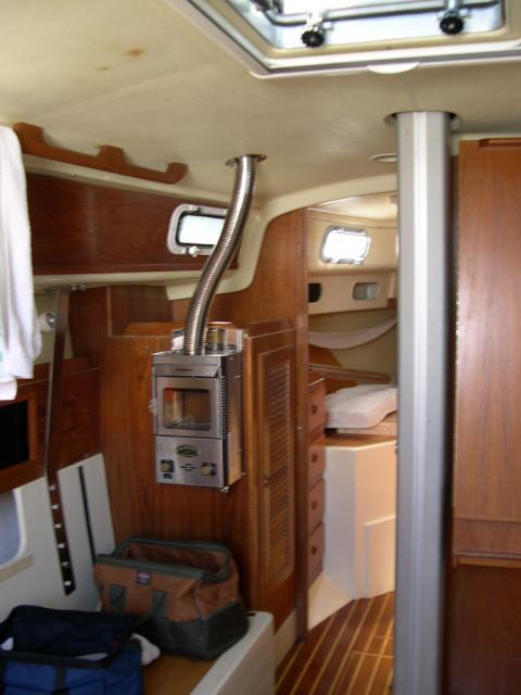

My Force 10 propane heater is mounted on the companion bulkhead about 4 feet above the floor. It tends to only heat the air above chest height. I have a small fan that we use in the summer time for cooling and use that to mix the air in cold weather but then it feels sort of drafty.

The propane Dickinson has a circulation fan that makes all the difference in the world. That being said, it will not heat you through the winter but does do a very nice job of knocking off the chill of autumn Maine. I have a buddy with an Espar installed on his Nonsuch 30. I'll see if I can get him to weigh in.

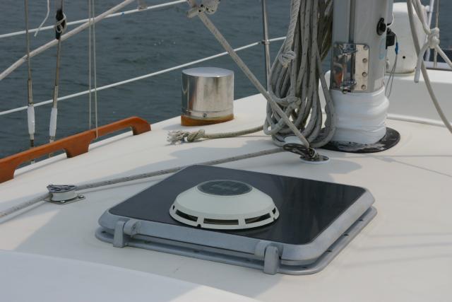

Re: deck stack - Charlie Noble is under the can you see in the photo. Charlie from Dickinson is not a terribly hardy fellow so I fashioned the cap so he wouldn't get messed up w/jib sheets & boarding seas etc. I have seen hardier ones, but for crossing the Gulf to NS it seems prudent to me to have Charlie in full battle dress.
Just remember to pull the cap before lighting the match! With propane it is actually not a safety issue because if you forget the cap, you get no draft, close the door, flame goes out, then you remember. Lighting solid fuel could give you some smoke.

The heater can be mounted low. I didn't have space down low.
Any problem with floor and feet being cold due the heater being up so high in the boat?
Also, the fan blows the heat downwards. I too, use a summer fan to move the air, which works because the heaters is not in a sitting area, it is in the nav area. But I can also tell you that it does not feel drafty there; the air is very warm!
I too had space limitations. I actually taped a cardboard box to the bulkhead for the entire summer in the desired spot, just to see it it was too bothersome.
I would not use an un-vented heater in Maine; in warm climates where it is turned off at night, OK maybe, but I value my brain cell far too highly to risk and damage from CO (not CO2 - I'm not certain there is a commonly available CO2 monitor). I sleep on the boat and cruise in the winter WELL below freezing and wanted a heater that would put out heat and be safe all night.
