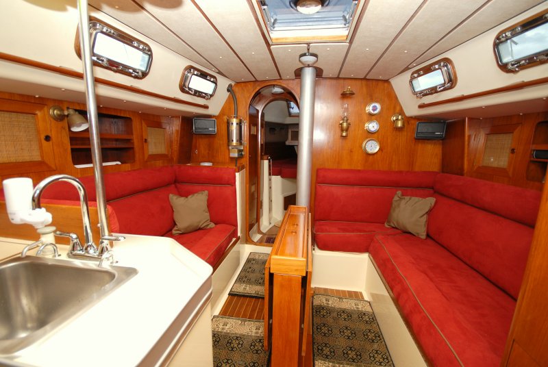

I need to add cabin heat to my boat. Best option because of space limitations and a desire for hot water would be an Espar water circulating system but is will be as much as a new set of sails and all new standing rigging even if I do the whole installation myself. Unless something unexpected happens, I can't swing that and still the the cruising that requires the heater.
I just went up to measure and look at the cabin and there are two options for either a diesel or solid fuel heater which would be less than half the cost:
I can remove the cabin table and shelf unit and install a stanchion at the aft end of the existing table and build a new, shorter table that mounts on a piece S.S. lifeline tubing between the mast support and the stanchion. The stanchion and table would make moving around in the boat underway a lot easier and I sail with few enough people now that I could live with a smaller table.
This would give me enough room for a floor mounted heater next to the mast support. Two problems: I would have to give up being able to convert the port berth to a double but I seldom carry the fill in cushion anyway. I can live with that. The big problem is that the only possible smoke head location is right next to the mast on the side where I raise the main and reef. I would have to cap it when sailing and would be dropping the halyard coil directly on top of it. Having the heater at floor level would be nice though because it is my feet that feel the cold the most.
There is also room to cut into the hanging locker on the other side and build a tile lined alcove that would keep the heater well away from the berth. I can get 10 1/2" depth. I don't use those drawers much anyway. The deck space on this side is not nearly as precious as there is little line handling there except when raising or lowering the roller jib. The most attractive thing about this option is being able to use a Sigmar with an air intake from deck to avoid back drafting problems when it's gusty or the companionway has to be opened. The second duct could run through the locker and I could put "Y" on it to draw air from inside the boat when I want to dry things out and it isn't too windy. The main drawback of this arrangement is that the heater is mid height in the cabin which means a cold floor.
WHICH would you do?

A Dickinson Newport LP heater would fit nicely where that shelf is.
It's going to be either diesel or solid fuel. I'm putting this in for cruises to NS and Newfoundland where those are the only two fuels I can count on getting easily. I don't want propane on my boat and I don't have a place to carry it anyway. There are two built in cockpit lockers for propane on the E32 but they are for the uncommon small bottles and are defective in design so they won't vent overboard.
Solid fuel has a big hassle factor but the advantages of lower installation cost and the ability to scavenge driftwood if I was stranded or disabled somewhere remote. That could be a lifesaver. It will also turn paper towels, can labels, etc. into something useful and reduce the volume of trash to pack to the next port. It's running a pretty distant second though.
I can carry 38 gallons of diesel on my boat and cruise under power at 10 miles per gallon so diesel is a pretty tempting fuel source.

......Solid fuel has a big hassle factor but the advantages of lower installation cost and the ability to scavenge driftwood if I was stranded or disabled somewhere remote. That could be a lifesaver. It will also turn paper towels, can labels, etc. into something useful and reduce the volume of trash to pack to the next port. It's running a pretty distant second though............
As I said I love wood heat. The radiant heat would help with the foot problem when near it. It is quiet, no blowers, but unless the boat is really large I think it has too many draw backs.
It takes a lot of wood to get the same BTU's from wood as from diesel. It is going to require a considerable larger storage area for it. It has to be kept dry. If the wood is not aged and dried and I would really suspect drift wood as not being in this category most of the heat generated from the wood fire will go back into the wood to dry it and lower the moisture content to where it will burn. I go to great lengths to get dead, aged wood in the first place. All the wood around here comes off of Federal Land, either National Forest or BLM and you are only allowed to cut dead trees. Once I get the wood I try to age and dry it for an additional year before I burn it Green or wet wood is going to give off very little heat.
The amount of heat you are going to get from burning your trash is going to be insignificant.
You have to be able to clean the chimney of a wood stove or sooner or later the creosote will build up to the point that the stove won't draft and will catch on fire and you will have an uncontrollable chimney fire. I clean my chimney at least twice a year. To clean it you need a straight run. That eliminates the 45's unless you take it apart to clean it. Looking at your interior you aren't going to want to do that.
Unless you have baffling (heat shields/deflectors) around the stove or nearby objects you will need at least 3 feet of clearance between the stove and anything combustible (the reason mine is in the middle of the room for one).
The chimney outside of the cabin really should be insulated pipe to help with the creosote problem. In your case if it was a straight shot down to the stove and you could clean the pipe easily I wouldn't worry about that, but it is another 'code' thing on a house.
Go with the diesel,
