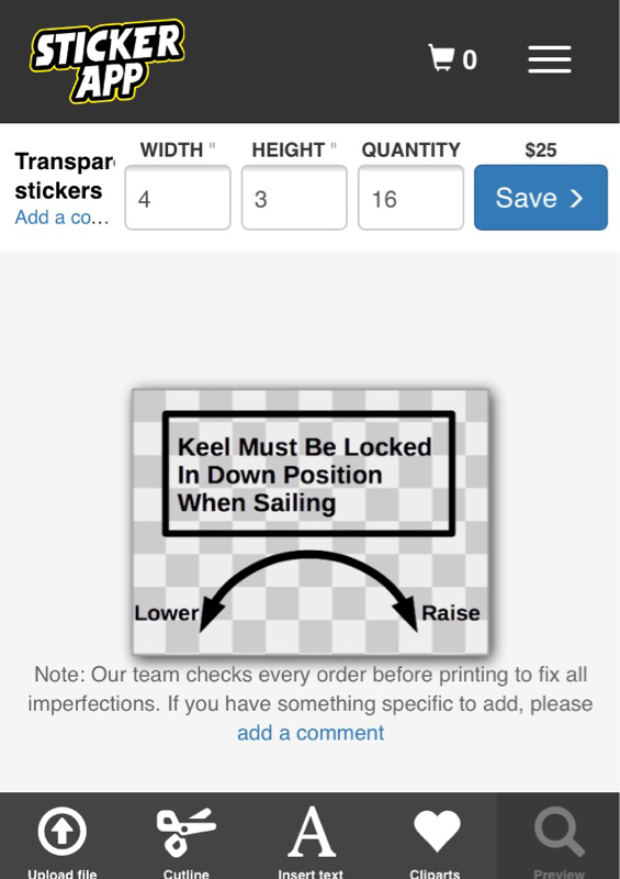

I use this website www.stickerapp.com to make stickers. They are very good quality and stand up to the elements. I've got some that have been on my vehicles for over a year with zero signs of wear, so they are waterproof and durable. I stole your art and did a quick check, it looks like you can get 16 of them for $25. I think they add shipping... Do it and I'll buy one.
Thanks for the heads up. I'll keep that in mind.
I'll see what the guy I know would want for some. He may just do them for slightly over his cost.

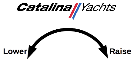

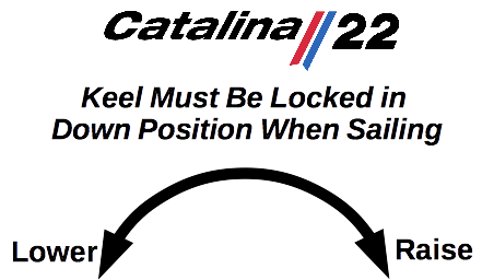

New Design Keel Winch Warning Label Continued
I've always felt the original sticker looked like it was done in 30 seconds by some guy in the shipping department.
I took some time this morning to try a few other designs.
The idea is to print them on clear material so that there is no white background like the original.
Catalina Yachts logo with no "lock" warning
Modified Catalina Logo with "22" added and "lock" warning
For course, you could simply remove the logo and have the arrow and font.
@dzl For the design with the lock warning and combined Catalina & 22 logo design, price from that site you linked is 19 (4" x 2.5") stickers with cut outline on transparent material for $24 USD
I've got my buddy's staff looking into the cost of doing them locally.

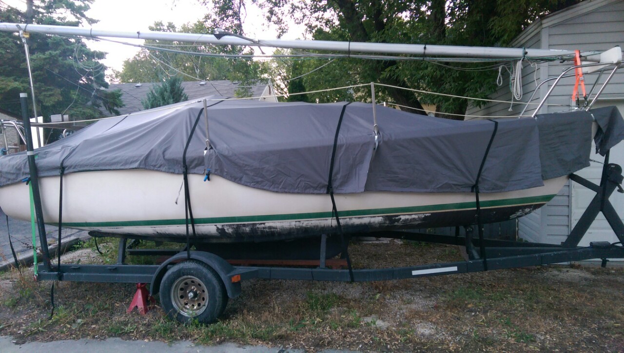

Power Boat Cover Modification to Fit
Since the fall is here it's time to think about getting my cover completed.
Previously I posted about a 22 foot power boat cover I bought for a great price.
I'm now in the process of modifying it so it will fit on a C22 with lifeline/pullpit stanchions.
I don't know how to sew. Lord knows why I get into this stuff.
So far I'm about halfway through cutting slots in the cover where the stanchions are.
The cover had elastic around the edge. Obviously cutting slots in the side of the cover negates this.
I'm going to replace it with webbing to reinforce the edge and have loops on each side where the cover meets the stanchions. One loop will be passed through the other and tied down to the trailer with rope. This will pull the sections together at each slot in addition to pulling the cover down.
I'm not sure how i'll be reinforcing the material around the edge of each cut slot.

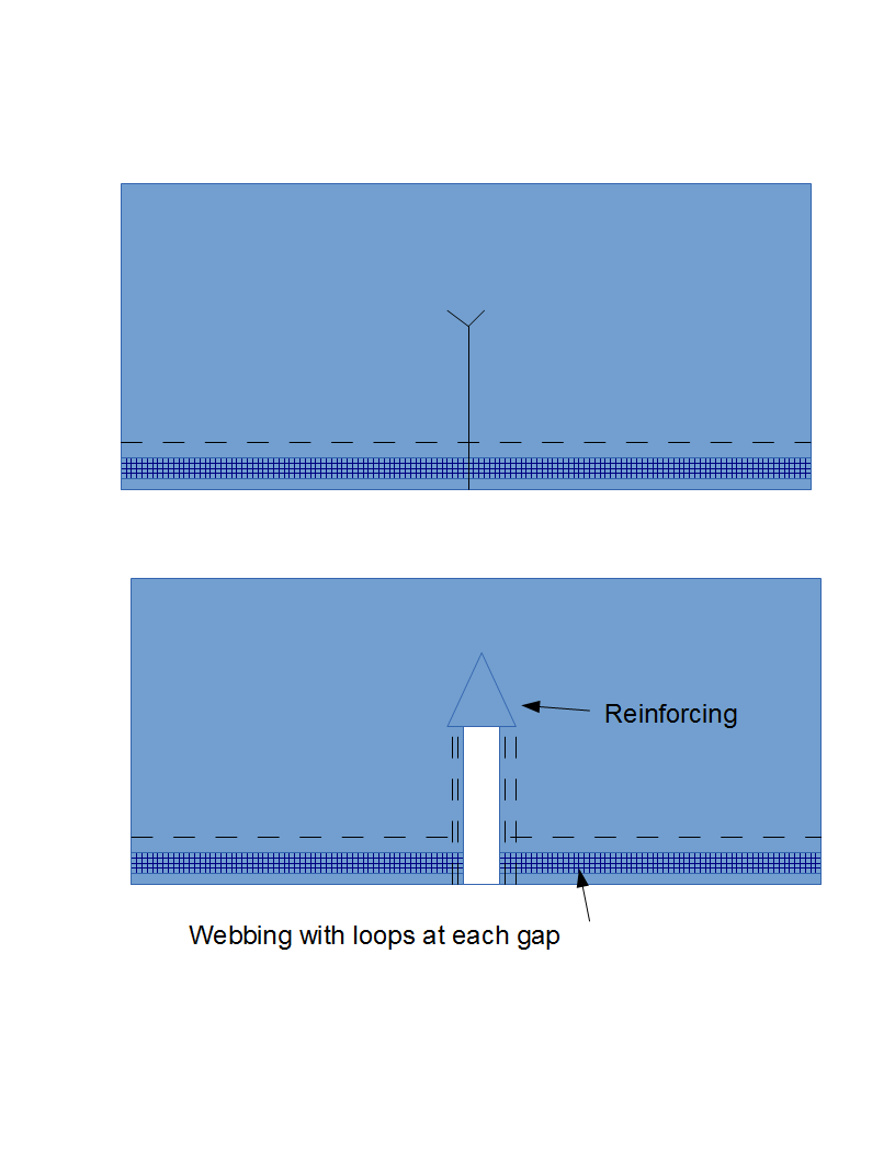

My current thought :
Put a triangle patch on both sides at the top of the cut, hem the edges, and sew velcro on each edge ?
Any suggestions ?
Here's quick drawings of what i'm dealing with.
First photo is the cover with the cuts in it to go around the stanchions.
The second photo, is what I'm thinking to do for sewing and reinforcement.
Mar 20, 2015
3,261
C&C 30 Mk1 Winnipeg

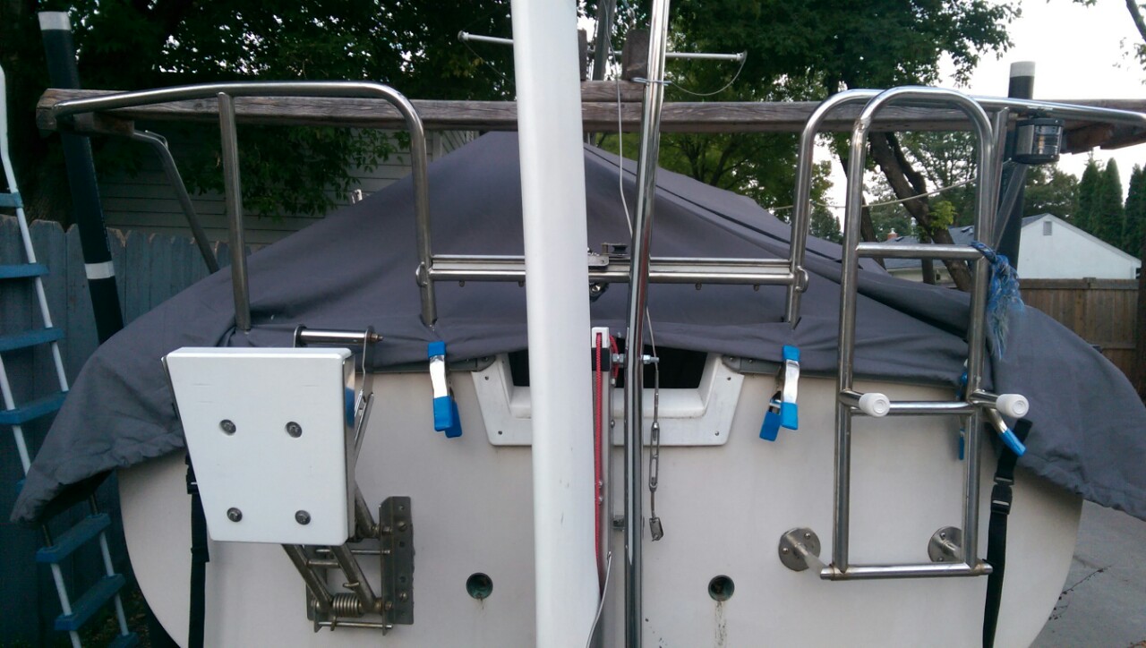

Cover now has slots cut to allow for stanchions.
Since this was a power boat cover, it needs to be trimmed off as it goes to the bow. I'll use the excess as reinforcing material for slots.
The cover is just the right length. What looks like excess will be enough to cover the longer anchor roller I want to build.
Likes: ShotgunSlim

Ok. Time to kill those crickets.
As you can tell, I haven't been working on the boat for a while.
I've had too many bigger priorities until this last week.
In our previous episode of "Land Locked", I was modifying a power boat cover to fit the C22.
My suggestion to others, is to not bother, unless you want to use it as a learning process.
I had to borrow a commercial sewing machine, which unfortunately does not have reverse.
Then I had to learn, which pointers from my wife, on how to use the darn thing.
The amount of time I have spent modifying the cover, could easily have paid for a $1500 fancy custom cover, had I calculated my time in terms of a minimum wage job.
The thing is, I can afford to buy lots of things, but I have some "problem" which makes me too frugal to do so. I usually gravitate to the frugal alternative.

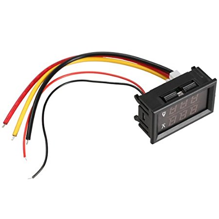

I'm currently waiting on some parts for both my tow vehicle and the boat, so today I was back looking at the power system on the boat.
I have the basic wiring functional, and have replaced the old switches and fuses in original panel, with new parts, take from a panel that I bought at a local marine dealer. I simply removed the parts from the new faceplate and transferred them to the original face plate. A bit of rewiring, addition of a 12 volt cigarette lighter power port, and it was ready to use.
At least temporarily...
My long term plan is to hook up my Solar panel and future sailpro with alternator, into the system.
Along with this I want a meter to monitor power consumption and battery condition.

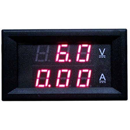

Awhile back I purchased a YB27VA Volt/Amp meter
The unit itself is limited to 10 amps, but it sometimes includes a 50A resistive shunt, depending on who you buy it from.
It's small enough to fit in the factory panel and may just work for what I need.
I have yet to determine my actual power consumption on the boat so I'm not sure yet.

Change of plans..... in regards to using the YB27VA meter in the panel.
My solar panel came with a 7AMP shunting type Solar Charge Controller.
Since a shunting unit is no great, I wanted to replace it.
I found a 20 amp PWM Charge controller online (CMTD-2420), that has, adjustable parameters including battery type, and a visual battery + charging status display.
I'll be able to use the display to show battery condition, even if the solar panel is not in use. This eliminates the need for a meter in the panel. :)
