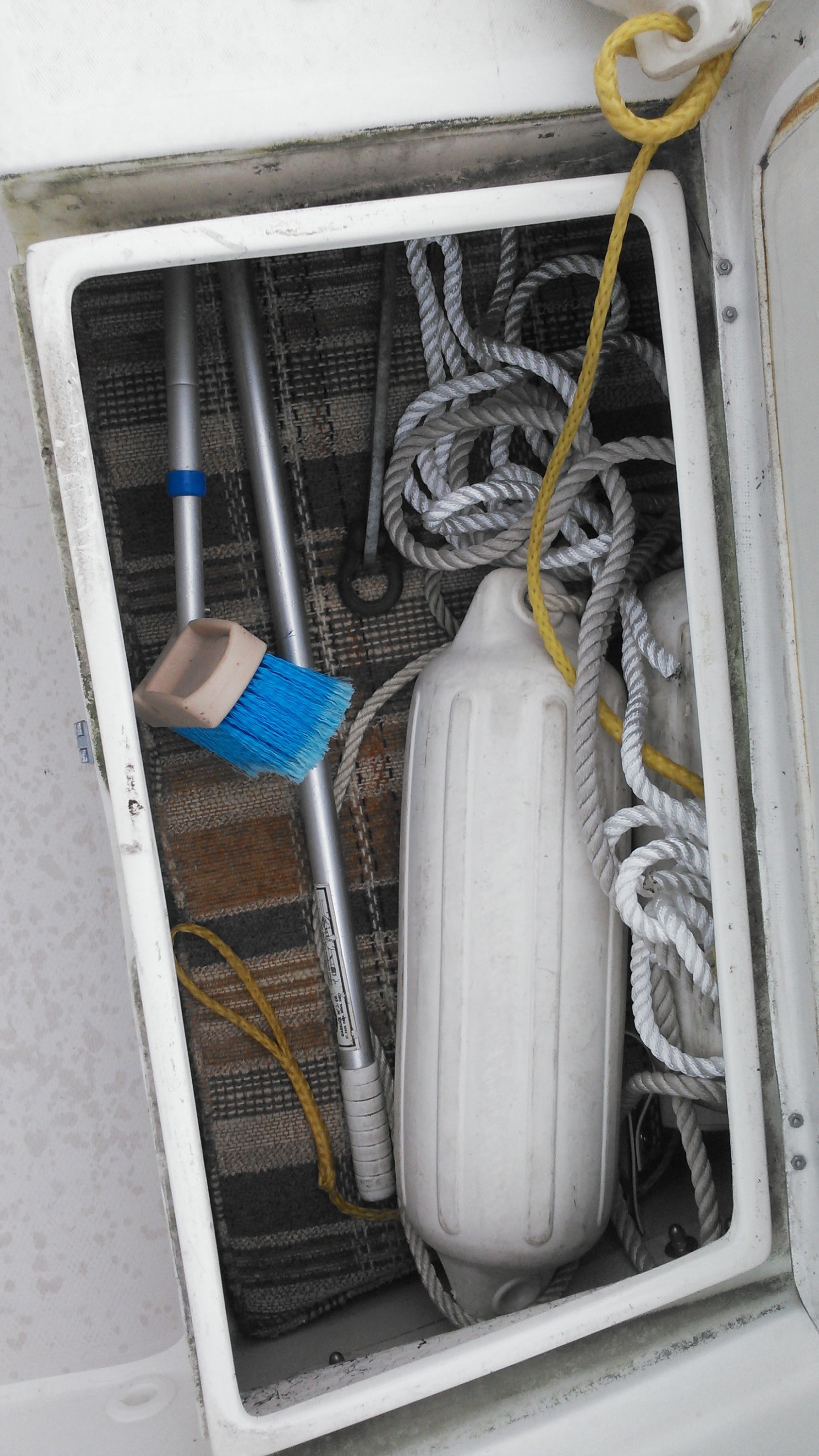

I mounted our fire extinguisher just inside the cabin, because I wanted it easily available If I woke up to a fire.
Putting the Handheld VHF, flares, and Horn there makes a lot of sense.
Due to the depth of that locker between the battery tray and the transom, we have our fenders, and extra rope, there.
I may get some rope on a spool, and store it there. A friend of mine has that on his boat for tying the stern to shore. Some of the places on our favorite lake here, are just made for that.
Gene....laz monkey residence, stbd aft cushion on this 84 is 80" long, extends from winch to trnsm....wtf were they thinkin?
the fenders are resting comfortably in the rear stbd laz!

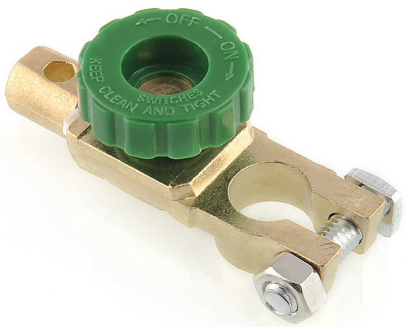

Battery Disconnect:
I had a new automotive battery disconnect lying around, so I used that to enable disconnecting power right at the battery post. They come in various styles, including for batteries with just screw terminals.
When I relocate the battery to under the v-berth, I'll get a bulkhead mount marine battery switch, so I don't have to move a bunch of gear or cushions to access it.
(We have used these disconnects for a few years at the automotive shop, for customer's RVs, and other vehicles that get infrequent use. So far they have worked well, and been durable)

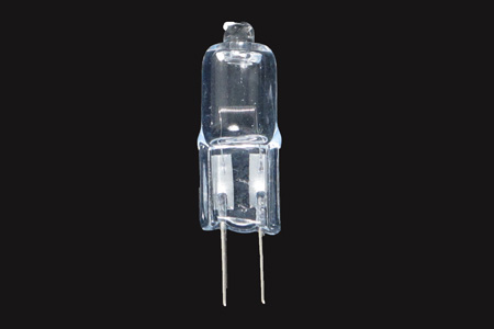

Unfortunately my steaming/decklight unit was made before 1988 and it has a 2 pin connector on the bulb.
CD states: "No LED module exists for the deck lights of those fixtures produced before 1988"
I had briefly looked into modifying the deck light portion by removing the built-in reflector and installing a MR16 LED with it's own reflector.
I assume that the original unit's halogen bulb was left exposed to prevent heat build up from damaging the plastic housing. By using a MR16 type LED, I would have a better reflector, and should be able to seal the bulb into the housing with a silicone gasket.
If I remember correctly, the idea was workable, but I decided do higher priority modifications first, and now I don't remember the problems to be solved. I think the length, of the few LED alternatives I tested, was an issue.
This type of stuff is why I want to buy a 3D printer kit this winter.
I could make all sorts of custom pieces for various projects, including reproducing discontinued parts for the truck and motorcycles I'm restoring.
Mine is the same and I considered the same but I really don't use that Halogen deck light much.
On our lake, sleeping aboard isn't really allowed but one can fish out there all night. This reg. is for good reason since there was a recent boating accident / death on a nearby lake where a drunk boater hit a fishing boat with a high-powered cruiser.
it's good to see better at the docks but we also have sodium vapor street lights there.
