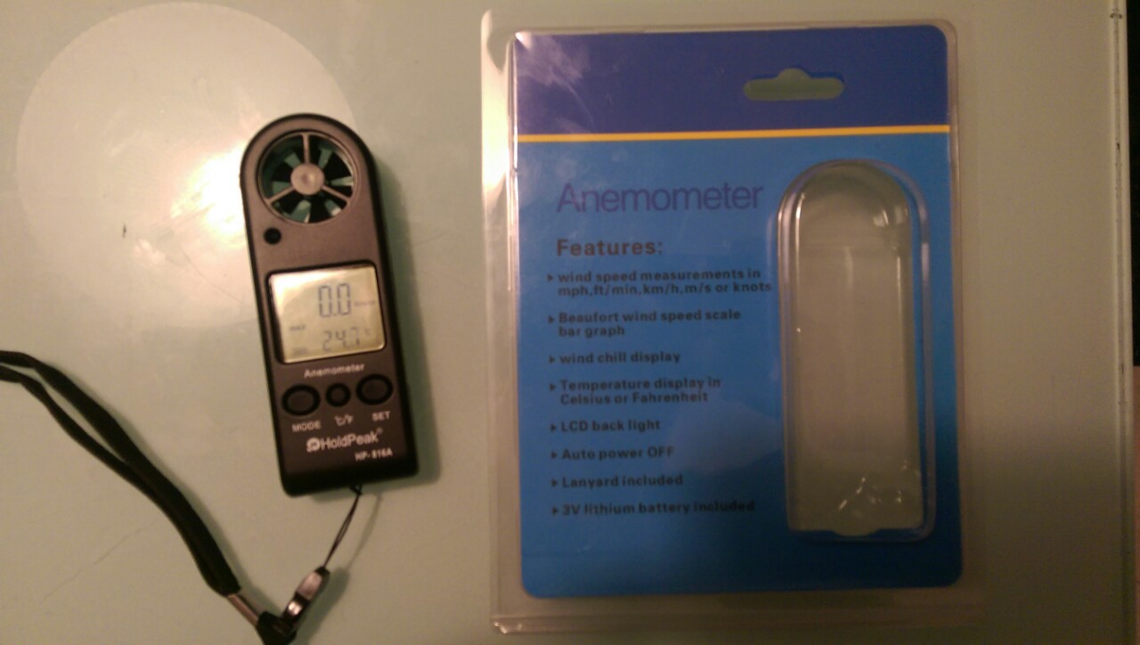

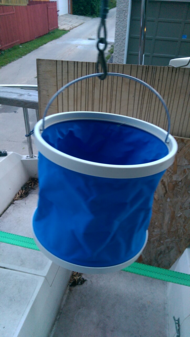

I'll post photos of all that soon, but in the mean time I thought I'd show you 2 things that were too cheap to pass up.
1) A folding bucket $2 at the local "dollar store"
2) Handheld anemometer $25

I can't say enough about collapsible buckets. My wife bought me one at a boat show a couple years ago. It's amazing how many uses it has.
The anemometer is fun too. I'm forever wanting to heave to and measure the wind when it gets strong, and also right before weighing anchor in the morning. It helps us hank-on people decide which headsail to start the day with. :)
:) I'm thinking I should have picked up a couple more at the price.
I had one years ago but it got punctured when I was using it as a tool bucket.
When my wife asked why I bought the bucket this time, I told her we needed an emergency bilge pump for when we run aground. hehe.
I hope it never gets used for that.

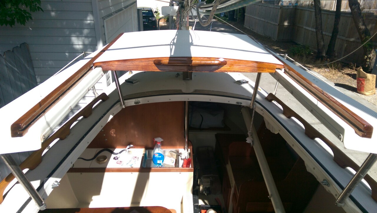

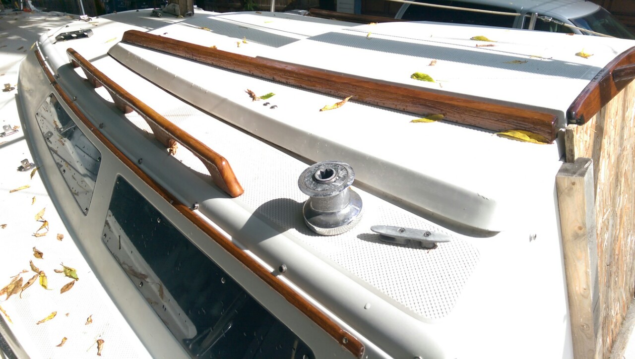

More progress...
I'be got the eyebrow pieces installed.
In that area above the cabin windows/deadlights, there was a void between the outer skin and the inner liner.
While I could have used thickened epoxy multiple times, to try fill the void around the holes so I could fill + re-drill the holes like I've done with all the other deck holes.
I decided that it was too much work, with minimal advantage because there was likely no wood core in the void area anyhow.
I wet sanded the gelcoat in that area, with 1000 grit paper, polished it with 3M single step wax+rubbing compound, wiped the screw holes down with acetone , and mounted the teak "eyebrows" with new stainless steel screws and butyl tape.

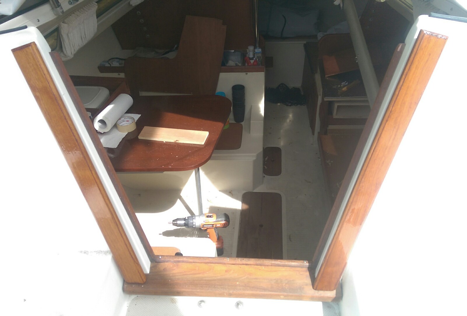

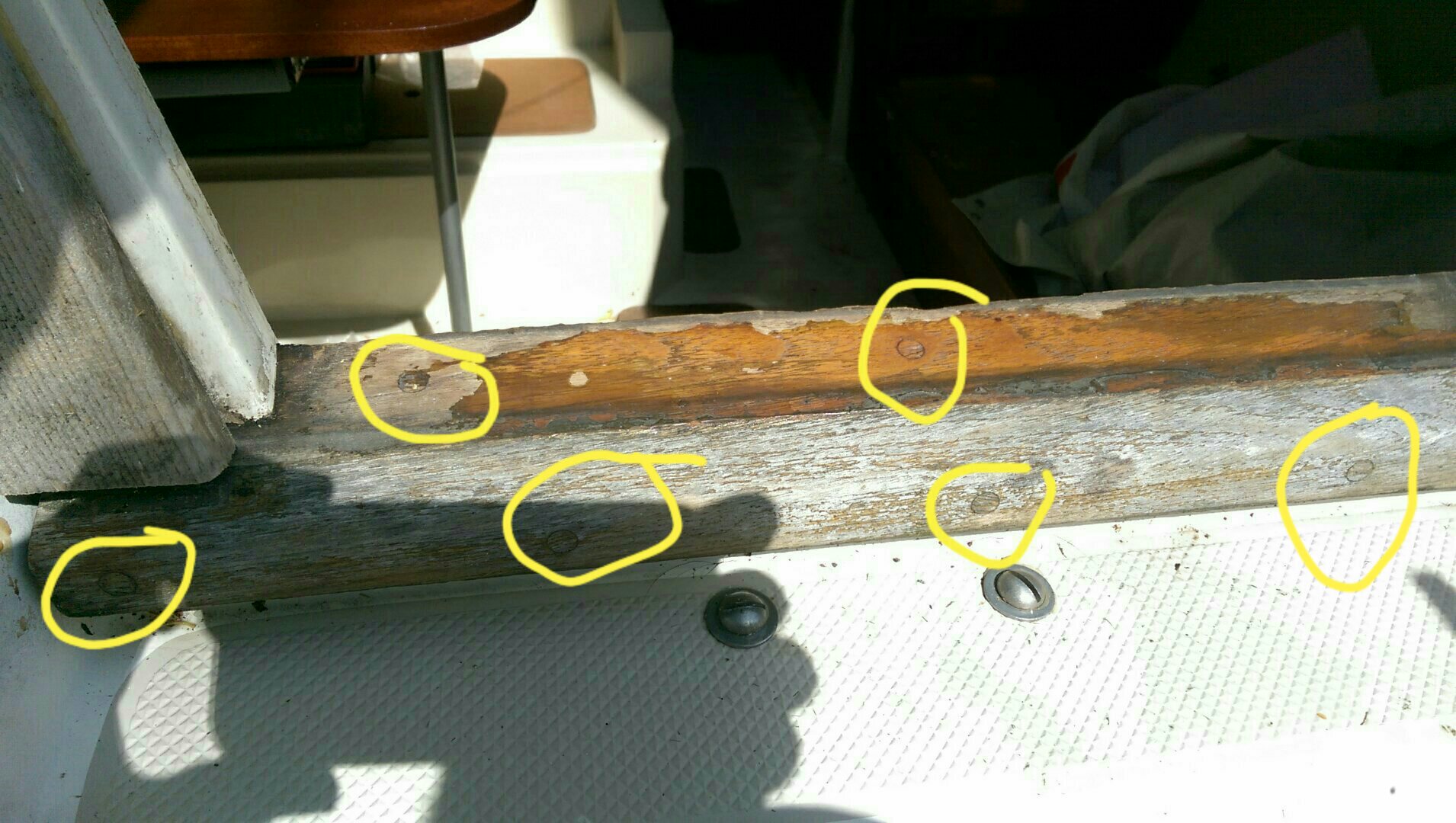

Companionway Hatch
The vertical teak rails that hold the hatch boards in place are ready to be installed, but before I can do that, I had to come up with a solution to fix the teak "threshold".
Option A
1) Remove the 8 teak plugs that cover the mounting screws (3 on top and 5 on the rear edge), and remove the screws.
6 of the 8 wood plugs concealing the mounting screws
2) If some previous owner used adhesive sealant...Pry up the threshold, without breaking it.
3) Refinish the teak threshold.
4) Re-install the threshold and make new teak plugs to cover the screw holes.
Option B
1) Mask off the area, and scrape/sand/prep the threshold without removing it.
2) Use an initial coat of epoxy, followed by coats of varnish
Option C
2) Use occasional applications of oil to protect the wood.
I'm currently leaning towards Option C with possible switch to Option B in the future.
The hassle of removing the threshold, and making new teak plugs from some leftover pieces that I have, which will not match the original, isn't worth it IMO.
Varnish itself seems like a bad option for something that will get foot traffic and dirt/sand on it.
EDIT: One risk with not removing the threshold, is that I can't re-bed it. If there is wood coring where it's mounted then it is not a good thing.
In the interest of trying to actually go sailing at least once this year, I'm
refinishing it in place, and oiling it. I'll look at re-bedding it next year.

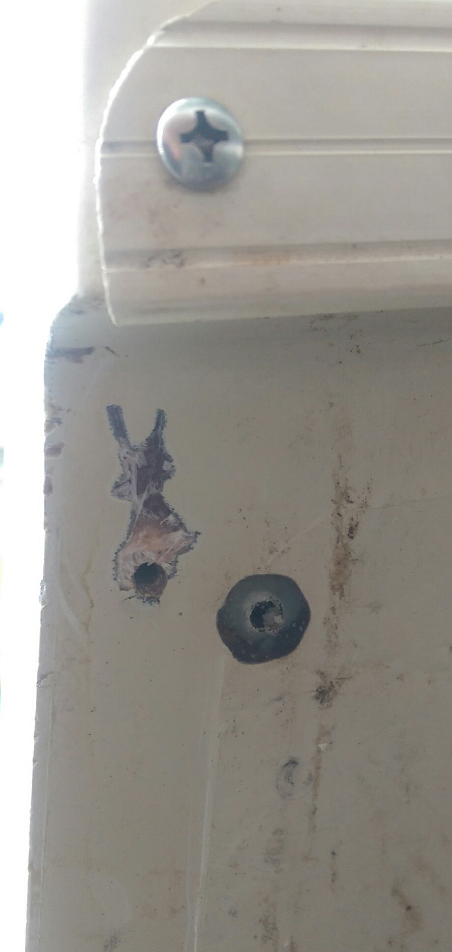

To remove the companionway hatch board rails, you remove the interior teak trim, which gives access to the screws that hold the rails in place.
Judging from the condition of the holes, the rails have been removed a bunch of times over the years.
Some of the holes were damaged to the point of them being enlarged to the size of the screw heads.
Not good, but easily solved.
Out came the the epoxy, drill bits etc., and I potted all the holes.
Around the edge of the companionway, there is some type of filler material used between the inner and outer skin.
On my boat, based on the debris from the holes, it doesn't appear to be wood coring. It's likely similar to the material used in the hatch itself. Polyester adhesive filler ? I'm not sure.
There were some small voids between the inner an outer skin, so I could not simply fill the holes with epoxy.
I used some left over six10 thick epoxy. Because the original mixing nozzle was not reusable, I simply dispensed it into a plastic mixing cup, and mixed it by hand.
With tape over both sides of the holes, I injected it into the holes, waiting a bit between each injection.
It's thick enough that it didn't simply sag/ooze/run down into the panel.
Since there wasn't wood coring, I wasn't looking to seal the holes 100%. As long as they were 95% filled, which gave the screw heads something to sit against, I figured it was ok.
The next time I re-bed the rails, I may inject some more epoxy and redrill again, to fill the few gaps that were left so that they are 100% sealed. (just in case I'm wrong about no wood being in the core there)
As long as the butyl tape does it's job, the water won't get in anyhow.

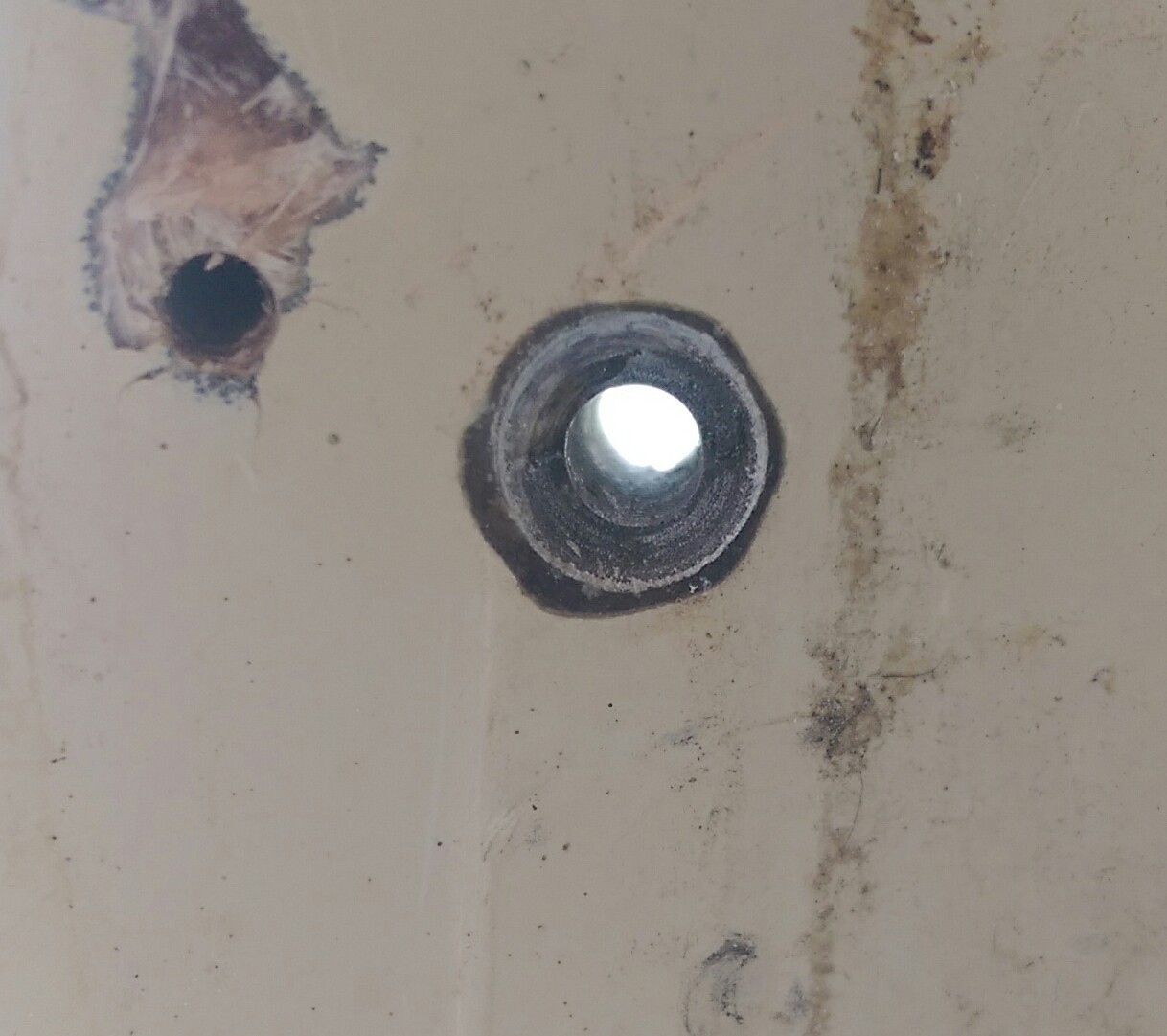

Original hole filled with epoxy, and a small pilot hole made in same location
Once the small hole was drilled, I could see where it came out. They all came out in the right spot, but not 100% exactly in the middle of the original hole location.
I then used a slightly larger to drill through again, while making any small adjustments to the angles, so that it came out in the right spot.
I then drilled again with the final bit size, and used a counter sink bit on both ends of the holes.
Hole drilled to final size, and counter sunk.
One countersink was so the heads would be flush with the interior skin, the other countersink was so the butyl tape would seal better.

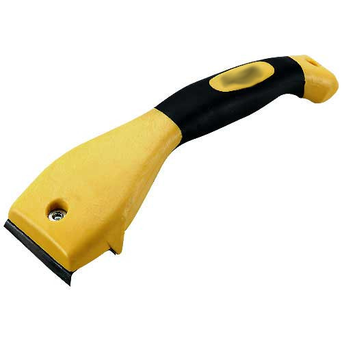

In the end I refinished threshold in place, and oiled it.
The top surface was uneven and had old varnish on the forward half.
Instead of trying to use a chemical stripper, and sander, I used a hand paint scraper.
When nice and sharp, they can remove paper thin layers of finish and wood.
If doing a large flat panel it's sometimes handy to grind/round the 2 corners so that you don't gouge the wood.
4 passes and the old varnish was off. 15 more passes and the uneven surface was nice and smooth.
I then used 220 grit paper on a sander to finish it off, before applying teak oil.

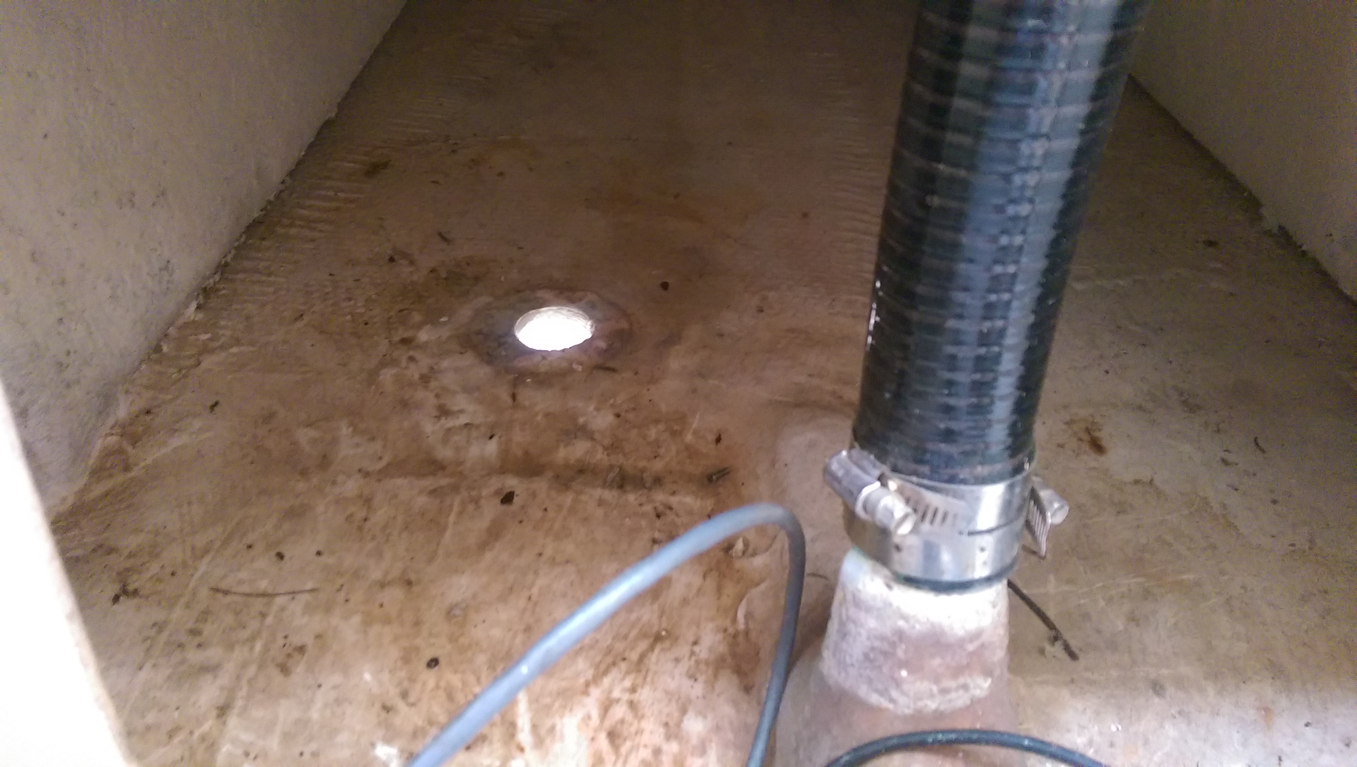

Mar 20, 2015
3,298
C&C 30 Mk1 Winnipeg
What are you sinking about ?
Last fall when I launched the boat for the first time, we confirmed that the depth finder didn't work.
We also discovered that the transducer was leaking enough water to abort the evening sail.

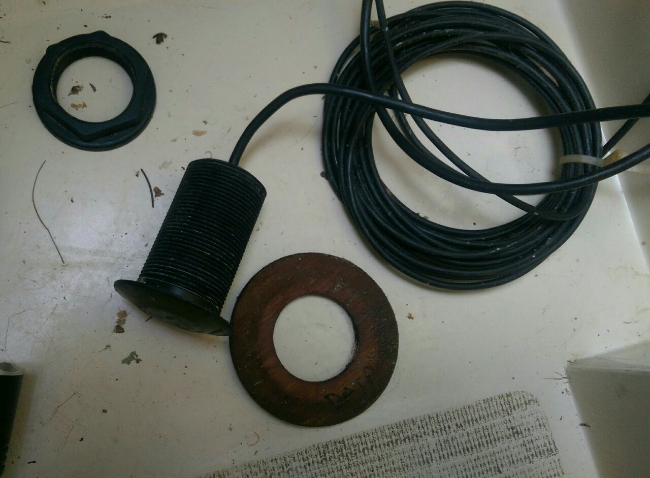

I don't have a replacement depth finder yet, so in the meantime, I'm pulling the transducer out and re installing it with new sealant.
I grabbed a big pair of channel lock pliers, and loosened the nut on the inside., then turned it the rest of the way by hand.
I then easily! pushed the transducer down and out of the hull.
Hole under the cockput where the original Signet depth/temp transducer was mounted
A quick inspection showed where the sealant had completely failed in one area.
Old Signet Transducer
I removed all the old sealant from the hull and the transducer, wiped them down with acetone, applied fast cure 4200 sealant, and re-installed it.
I did the same thing to the old speed transducer too.
When I get time, I plan on removing the hole for the speed transducer, and possibly even the one for the depth.
At the very least, there will be one less thru-hull.
For now, I'll just be happy that the leak is gone
