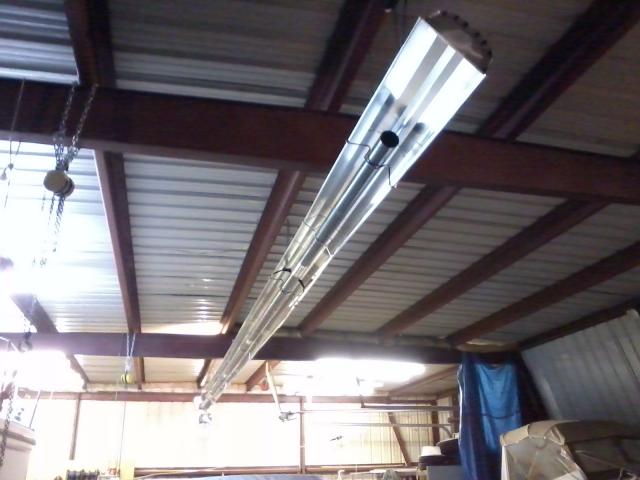

And for an almost unrelated post, Saturday was NOT spent on the boat. It was spent in the shop installing a new LP gas-fired infrared heater... This heater is supposed to put out 150,000 BTU... My hope is that this winter despite lack of insulation, working in the shop will be a t-shirt-only affair...

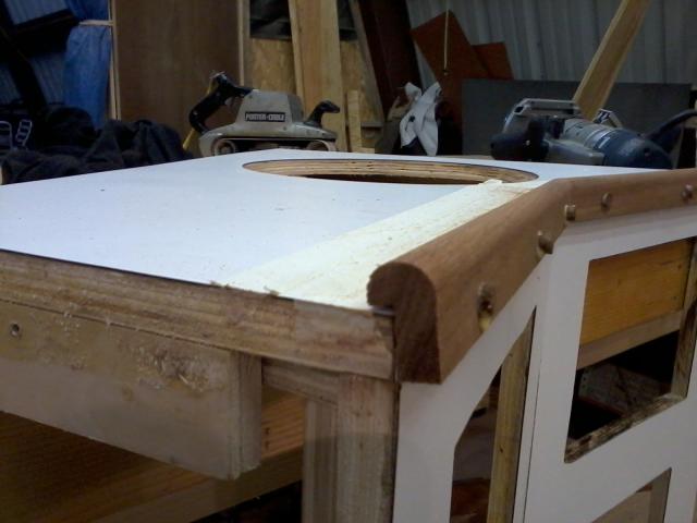

Been busy with the heater install in the shop, Thanksgiving, and the moving of a C&C Newport 27 I bought for parts. Not a lot of progress to show. the brightwork for the head had the old screw holes plugged, (nasty sloppy work by a previous installer in the Newport) has received a third coat of varnish in preparation for sanding flat. Hopefuly coat number 4 willl be a final gloss coat. Pics will follow after installation.
I have to share an endorsement. I usually research and set out to buy name brand product, and rarely buy the house brand. The C-27 came with a couple of quarts of West Marine - branded varnish. Now granted the stuff is made by Epiphanes, but still the stuff is a house brand. I am used to using Interlux jet speed and Schooner varnish, and use Sikkens Cetol often. Were I going to go buy products for finishing in varnish my instinct would be to go and get the Interlux stuff....
This West Marine varnish is wonderful stuff. It goes on markedly different from Schooner and differrent from Cetol for sure, but once you get the hang of it you will be impressed. The stuff is THICK! As a result it does not run or sag like the other stuff. You have to really push it to get it where you want it. It is slow to flow out flat after brushing but you gotta just trust that it will, and when it does, oh boy.... we are talking glass-smooth.
Additionally, the stuff seems to have a very high solids content. The build up is quick and impressive. I am used to needing 10 coats or so with other stuff to get to a point where I can get the surface sanding to a uniform flat that is not telegraphing wood grain. The West stuff is sanding flat in about 3 coats. Really amazing, and a lot quicker. It is really rewarding to be able to cut a varnishing schedule down by a third; this goes a long way towards removing the tedium of brightwork.
As a supplier to the marine industry, I am too familiar with the color white in all of its shades and the hassle the color white can give you. When doing something white you are virtually guaranteed to not match any white parts near your work or additions. I know of at least one manufacturer who has different white gelcoats for his cockpit liner and his hull... When color matching parts for the interior, you have to be sure you did not get gel samples from the hull. This is bearing truth in my head remodel as the white Formica is very bright compared to the boat's gelcoat liner and the bone color of the head. It is hard to tell in the attached pic, but there are three differing colors in there now. The walls will go to the Formica white and that will hopefully even things out, but I am counting on towels and carpet to pull the eye there... :D
Here is a quick dry fit of the cabinet in the head with the Formica in place and the varnished fiddle.

Those gaps on either side have got to go. Despite best efforts, they are still there. I have some thin fall-off from milling the mahogany, I guess I am going to have to varnish up a couple of strips and tab them in with a few dabs 0f 5200 after everything is installed.

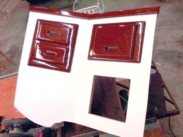

I have been travelling the last few days, but had a chance to lay on some varnish before I left. I think I am close to being done with the brightwork for the head remodel. I am going to get fastening done for the door and the drawers, mounting them blind and from the rear so that the screws are not visible. Then I am going to probably get some very fine bronze wool and knock the sheen down some. Ths stuff is super smooth and glossy, but maybe too clossy for interior work.
A trick for anyone considering refinishing drawers or doors with recessed fingle holes such as these:
Sand and stain down in the hole as best as you can to get the color uniform just as you are doing with the rest of your refinishing work. On your first varnish coat, get a single coat of varnish in there, (it is a huge pain) to set the stain first, then varnish the rest of the workpiece. Do not varnish down in there on any subsequent coats. It is WAY too big a pain.
After you are finished with your final varnish coat for the surfaces of the drawer or door, clean out the recessed finger hole to remove any debris. Mix up a little epoxy and pour a thin coat in there, and roll the drawer around to get an even coat. Lay the drawer or door down so that the face and the bottom of the finger pull is horizontal. Pop any bubbles as necessary, and then just let the epoxy kick. Voila, smooth shiny flat finish down inside with about a minute's work.
See attached pics.
