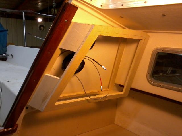

The sub's a very good idea! We had some old Radio Shack small speakers for our stereo that worked fine for years, but were missing the bass end. A powered subwoofer from Crutchfield really made things so much better.
Now I shy away from TV on board, but like I always say: your boat, your choice.

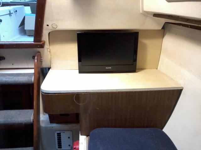

A sub will be good. I have access to some proprietary amplification technology here at Kicker where I work. One of our OEM amplifiers has a max current draw of around, (only) 30 amps, yet has a 1-ohm stable 100 watt subwoofer amp section and 4 40-watt fullrange amp sections. It is a programmable amp; I can go in and define gain, crossover, phase, EQ and compression for each channel. I can also mix inputs for each channel, just in case I have that need. The head unit to drive it is one of the Sony 12-volt DVD (MEX-DV2000) players and it has surround sound, I think. If not I can mix a rear surround sound signal in the amplifier.
The TV I chose was the Skyworth SLC-1971A. It has a 720p HD resolution, is 12 volts and has a DVD player built in. I have read good things about the Skyworth product, and while one of the new players out there, they seem to be more stable and entrenched than some of the other new brands that have popped up. They have a marine TV, but for my needs the non-marinized version will work. I have not fired it up yet, but might do so jsut to get a feel for control, ease of operation and overall picture quality.

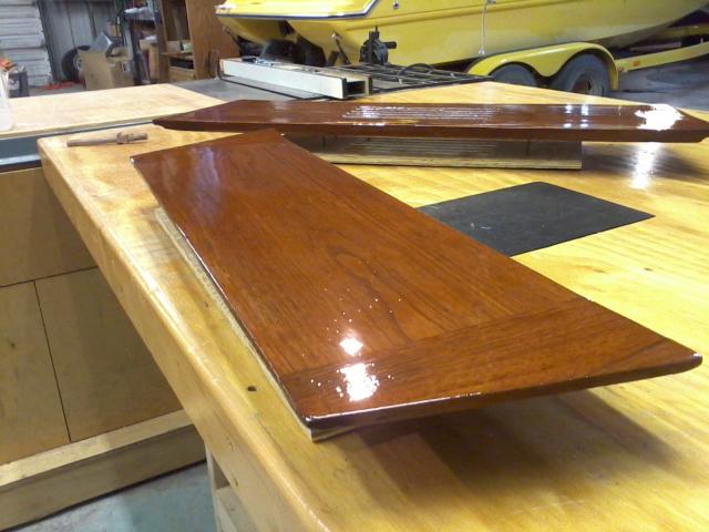

Attached are a few pics of the "mini-tiller" I made from the tired old tiller from the boat. The boat came with both a brand-new laminated tiller and the tired old one. I wanted to have a small tiller handle for light wind days, for days when I am using the tiller pilot a large amount, or for days when we are entertaining a larger number of poeple in the cockpit. A big long tiller whacking unsuspecting guests aboard is often not fun.
Also, coat 4 on the companionway hatch boards. You see a little dust in there, but I have one more build coat, (coat 5) after which I will do one more knock-down 320 grit sanding. Then I will move to a properly set up clean room for the final coat, with hopefully no junk to mar the oterwise glass-smooth finsh.

Quick photo-render of a white formica base vs. serious try at a faux-finish base that appears like wood.
I know it will be work, but the white base does not look "Catalina" to me.
I will try to see if I Can stain and fool teh base into looking like wood. If not, I am going to go get the proper lumber and re-build the base to have a nice properly stained wood finish. White doesn't cut it.... I think readers here will agree.

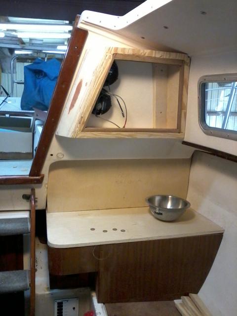

Phil, nice work. I mighta missed it - what's to the box above going to hold?
Its primary function will be to hide the back of the depth finder and knot meter, (I plan a complementary one for the other side) although one might find it holding a few pieces of drink ware, and maybe some Pussers, or some Cruzan Black Strap Sailor's Rum, (my favorite rum)... :) It will be a good storage for ignition and locker keys too.
I am debating cabinet doors, or sliding smoked acrylic panels. Cabinet doors will be easier, but will need positive latching to prevent accidental opening. The sliding smoked acrylic is more in line with the original design intent from the factory, and looks good in my renders. Your thoughts?

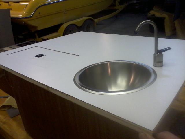

Monday morning update:

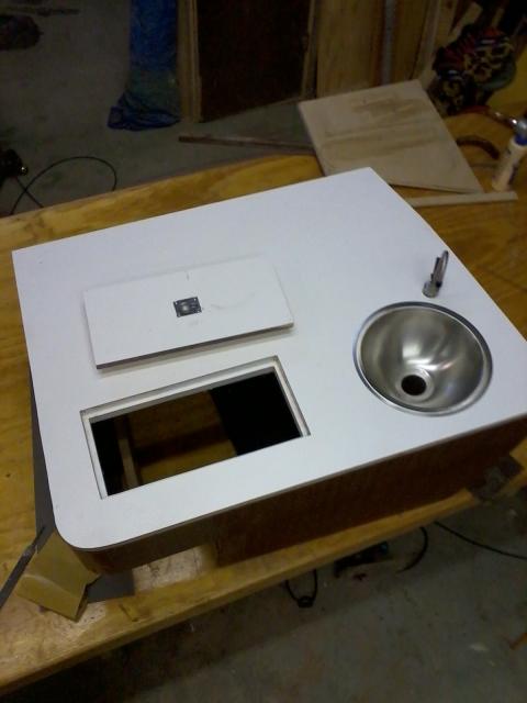

Got the upper cabinet from rough prototype for fitment to a closed carcas ready for smoothing and veneering. Teak veneer is on the way to cover it. I went ahead and milled slots for sliding smoked acrylic. A little filler and a skim coat is all that is neded to have this piece prepped for veneering. I rounded the corner of the upper cabinet to mimic the radius corner of the cabinet below. Visually, I think it is right, and from a safety perspective, not having that sharp edge should prevent some vertical bruise lines on noggins... :D It will also revent damage to the veneer in my opinion; a sharp edge would be easy to crush and dent.

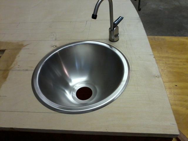

I also am happy enough with the fit of the shrunken galley, so I removed it from the boat and laid out and cut the sink hole, drilled the water faucet mounting, and framed out the icebox lid and mounting system. The underside of the countertop has a layer of West Systems on it for moisture resistance, and the ice box lid will get two coats on the underneath side, followed by a white coat of gel coat. The countertop and icebox lid will be white Formica.
I am going to thermoform a new icebox liner from ABS. Tonight I wil be heading to the home improvement store for some MDF. I will build the male blank, allowing room for some foam insulation on the exterior, and then take it to a thermoforming machine, either here at work or at a buddies.

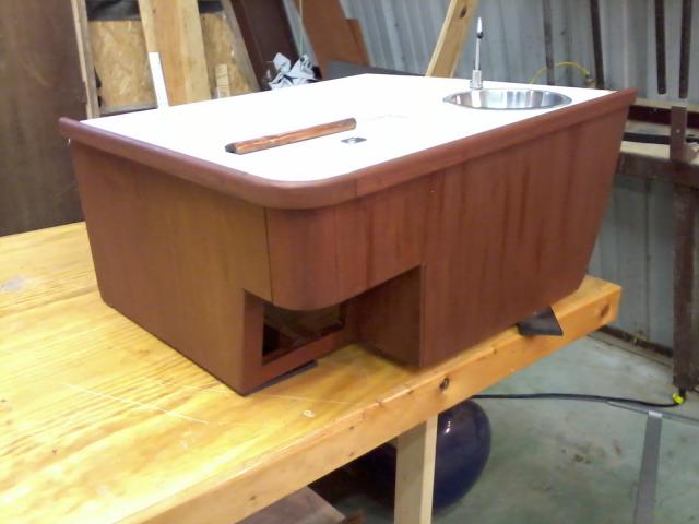

Got the Formica on the wet bar and ice box lid last night. The Ice box lis is slightly recessed, as you can see at the moment. There will be a thin gasket that brings it up flush with the countertop on final assembly. The rough looking edges around the flush ring are actually just spots of contact cement. When cleaned, I will put a VERY THIN bead of 3M4000 or similar, but the seam between the flush ring and the formica is pretty straight and uniform. Theflush ring is recessed so its flange and the surface of the lid's Formica are the same height.
I also finished rough shaping for the replacement fiddle rail. 'Looks like I am going to re-use the stock radius corner from the original galley countertop, but replace the straight sections with all new material... The replacement fiddle material came out of a 1963 Chris Craft Cavalier I took apart several years ago. The hull had bad rot but the structural timbers were good. I have used a lot of that old boat on various other boats over the years. It is what Chris Craft called "Phillipine Mahogany" and not the real stuff, but it stains up pretty close to teak, so with a little craftiness, there should be no visible difference on the fiddle rail.

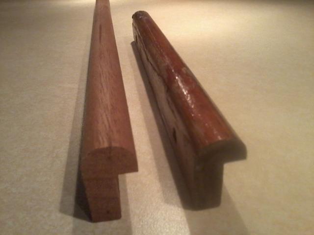

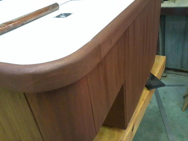

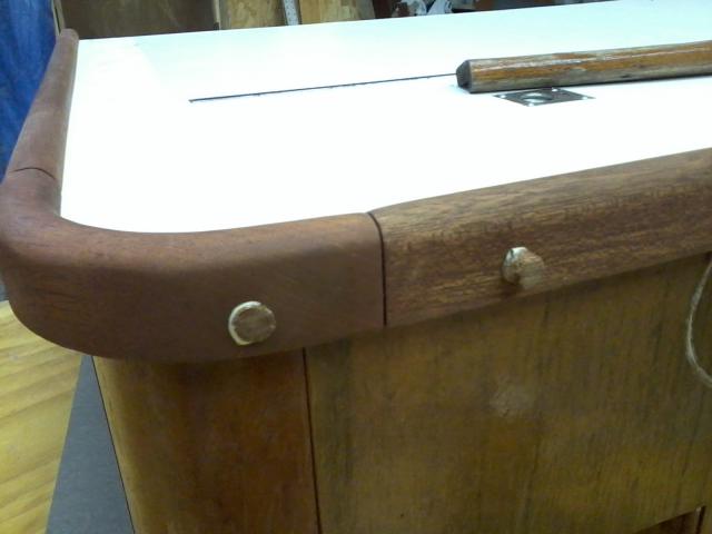

Fiddle Rails Installed
Got busy with a little glue and a plug cutter last night. I trimmed the donor mahogany fiddles I milled and installed them with the stock corner fiddle piece, then plugged.
After dinner I trimmed the plugs and gave the whole thing a second coat of filler stain.
Cosmetically, the cabinet base was in pretty bad shape. The old fake wood veneer is faded badly, and has some battle scars, but darn it, the stuff actually takes stain! there was a little bit of faux finishing technique involved in levelling out the color, but I thought I would try. Before I go to the pain of veneering I am going to hit this with a few coats of varnish and see how it looks. My honest opinion is that it will pass inspection, and after 4 or 5 coats, will pass inspection even up close! I have two cans of varnish, and one is tinted with a little stain, so I can use the tinted varnish to further even out the color if I choose, or decide I need to.
Progress. Slow, but steady.... I have 'til March, right? :D

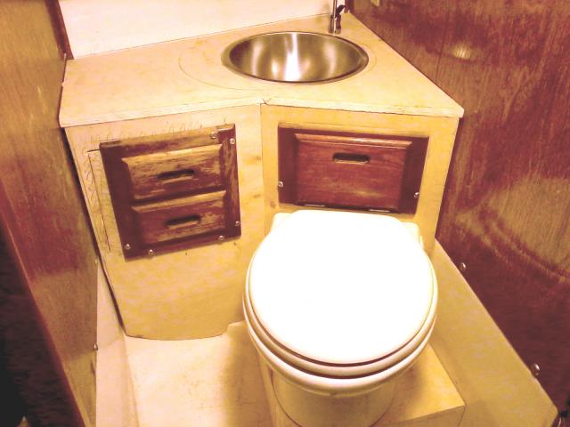

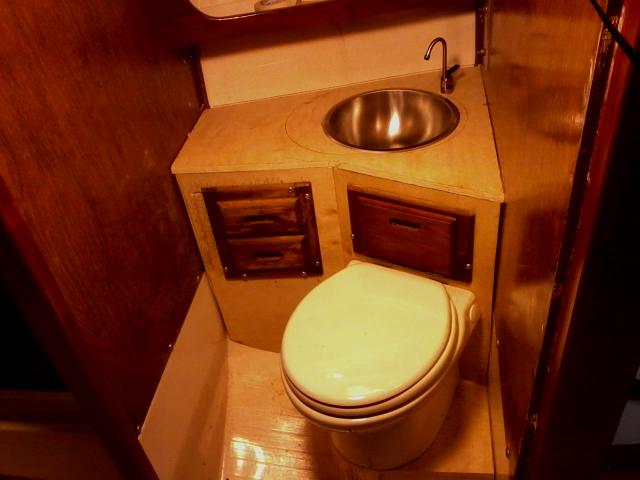

Did a little work on the head remodel Saturday.... The cabinet front boards are a little loose and do not fit tightly to the bulkheads. Now that I finally have the geometry to get the left cabinet face to fit at the bottom I can pattern up a new left panel and get it tight to the forward bulkhead. I can also center up the drawers... I put them hard to the left to clear the head seat, but after trimming for length to get them to fit into the cabinet they are not long enough to hit the bowl.
I also re-installed the wet bar just briefly to see how it looked in place. This is faux stain finish with two coats of varnish. It has been curing up a week or so, and it can be block-sanded for a final varnish coat after block sanding, I think. I went ahead and ran the fiddle rail all the way aft on the counter edge next to the companionway, so I will either need to notch the fiddle, or releive the divider wall that will set down on top of it in order to alow the galley to slide in and out for maintenance and service.

Phil, nice work, as always.
What is just aft of the new galley?
If I understand you correctly, there will be a vertical wall divider just aft of the galley/wet-bar that separates the galley from the port quarter storage area. My original intent was for the TV to be mounted just above the galley on a standoff attached to the vertical wall, (as shown in rendered pics) but I am questioning that just now. It is a best location for seated enjoyment of the TV, but it is not as dry an area as can be found in other parts of the boat, such as the starboard bulkhead forward of the dinette by the compression post. Additionally, the Antenna wiring is more easily routed to points amidships, as the antenna wire will be coming down the inside of the mast.
BTW, the drawers and doors you see in the head are from a Newport 27 I recently bought for parts. The Newport is toast, the hull full of water, stained, blistered and badly oil-canned from the weight of the water in her, but the A4 is out of the boat, as was all of the interior wood, as they were removed prior to someone starting an interior refinish never completed... I will have some goodies to sell, including a mast and a bunch of lead..... :D
NO, there will be no marshmallows being cooked during that fire.... That is unless someone wants a gutted hull of an old boat for a yard ornament... In which case there will be no fire...

Last night I got the sink cut out, the drawers centered back up on the left panel, and tied everything together. It is tied to the sole through the toilet base, and it is tied to both bulkheads with some screws driven through from the outsides, capped with stainless finish washers.The toilet pulls out as a unit, and then the counter comes out as a unit. Then the toilet base comes out as well. It will take me about 5 minutes to pop everything back out...
The next step is to remove it all, re-finish the drawers insert and the door insert, and coat all of the birch plywood interior surfaces in a layer of West Systems epoxy.
Then the toilet base, the counter face, and the countertop all get a coating of white Formica. I made fiddle railing last night from some more of that old Chris Craft wood to match the galley/wetbar fiddle rails.
I am looking at either removing the bulkheads and surfacing them in white Formica, or I might consider sanding them, and then hitting them with a coat if Kilz, followed by some Petit yacht white interior semi gloss, ( I have a lot). Thoughts guys? Either seems to entail about the same amount of effort. The pro to painting is the non-removal of the bulkhead, and huffing it down the ladder. the pro to using the Formica will be the very durable uniform finish throughout.
Finally, once it is all back together, I wil be installing some short splash rails along the sides and back of the finished counter top, and a couple of molding pieces to trim out the counter face to the bulkheads. Again, a questsion, white Formica or varnished wood? I guess I can draw it up and review, but would appreciate honest comments as to preference and why.
