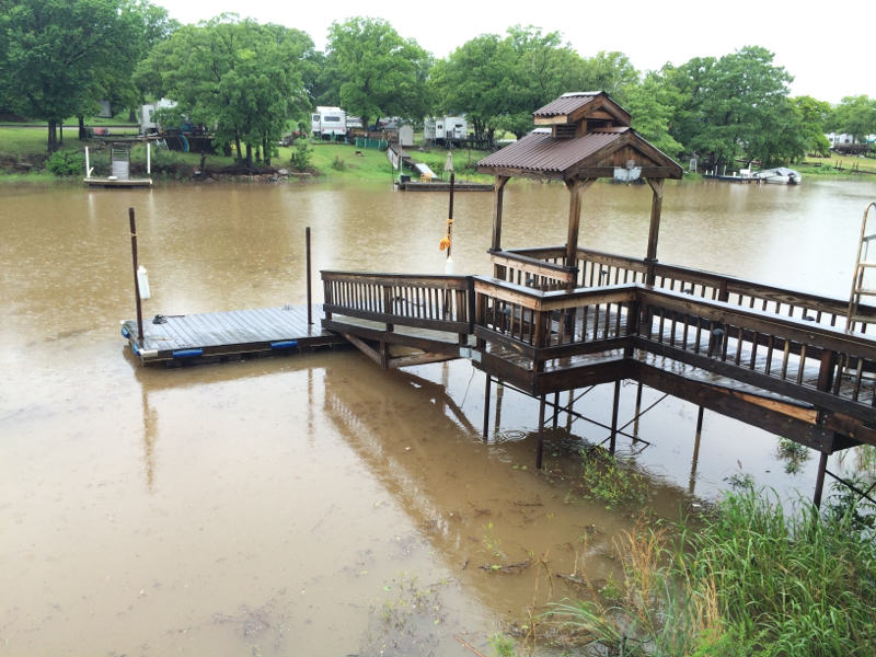

We have not gotten the rain southern Oklahoma has gotten but we're getting rain. 2.5" yesterday. 20" lake level rise in under 24 hours. We're only 18" below spillway at this typing and it's raining. Here's a pic of the dock just now

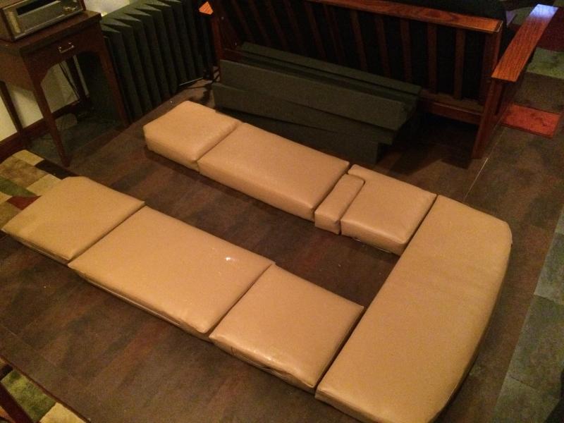

So, flipping through my thread, I realized that the cockpit upholstery that was sitting in the cockpit getting all dusty was started back in 2012.... I stitched it up over TWO years ago... I felt horrible thinking aout it sitting up there exposed to the indoor shop elements of sawdust, dust in general, potentially bird poop and (Heaven forbid) the ravages of any foolhardy mice.
So I convinced myself to buck the seats down out of the boat to give them a good thorough cleaning, also to store them away in a more climate-controlled location.
Here are a couple of pics of the newly cleaned cockpit upholstery sitting in my office. I will stack these by size and store them away in some trash bags soon.
The nice thing is, they are out of the way, and now I am free to get back to work on finishing up the boat. I need to clean and polish the cockpit, and then re-paint the non-skid with the Kiwi-Grip I have left. Hopefully it is still liquid! :)

It is worth explaining the smaller pieces... The sizing is not only convenient, it was chosen to correspond to the lazarette hatches... You can get in either laz without moving a cushion out of the way. Then that small little filler piece? Odd huh? That is the removable piece that allows the tiller pilot to be used without removing any other of the cockpit cushions.
I did a similar thing in the quarter berth area under the starboard cockpit seats. The thru-hull for the motor's raw water intake is under a deck plate back in the quarter berth. Rather than bucking some huge hunk of upholstery out of the way to open and close the seacock, you just pop the little piece of upholstery out and then you have easy access to the seacock. Makes you way more willing to open and close it....

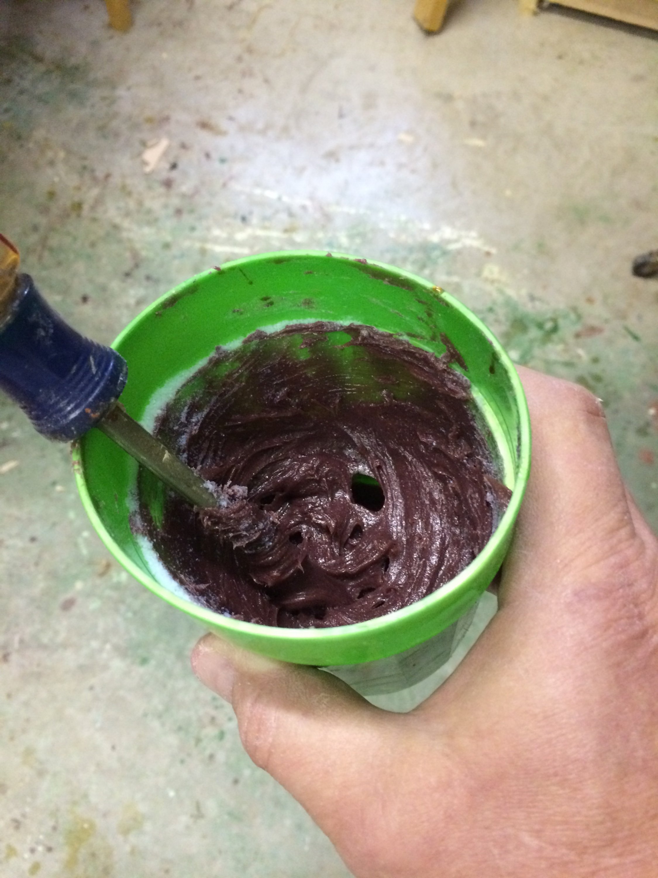

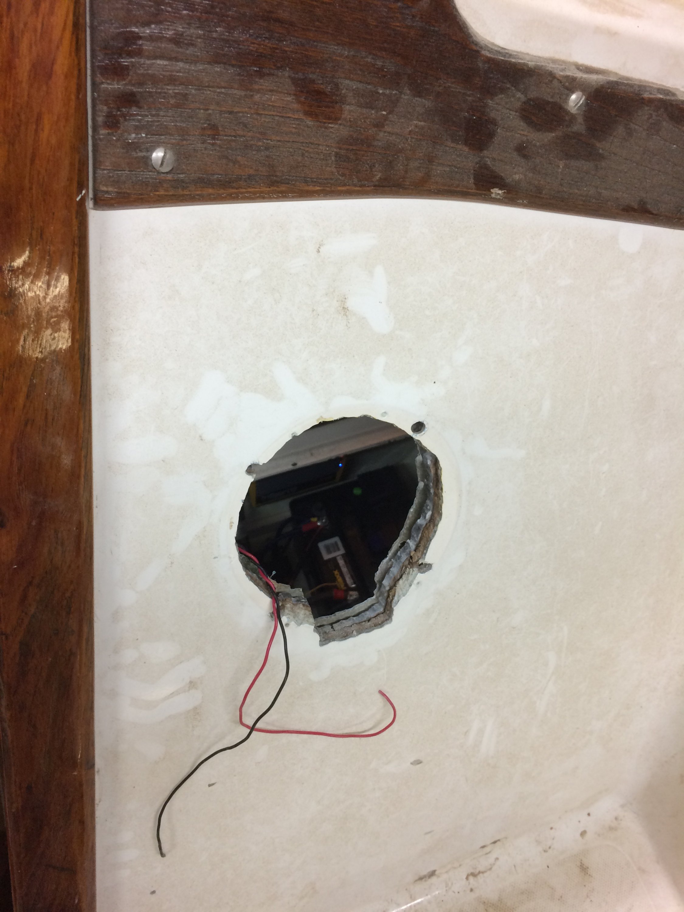

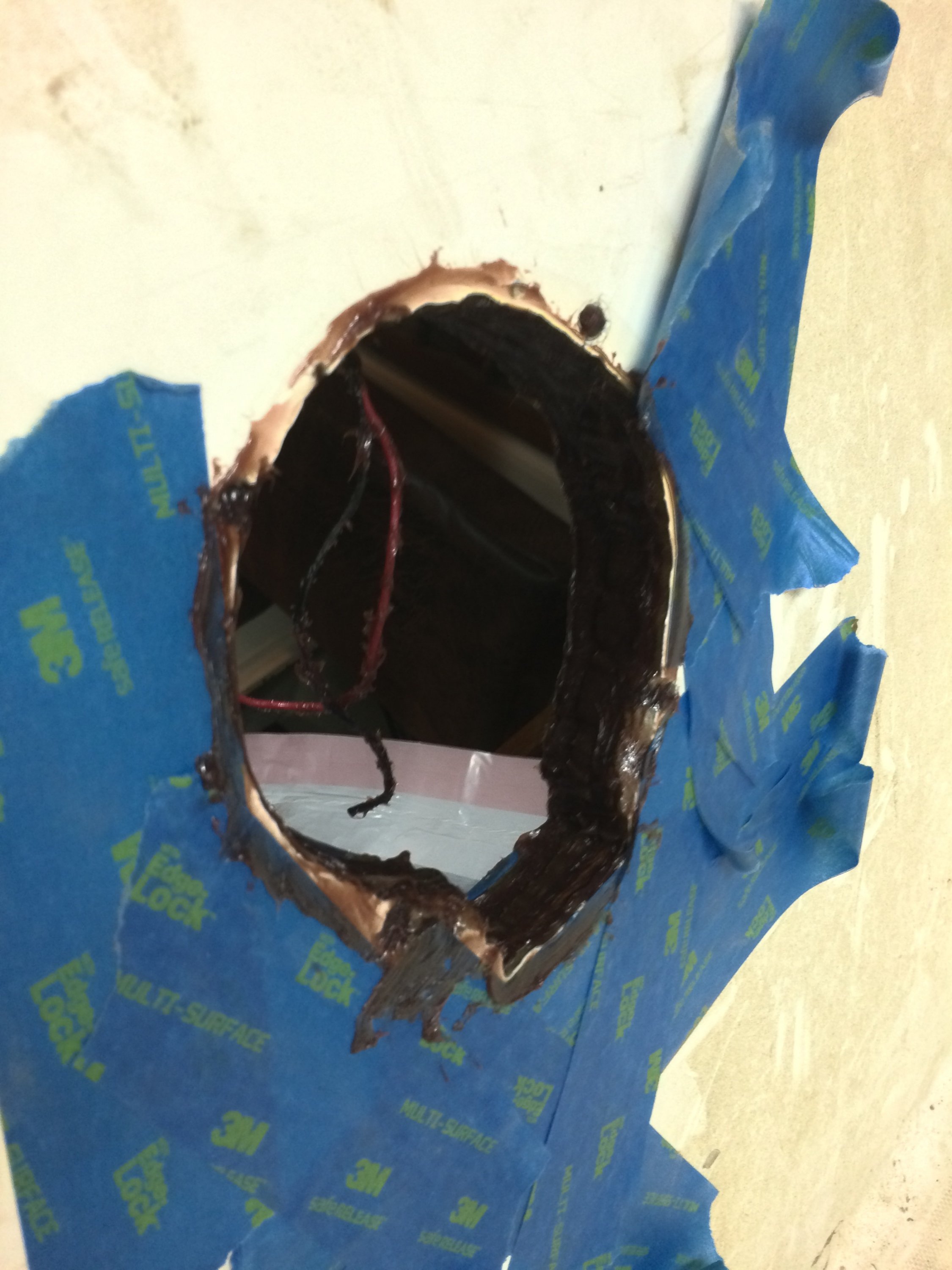

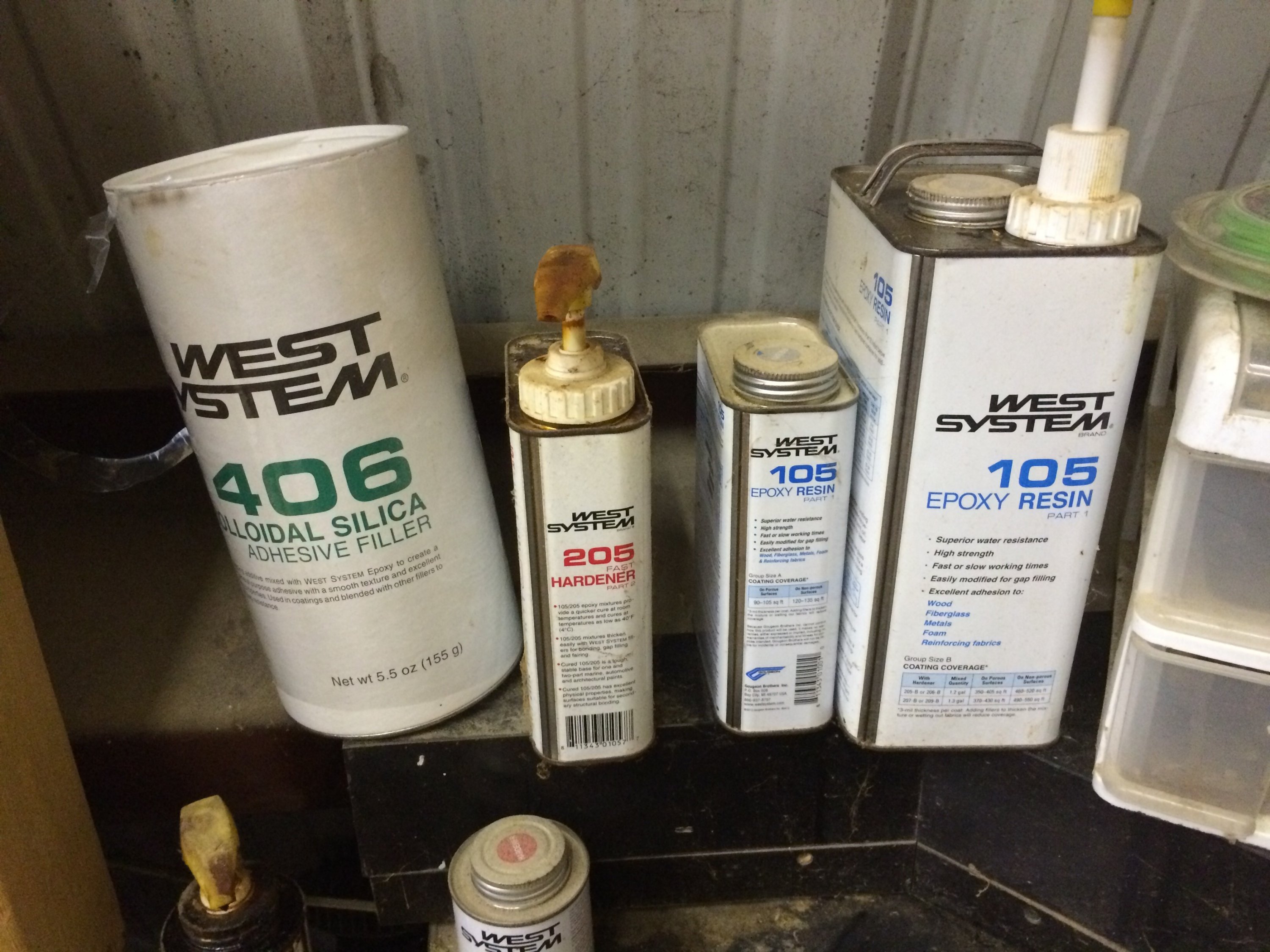

Tonight I got a chance to work on my boat again. Work tonight involved vacuuming debris from between deck mold and inner roof liner where compass mounts. I then fired up a peanut butter-thick batch of West Systems products and packed the voids. There will be some filing and cleanup but I will have a solid area in that bulkhead so the fastening screws of the compass can compress sealant, be it foam or butyl.
Now let's see if I can upload a new pic in this new forum.
