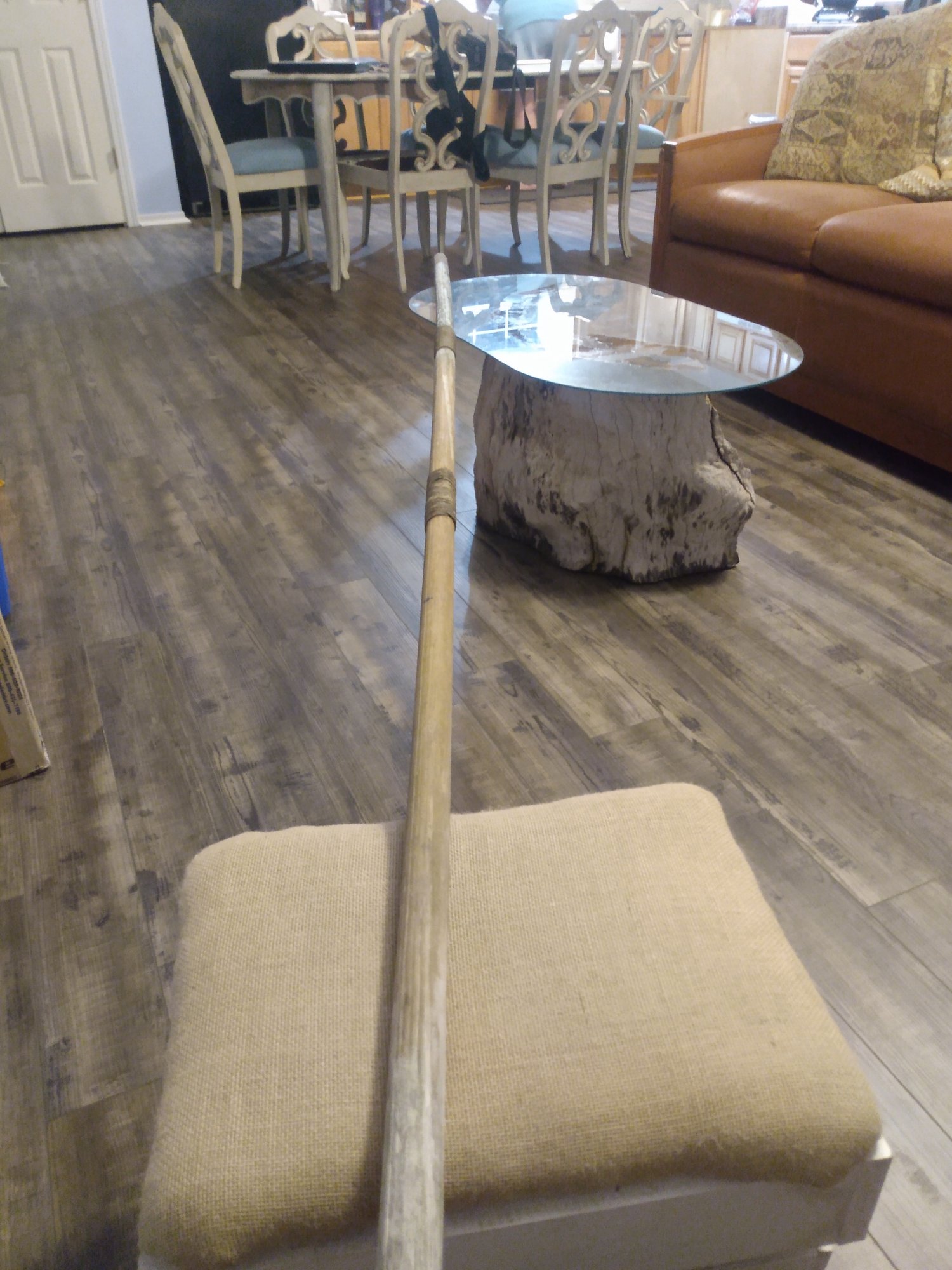

The great redneck boat hook!!!

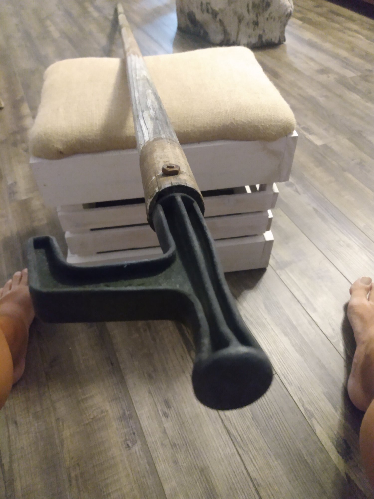

It has been out in the elements for the last 18 months so it needed some work to return it to its original configuration. Closet Rod with the end drilled out to accept the boat hook.

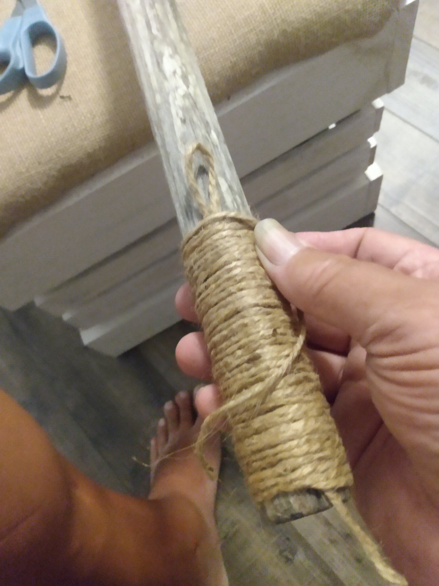

Here, you can see the three handholds made with binders twine (garden twine).

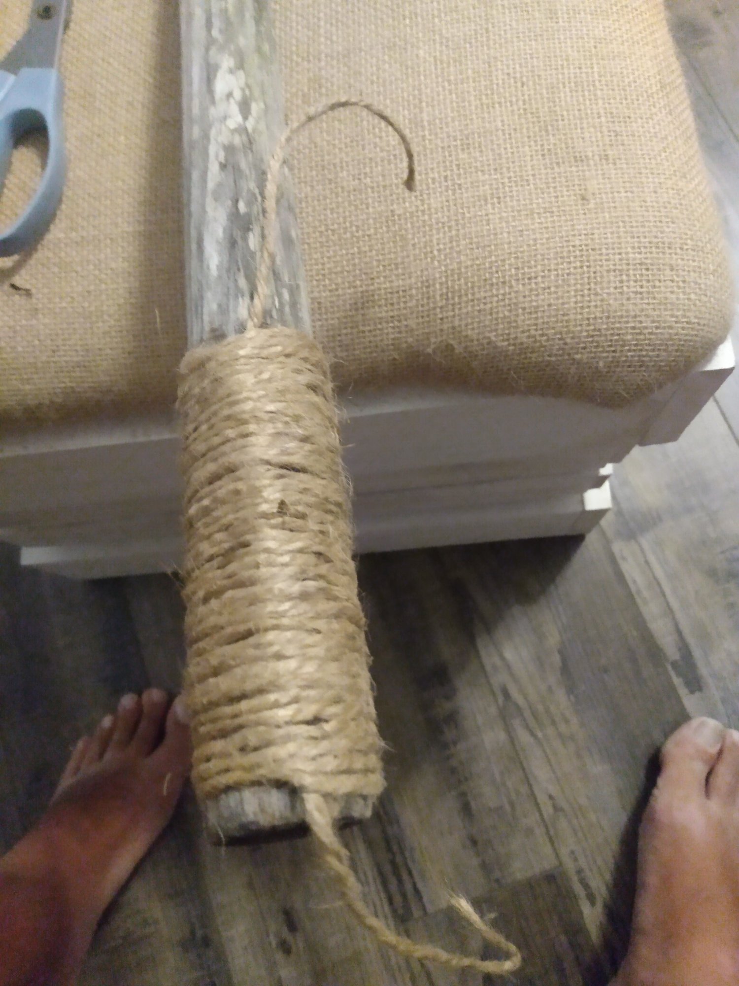

I first laid a loop on the rod and then wrapped the loop to create the handhold. Then I stuck the loose end through the loop.
Pull on the loose end of the loop to bury both ends and trim off the excess. I used several layers of varnish to seal the twine so it would last longer in the weather.

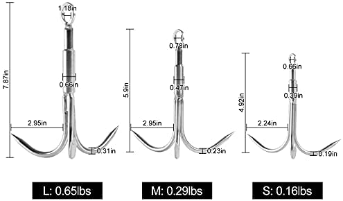

In addition to the two boat hooks I have, I'd really like to have a grapple - not too big, but one that I can use to snag lines and other things in the water as the need or want arises. I have only seen ones that are bigger than what I'd want to keep on board. Any ideas?

Thanks, that looks good. One would have to be careful tossing one of those from a sailboat, with all the lines, rigging, bimini and dodger framework, etc.!

Watch Deadliest Catch for the proper way of throwing these things. Most of them use an overhand "no swing" technique that requires very little room.

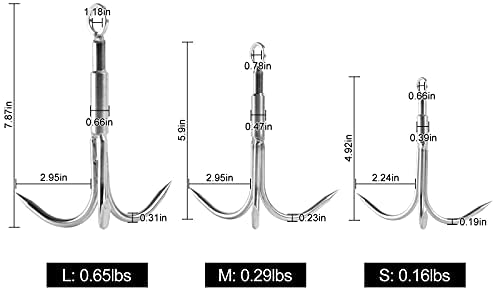

Those are interesting. Very inexpensive! I'm guessing they are likely made from probably a 420 type martensitic stainless steel. The Amazon site says:
Handmade stainless steel claws with Germany professional cutting tools stainless steel, oil quenching after high temperature heat treatment, strong and hard enough for daily outdoor use.
Germany likes those alloys. They will be quite strong, but not very corrosion resistant. But hey, for the price - you could buy 10 of them...hahhahahaa
