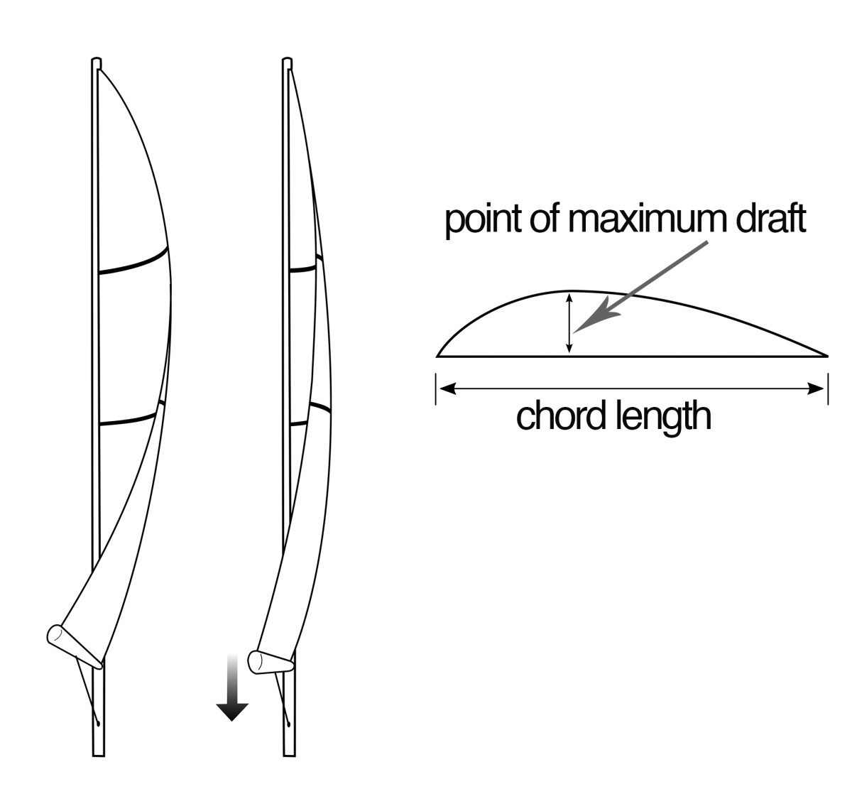

Hmmm.... I'll have to think on that. I agree that the vang is most important when the traveler block is at the end of the track but when I am on a run, I don't think of the vang as inducing any twist in the top of my sail (why would I want to do that ???) but rather it holds my boom down and keeps it from riding up.
That’s correct - on a run the vang prevents the sail from twisting forward too much. The “riding up” you mention is just the visible effect of that twist on the height of the boom.

A vang controls twist by reducing it. Off the wind, the boom's natural tendency is to rise allowing the top of the sail to twist off and depower. The stronger the wind, the more twist that is induced. The vang (all vangs regardless of rigid or soft) applies downward pressure on the boom which flattens the sail and reduces twist.
When running down wind and approaching a broach, releasing the vang will immediately depower the main and help to get the boat get its footing.

I have seen what you are describing... and I suppose it is just like twist but in an exagerated way. I guess I never thought of the boom riding up as "twisting" the sail. When sitting in the cockpit on a run, you are not looking down the leach so to my eye a rising boom acts to induce a crease about half-way up the sail that dumps most of the wind.... and you are correct, it will depower the sail. I suppose if you were looking down the leach, it would look just like twist.

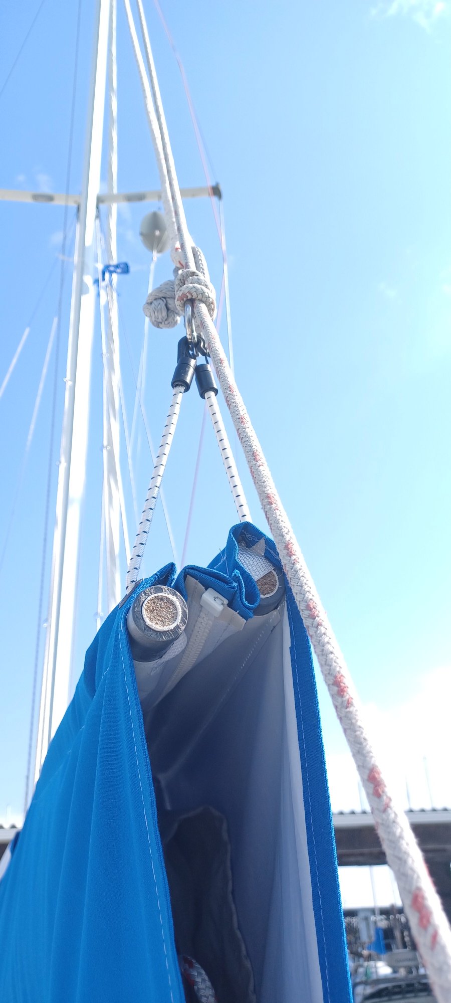

On my boat, I use a ring in my topping lift to hold up the aft end of my sail-pak. Question for those of you who have a rigid vang and not topping lift with a main sail pack. How do you support the aft end of the pack?
