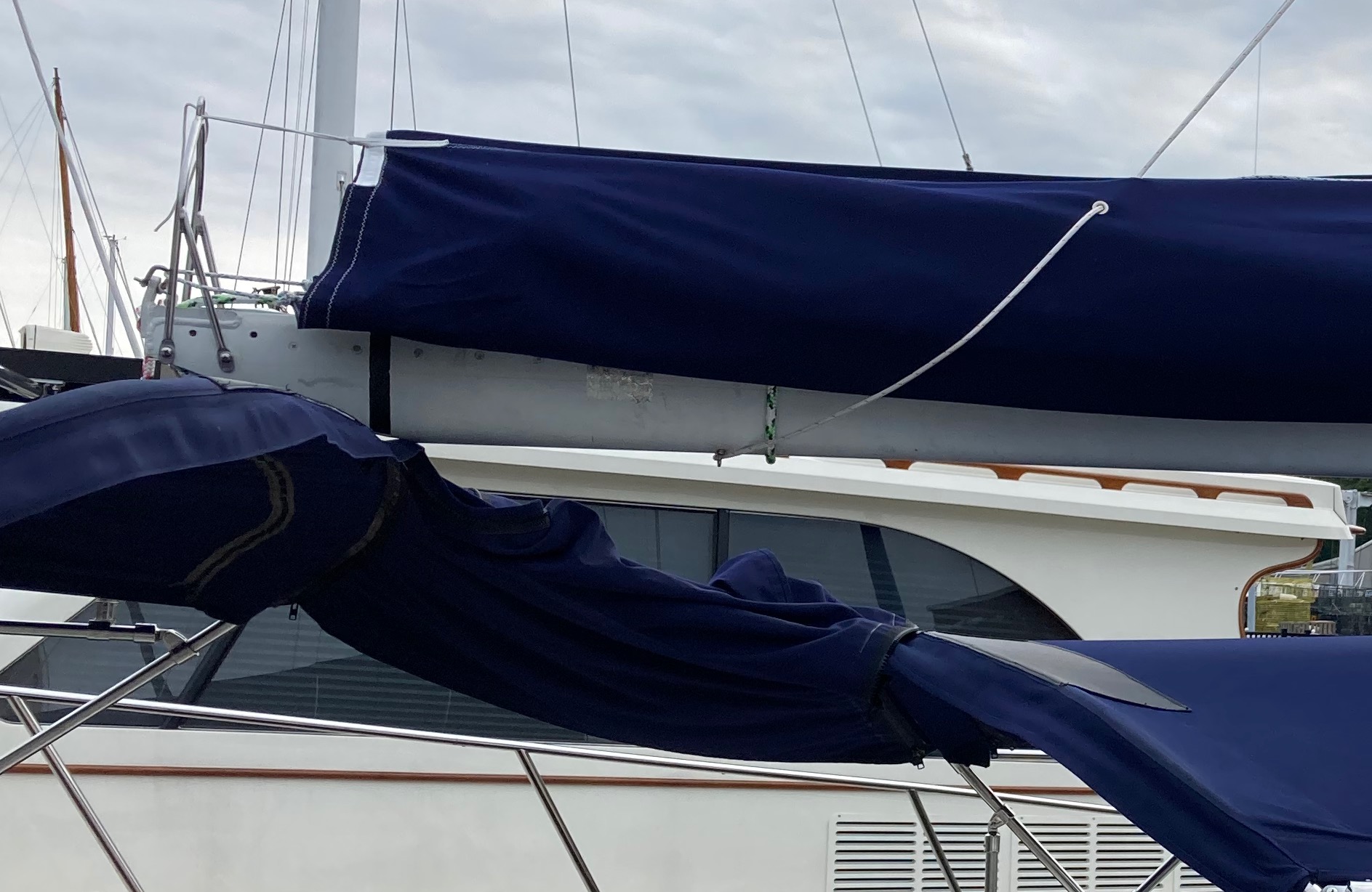

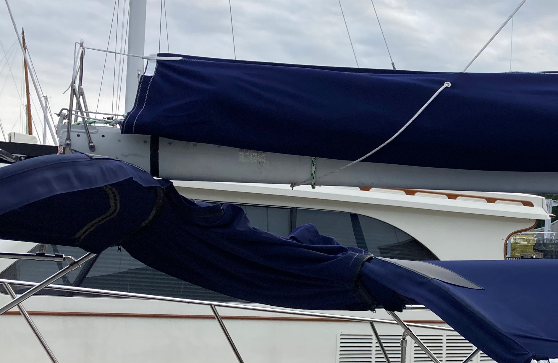

This is just not correct for a properly built sail. A properly installed reef point has a reinforced clew and tack and a reinforcements along the reef line. If for some reason the clew let go, a poorly tied knot or fabric failure there would be no pressure on the reefing line as the clew would just fall off to leeward. If he tack let go, there would be pressure on the diagonal from the next higher sail slug back to the clew. Of the two, the tack is more likely let go than the clew because of the design of reef hooks. Once there is sufficient vertical tension the tack should stay in place.
If the tack or clew should fail due to fabric failure or construction failure, there are bigger problems than too much pressure on the unreinforced parts of the sail. If your sail does not have reinforced reef points, then you have a poorly made sail.
One real caution is tying in the reef so that the sail does not have a belly to catch water. Rain and spray can collect in the belly adding unnecessary weight on the sail and it will shower the crew on a tack.
The attached photo shows the reef points on a reinforced strip and well reinforced tacks and clews.

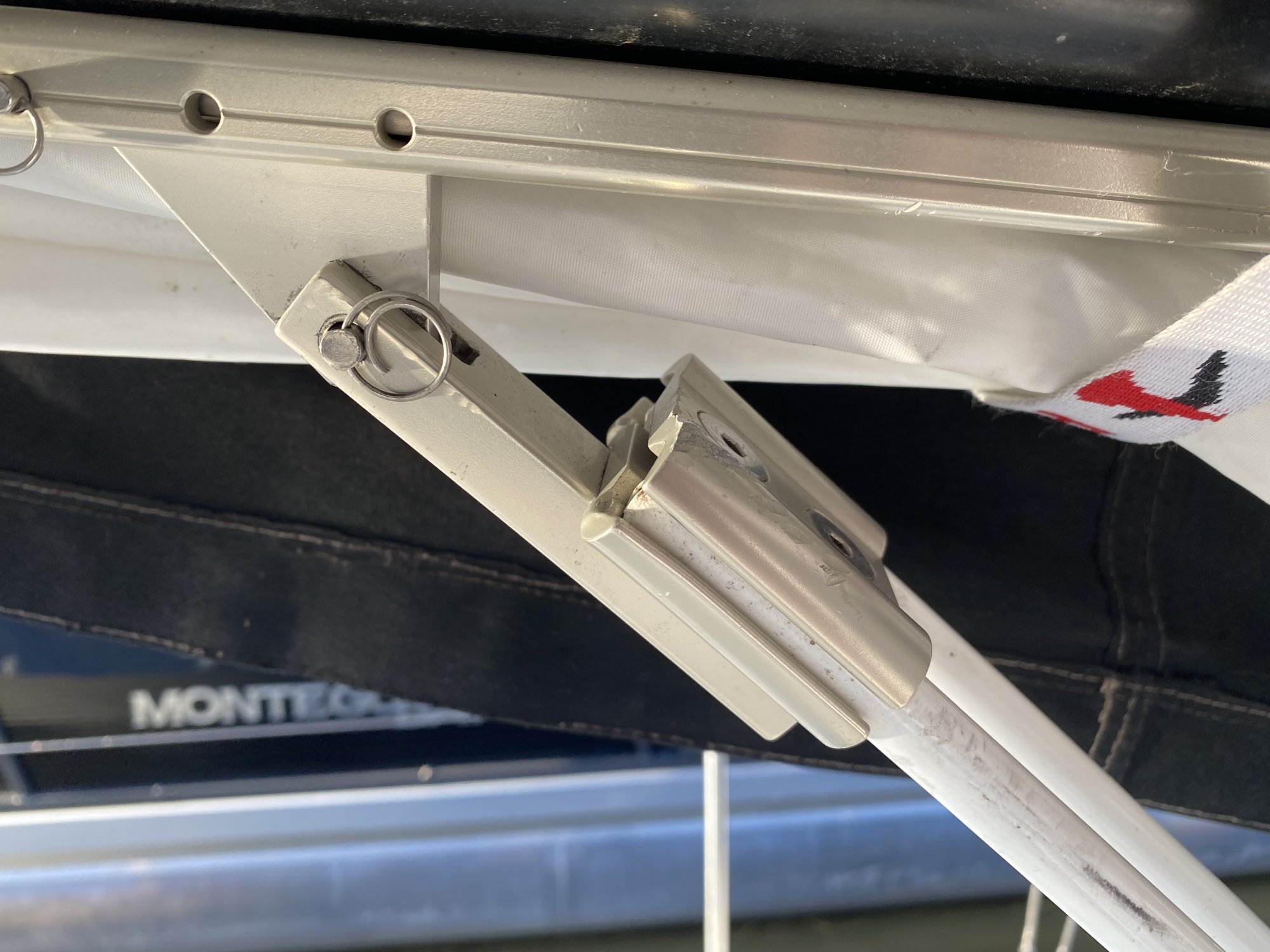

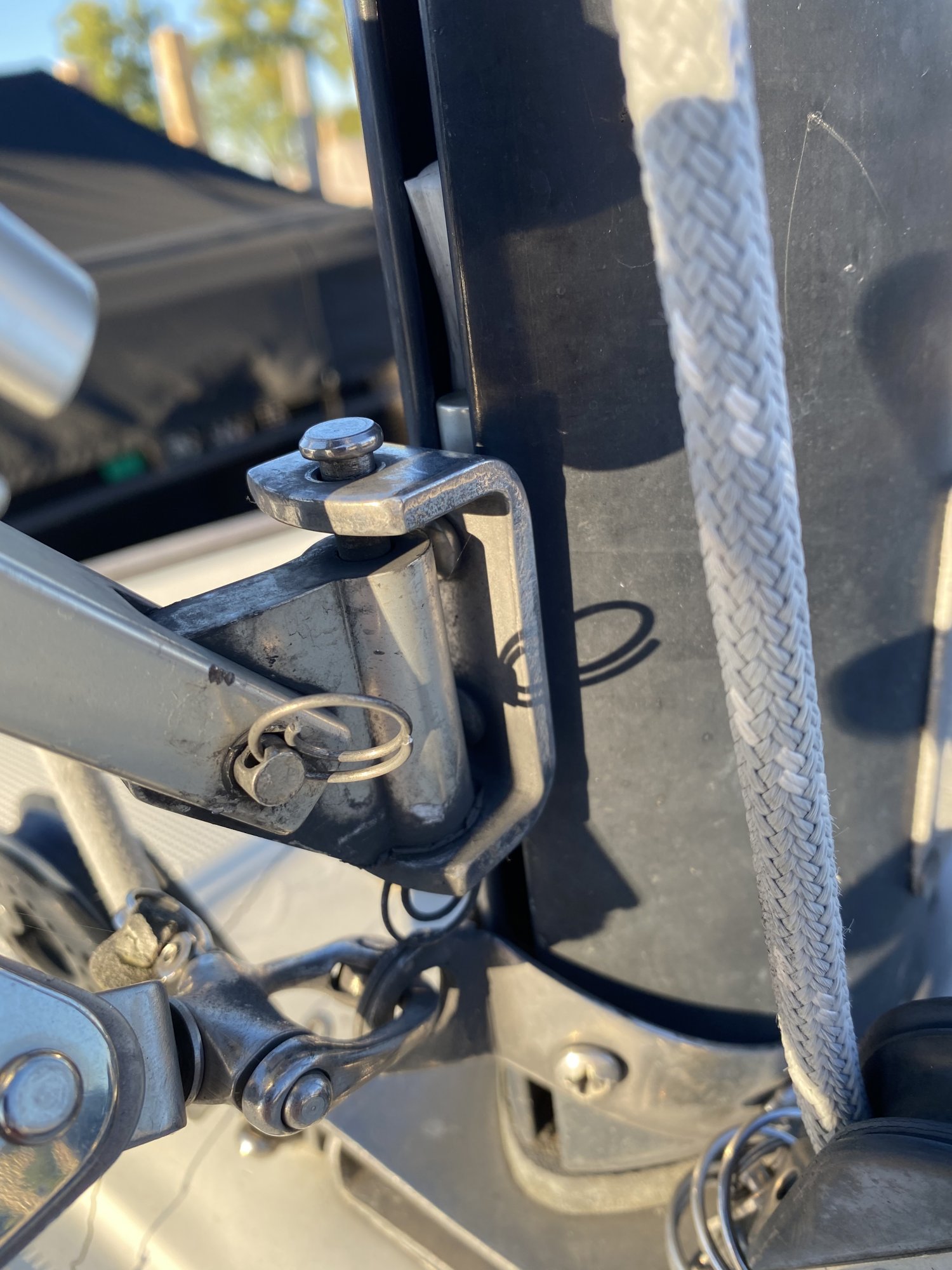

This thread is getting interesting, I’m learning a lot, but what I really want to know is how simple is it to add a topping lift versus adding a boom kicker?
It took me 45min to install a boomkicker on my boat. The mast side of the kicker has a slide bracket that drops down the track, then the lower end of the kicker attaches to it with a pin. Two holes drilled and tapped in the boom for the bracket. It is very simple and holds the mast up when I have the sail down. I also have a vang to adjust the twist in the sail. I can get you pics if you want when I go out to the boat tonight.
