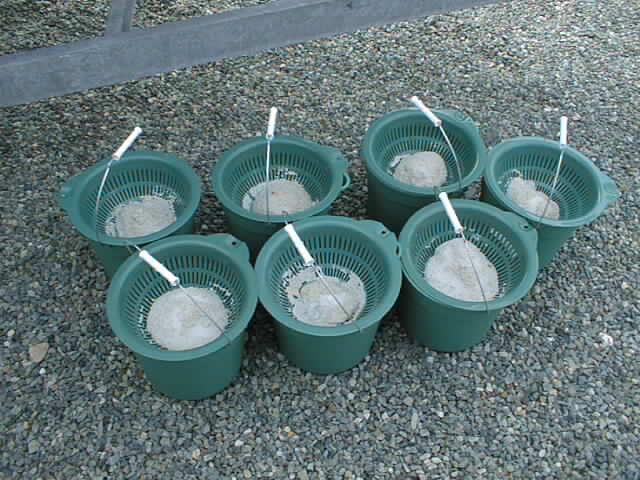

I place 7 pails of calcium chloride around the cabins to absorb water and keep the humidity low. Never had a problem with mold on the cushions in 8 years of this storage method.The pails of calcium chloride are set up as follows: Buy plastic pails and colanders at the dollar store. Put a colander in the top of each pail and place several scoops of calcium chloride in the colander. The calcium chloride will absorb the moisture and then it will drip into the bucket. My 7 buckets collect 2 full buckets of water over the winter and spring. Most of the water appears in the spring.The calcium chloride can be purchased at any garden supply store and it is the same stuff in the "damp-rid" pre-loaded buckets that you can buy at the boat stores for 10x more $$.
Be sure to wet-vac all the water that is standing in the bilge. A large volume of water will over-whelm the buckets of calcium chloride.
