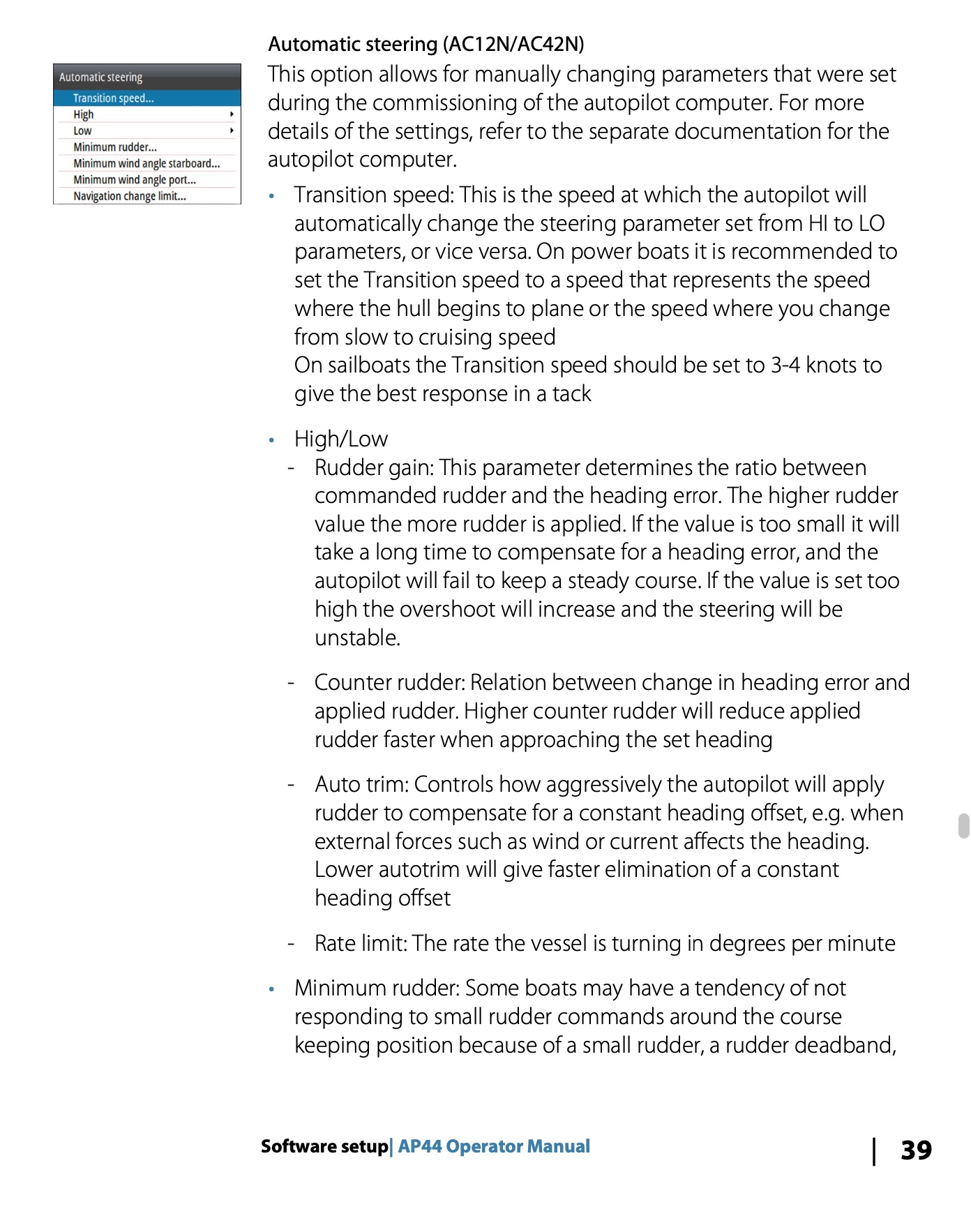

I think you're mistaken, I downloaded it, and there's just about nothing in there about setting up the autopilot. On the other hand, the Zeus2 MFD manual has a lot of info.
I don't think the "smarts" are in the control heads or MFDs, I suspect the capabilities are in the autopilot computer, and the MFDs or control heads (like the AP24) just access the parameters.
That's odd. My AP44 manual has this information for the AC42.

By the way, the documentation for these things is poor, confusing, and incomplete! They don't break down the system and say what's happening where. Some display or control head manuals don't even say what computer they are programming! Terminology is inconsistent not only across the industry but even within the same brand. I'm going to try to put together my own documentation based on the collection of manuals from Simrad/B&G.
I believe at one point Simrad acquired Robertson, who had a good reputation for autopilots. I'm sure their technology is still represented in the Simrad/B&G stuff.
I agree that B&G documentation is atrocious, but it isn't much better across the other manufacturers. Somewhere buried deep in the B&G website are some videos or technical papers about setting up B&G AP's. I think it is for the H5000 system, but almost all of the information translates directly to all of their pilots.
While many have the good impression of the Robertson heritage, I doubt much if any of it remains in the current products simply due to technological age (it's been 30yrs). B&G were similarly well-thought when they were a separate company, and it is more likely these products represent an evolution of their technology.

Just the one on Navico's website: https://softwaredownloads.navico.com/Simrad/SimradYachting_Software - Copy/Downloads/documents/AP44_OM_EN_988-11189-003_w.pdf
I see now that my copy must be an older one because the current one has that information on page 41 instead of 39.
Marki
Thank you! One thing that infuriates me, as an engineer, is that they are inconsistent and imprecise identifying the version of the manual and the version of the software. The only real version info of the pdf I can find is in the file name. And, it appears that the one I had, with nary a mention but one of the AC42 autopilot computer, is a later version! Mine is:
AP44_OM_EN_988-11189-004_w.pdf
The one you supplied is:
Maybe we should seek out and archive the various versions of these books!
I've found and saved 002, 003, and 004 so far.

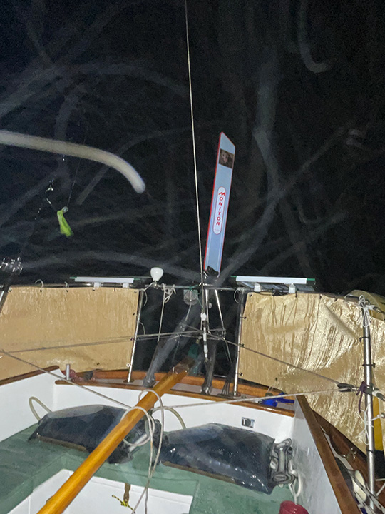

The whole point of an autopilot is to have a crew member aboard who works non-stop and does a great job, without complaining or consuming vital vittles. I've yet to have an autopilot show up for watch late, drunk, seasick or tired. I'm a firm believer that one autopilot is worth 2 experienced crew.
In the case of the OP's post, I believe a vane gear would be the solution to his problems, not an autopilot, if he wants it to hold course to the wind angle.
Yep...I would nominate my Monitor Windvane as the best autopilot. Trim your sails properly, set up the windvane relative to the wind direction, connect the control lines to your tiller or wheel properly, then kick back and relax. Dobby did more than 95% of the helm duty between San Francisco and Oahu. He never complained about any of the conditions.
