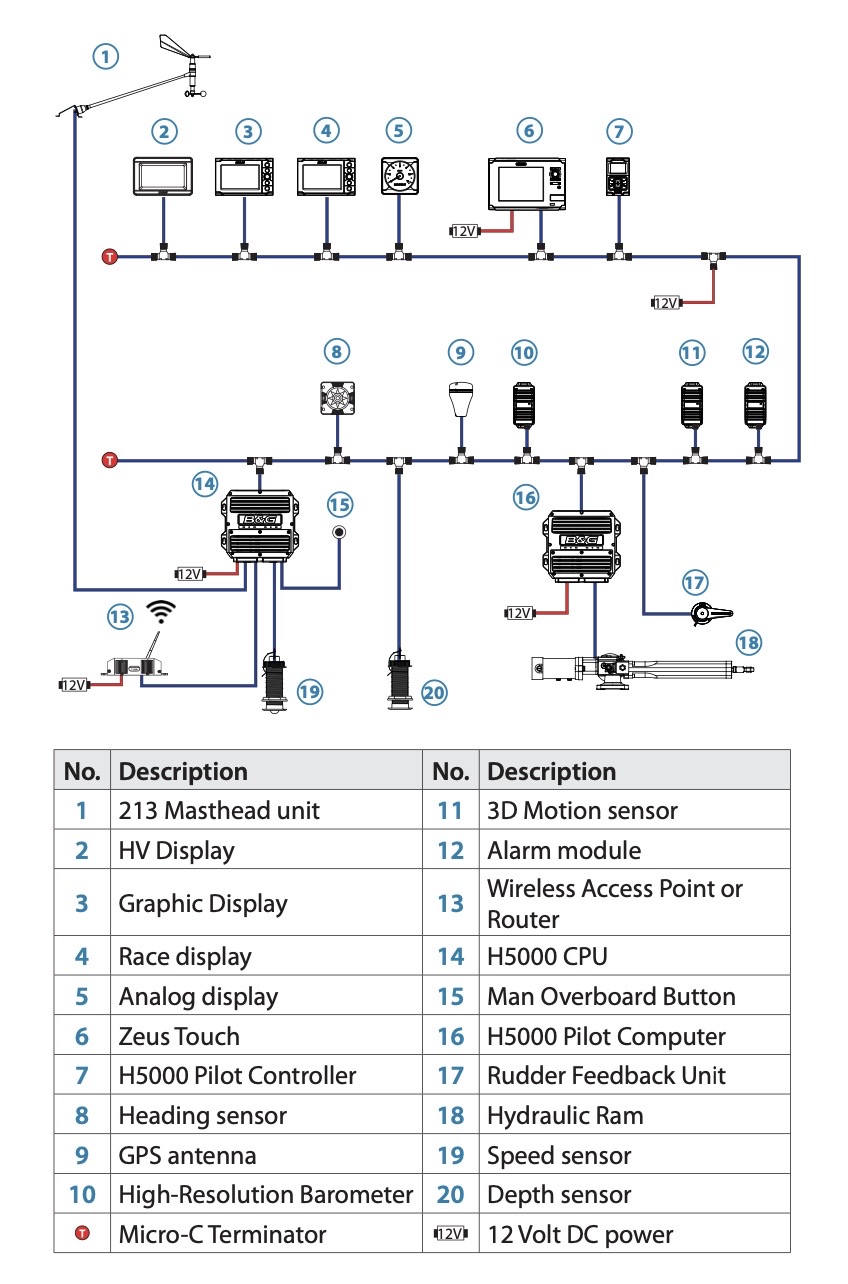

Here is the B&G Example of a H5000 system. I am sure you can cut and paste some of the units. But if you are talking a highly sensitive system.
H5000 system example
An example of a typical H5000 system. At the centre of the system is the Central Processor Unit (CPU). All sensor information is fed back to the CPU and can be easily controlled and configured via the Graphic Display or webserver.
