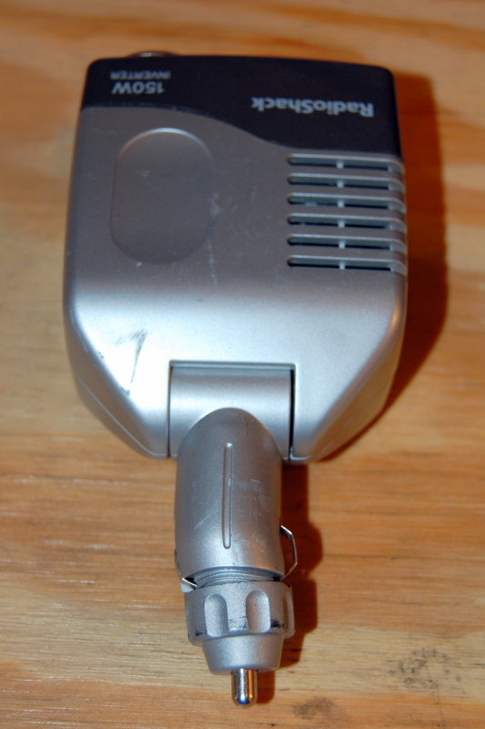

By all means do hardwire it. The ones with a 12V socket are flat out dangerous..
Even a 150W version can pull close to 15A, which is simply too much for a 12V socket..
I could smell this one melting when I walked onto this customers boat. It was pretty close to starting a fire...
The one I bought is a Go Power 150 W Pure Sine wave converter. A little more substantial than the RS POS.

I've had a 200 watt plug in for 20 years with no problems. In fact, I think a friend gave it to me because he bought a bigger one. I can't think of the brand but it has a wired plug.
I would not personally plug in any inverter with a cigarette lighter style plug on my own boat. Seen one too many dangerous situations I suppose...
The one above is not the only one we have seen melt down... Cut the tip and hard wire or get some Anderson Power pole plugs or similar. The 12V outlets are just not made for that kind of load, especially when corrosion sets in. At 200W you can be pulling as much as 19A through a cigarette style plug.
My guess is you are just lightly loading it but the risk still exists and the risk of a fire is certainly real. If you want to continue using it that way please fuse the outlet at about 7.5A or less, ideally I prefer to see them fused at no more than 5A.
