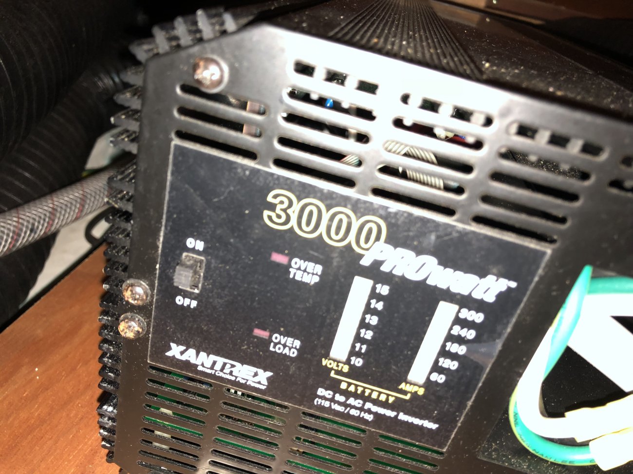

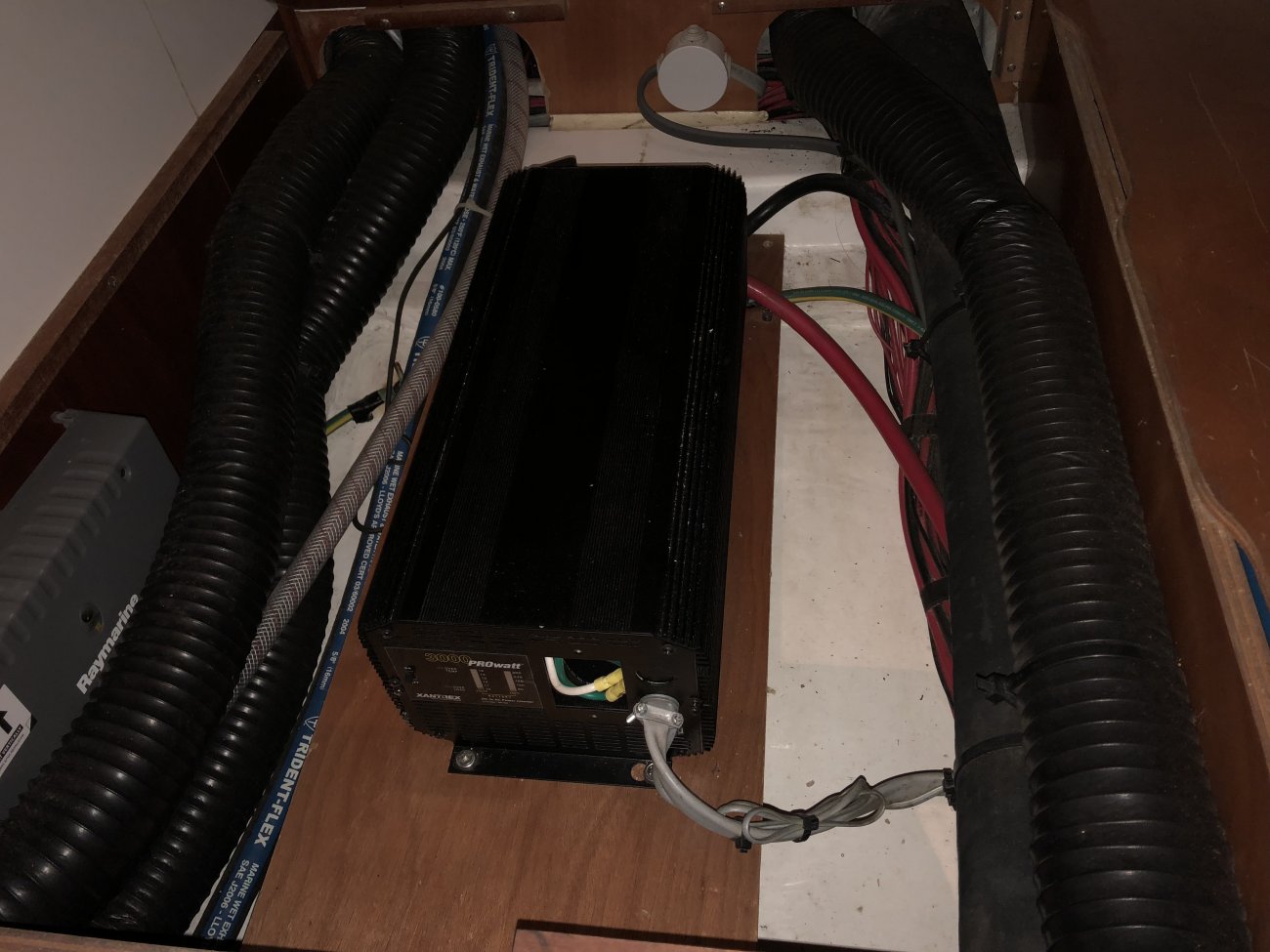

hello all I have a xantrex 3000 inverter on my boat that we never use that takes up a large amount of space.... have always charged phones, iPad and lap top using 12 v plug. We never use microwave, coffee made using stove and French press. Wife never uses hair dryer on boat. Am I missing some benefits?

The biggest problem with an inverter such as yours is how it was installed. It would require a transfer switch and correct neutral/ground bonding & un-bonding. I can tell by the image that the DC cabling is undersized so I would strongly question how safely this was installed. Most inverters of this type, that we see on boats, are incorrectly & unsafely installed.

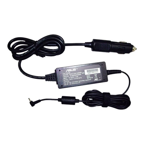

For Laptops we have 12 volt converters that plug into 12v sockets. They are more efficient than using inverters for the job. Guess it all depends on what you can live with and without. If we were full time liveaboards we might want more.

Laptop charging is the only item for which we now need AC power. So, I’m going to check out your item. Other chargeables use 12-volt plug & USB. Wife uses a 12-volt hair drier when away from shore power. Not real hot, but gets the job done well enough. Use the ice maker only at the dock. If it came to that (installing an inverter for cocktail ice), I’d rather switch to Pussers Rum out of the bottle, refrigerated ale/beer, and/or red wine, etc. (But, we do love or cocktails!)

Those 12-volt computer chargers look sweet - $25 on Amazon, and they come with multiple plugs to fit your computer. Looks much better than converting 12-volt DC to 120-V AC to 6-volt DC again.
